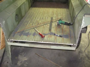

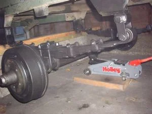

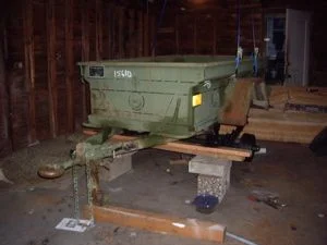

I picked up this trailer in abbortsford canada last january since im in college i didnt have much for tools or space to work on it so it sat for awhile. I was able to leaf of over axle and clean up the suspention while i was at it. this year im in a house with a garage and was able to bring my welder up from home to do what i want to do. Today i cut and started the tail gate for it. i plan for it to be as waterproof-dust proof as possible. My plans for this trailer will be to take all the camping gear off my truck and incorperate it into the trailer, when i want to go camping i can hook up the trailer and go and have everything with me.
Plans for this trailer include
locking tail gate
lift up metal top (with gas struts)
ezzi awn RTT on top of trailer
Matching wheels to the cruiser (eventually)
Full kitchen set up (this will include stove,sink, pantry, cabinet)
and more
I also plan to address the issues of locking the trailer and keeping it from being stolen when left at the camp sites.
This will be a slow build but im looking forward to it.

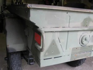

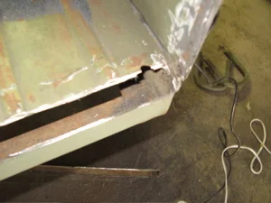

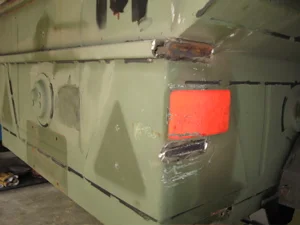

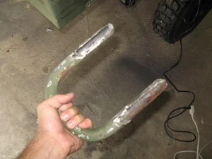

i cut the end pipes off for the tailgate work those things are solid steel!! Also for those that have cut the rear for the tailgate did you encounter oil? Strang i know but after cutting through the top tube (the rim around the trailer) quite a bit of oil came pouring out? i guess its to keep it from rusting from the inside out? ive never heard of such a thing.

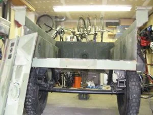

looking very good. I also cut in a tail gate. But have not finished it. Although it is on there, I have to use a strap to keep it closed.
If you look at semlin's tailgate it made up for the loss of strength.
Another vote for a close up of your angle iron around the tail gate. Been considering something similar on my M416. Curious how you did yours.

The liquid is Ziebart coating compound. The manufacturer "Zeibarted" all of them as they came off the assembly line. If you look at the top rails around the tub you should find the plastic plugs with the Zeibart logo, these were used to seal the access holes once the coating was sprayed in.

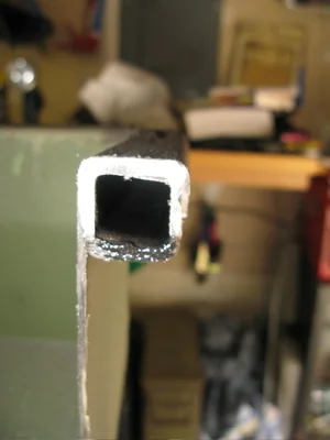

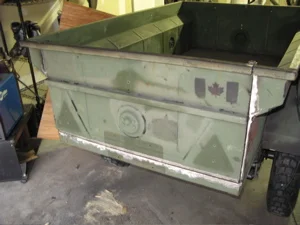

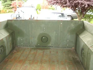

heres a few close ups from the pics i have now ill take more when i work onit tomarrow. its far from done but yoy get the idea basically just angle iron around the inside for the trailer and some square pipe ont he inside of the tail gate to help make the gate rigid and allow for a flush fit when closed, then ill run a strip of rubber on the angle iron so when closed it creates a water tight-dust proof seal.
