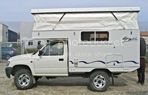

Been busy and stuck without idea on what to do with the roof.
The popup roof is @ 100 lbs (5/8"x 5ftx6ft plywood + 14G metal) so I am trying to figure another type of roof to reduce weight while increasing insulation. Once that's finish, I can start to have the canvas wraparound the roof popup and side panel popout to finish the camper.
Got water tank, pump, electrical, battery, solar charger, inverter installed so only minor details like stereo, wagon kitchen box to mount on the side when in use, store in trailer when traveling to finish the trailer.

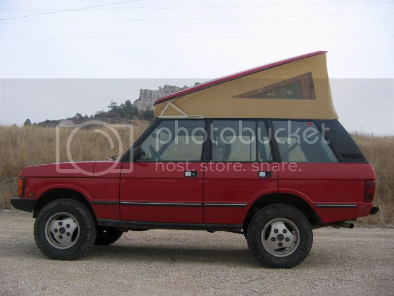

Any idea on what material or how I can make a light weight roof popup like this?
or popup toward the front like this?
