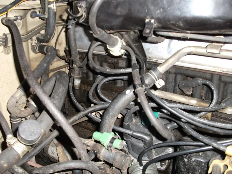

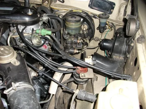

OK here are the pics
The pics look good (the visible stuff).
If you're at 10K feet, it would be good to make sure there is plenty of base advance. If the HAC stuff is left hooked up during the adjustment, set the base timing to 18-20*btdc.
Also at 10K, it is pushing the upper limit of HAC capability. You may need to adjust in (lean) the idle mixture yourself. It might be alittle too rich for a healthy idle. Oh, and you can adjust the idle speed screw to whatever you need it to be. That's why it's adjustable, so you can set it where it works for you.
Unhook the Primary?
So does that mean that I need to unhook the primary vacuum on the dissy when setting the timing while leaving the HAC one in place? Sorry if these are simple questions. Also I am using all 3 prongs on the gas filter is that correct? 1 is the Primary HAC coming off the dissy 1 is coming off the passenger side VAC and the other 1 is coming off the bottom of the 4 pronges on the driverside HAC. Thanks for all your help Jim!
Best to set the timing w/ the primary vacuum advance disconnected and plugged.
Gas filter (manifold vacuum) should connect to:
- dissy cap ventilation valve.
- to check valve and then to tee fitting, one leg to lower fitting on HAC valve, other leg to dissy advance.
