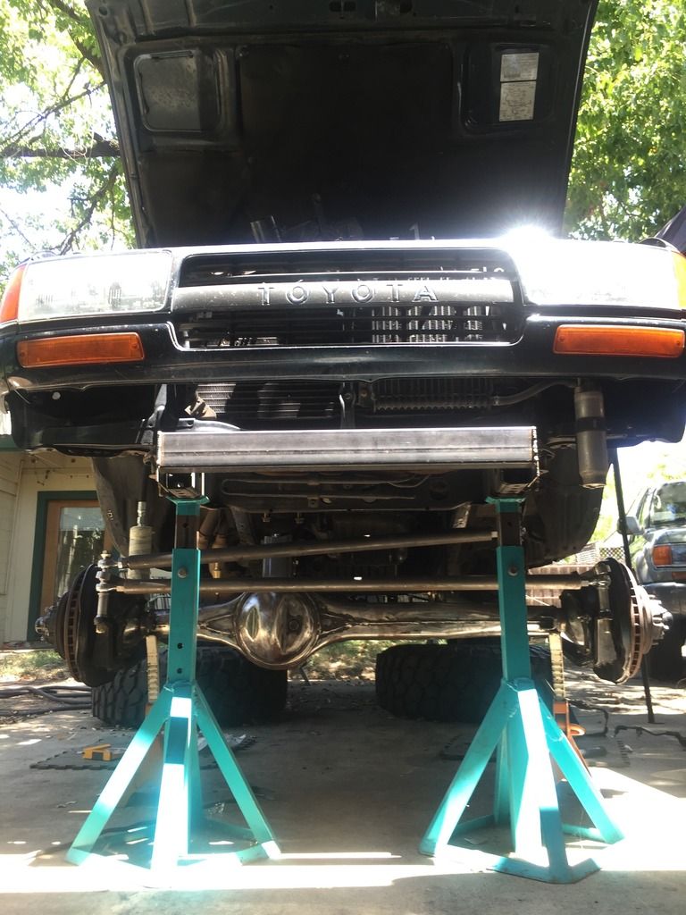

Got the steering setup, used carbide tip die grinder to enlarge the pitman arm to house 5/8 bolt.
Coped the axle mounts

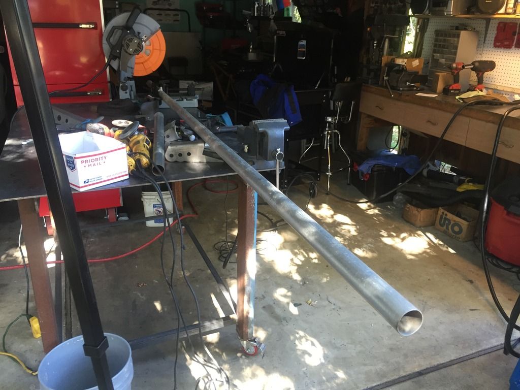

To get the 3 link tubing dimensions right I use home depot 1-3/4 Conduit piping. Its about $2 a foot. Its strong enough to cycle the suspension. Once dialed in, Ill make the final cuts on DOM tubing. Also its waaaay lighter.

Got the track bar link mounted
Also moved all of the steering linkges in between the steering arms. Mostly to prevent hitting the frame under flex on the passengers side.
started to cycle the suspension, everything clears on the passenger side.
Nice I love to 3 link and hope to set it up on mine some day. Already have the coiIovers and mounts set up about like you have them. Ruff stuffs new design is way better than the ones I used. I'll prabably never get the 6 " bolt that holds the top of the shock out. I always thought I'd put the top link in the driver side. I guess with the track bar on the passenger side that would be no good? I kept my exhaust inside the frame rail and takes up the space your top link uses.
Very nice. With this type of set-up, what can one expect in terms of increased articulation vs the stk setup?
Having links with heims allows for smoother flex compared to factory control arms.
Stock shocks are about 9" inches of total travel . Ill be running 14" coilovers. I built mine with slightly more uptravel at around 5.5 inches and the rest downtravel. So the suspension should be able to hug rocks with ease.
