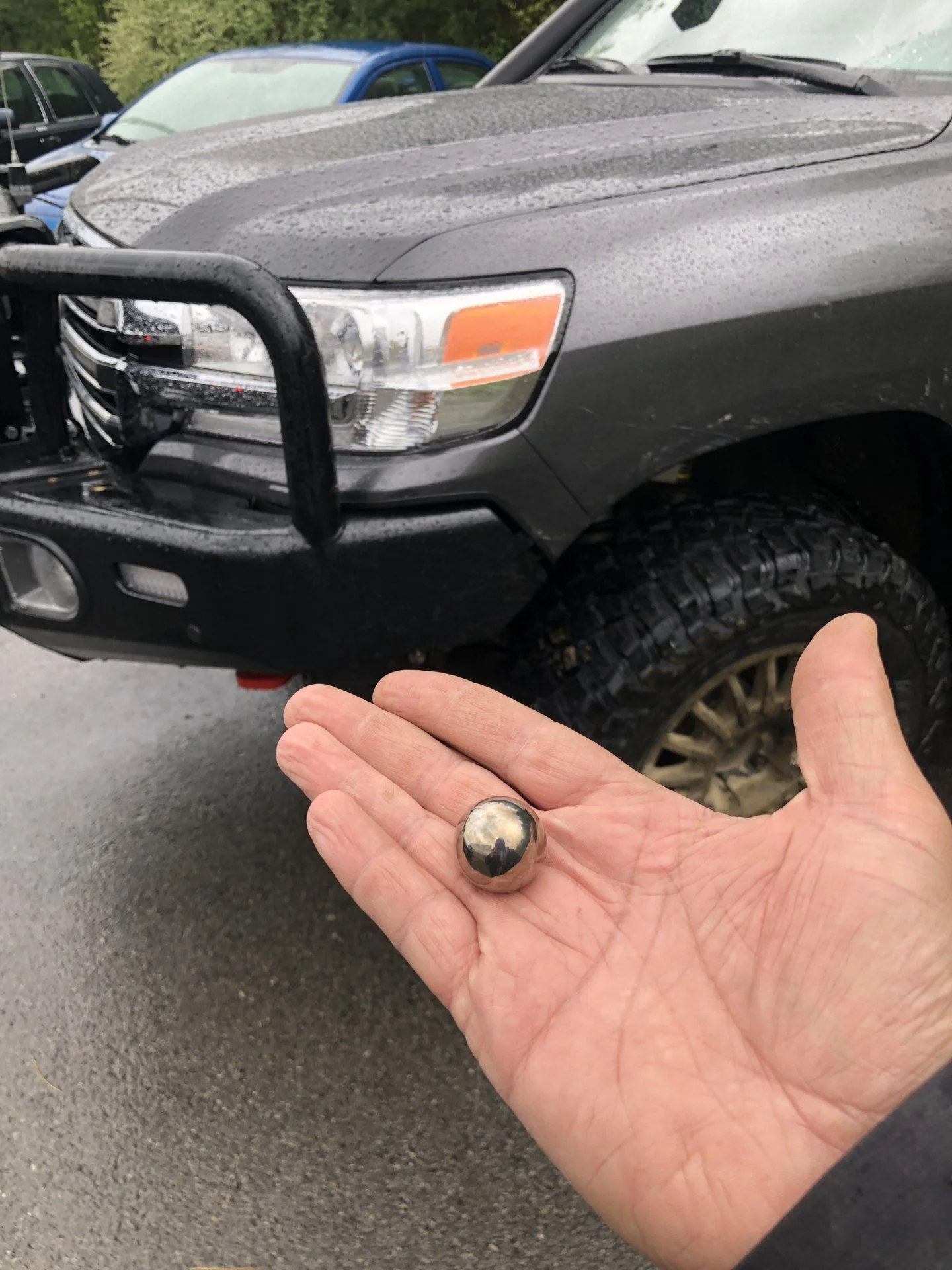

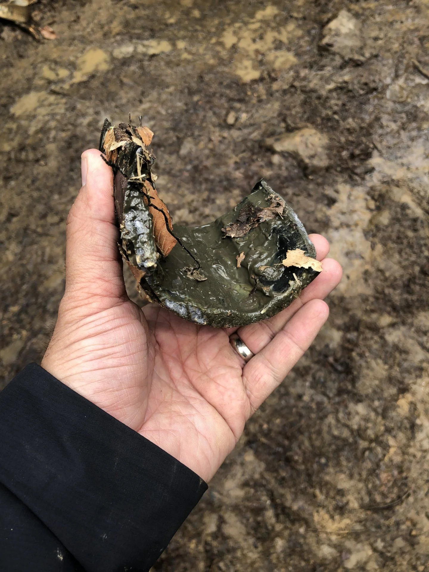

Blown CV Axle:
I was out with the Mountain State Overland guys this weekend in Southern WV. I had my Turtleback and was first to take a creek crossing and muddy, rocky hill climb on the opposite creek bank. The truck struggled to climb up the narrow passage and the weight of the Turtleback didn’t do us any favors. After several attempts, we nearly had the rig to the top of the obstacle when a thunderous explosion blew out the passenger side CV. This was shocking, sickening and sobering in that in all the years I’ve been out on the trails, I’ve never put myself in a position that my truck could not get me home. The truck is currently sitting at a Dealership in West Virginia waiting to get into the shop to give a better understanding of how much actual damage occurred. I have a sneaking suspicion that they’re going to want to replace the other CV and possibly the front diff as well.
Just watched this on YouTube. That sound 😵
If I remember correctly, I had the truck in the following settings:
  1. 4lo
  2. Traction off
  3. Mud/dirt
  4. Center diff locked
I’m fairly confident that if I would have had the rear locked it would have pushed the truck up the hill more effectively.
At the end of the day, I learned a number of things from this situation and I’m grateful for the guys from MSO being decent about it. The journey will continue.
  1. 4lo
  2. Traction off
  3. Mud/dirt
Hard to see everything going on, but from what I could see you were being given less than stellar advice/spotting/support. Also the amount of force being exerted on the truck it’s a good thing IMO the CV broke instead of something more expensive and difficult to replace. Are you thinking of carrying a CV as a trail spare?
Spare CV from now on for any stuff in the east.
I will say that I was listening to the spotter and was being told to keep going. The reality is that my judgement slipped. I had a gut feeling that We needed to do a double line pull from the winch and that probably would have kept the day moving. Thus, I just remind myself, go your training, you gotta get your truck home.

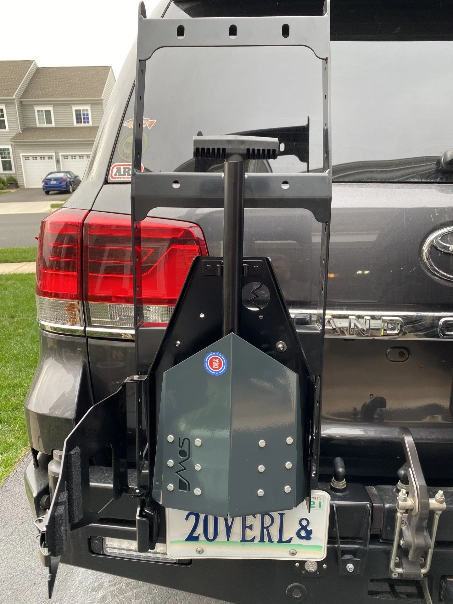

Added the DMOS Collective Delta Shovel to the truck’s kit. Love the simplicity of this shovel and it’s mounting.
