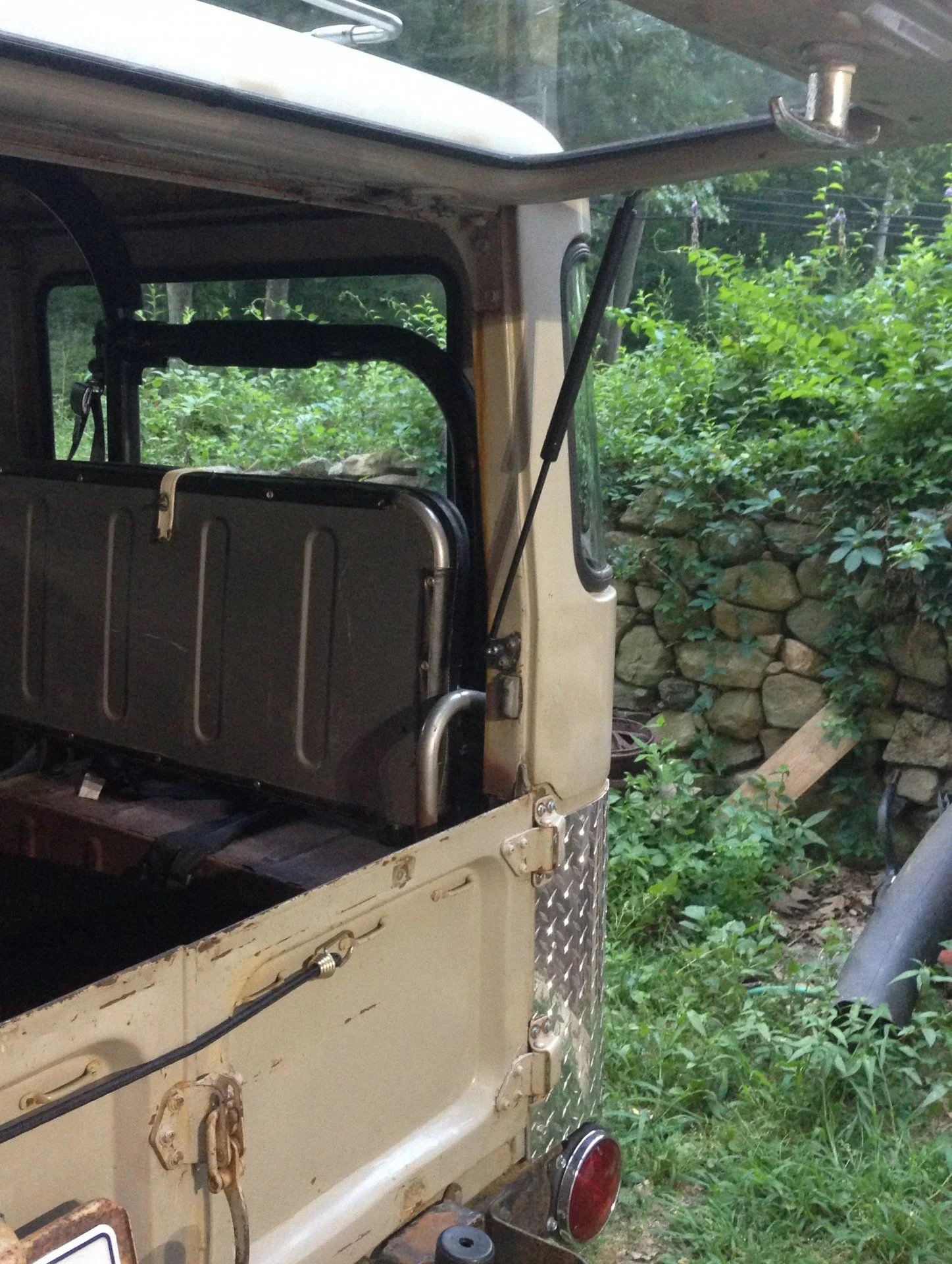

This thread inspired me to do the same mod and upgrade my old factory spring lifts with modern gas springs. Im going to sell my old ones and put it towards an SOR upholstery kit. I went a different way on the brackets and springs so Ill list my part numbers.
For the shocks I used two 50lbs www.mcmater.com springs part number 9416K19.
Extended Length 18.62"
Compressed Length 10.35"
Stroke Length 8.27"
M6 rod ends.
The springs had a vendor part number on them when I got them: 1620 www.suspaparts.com

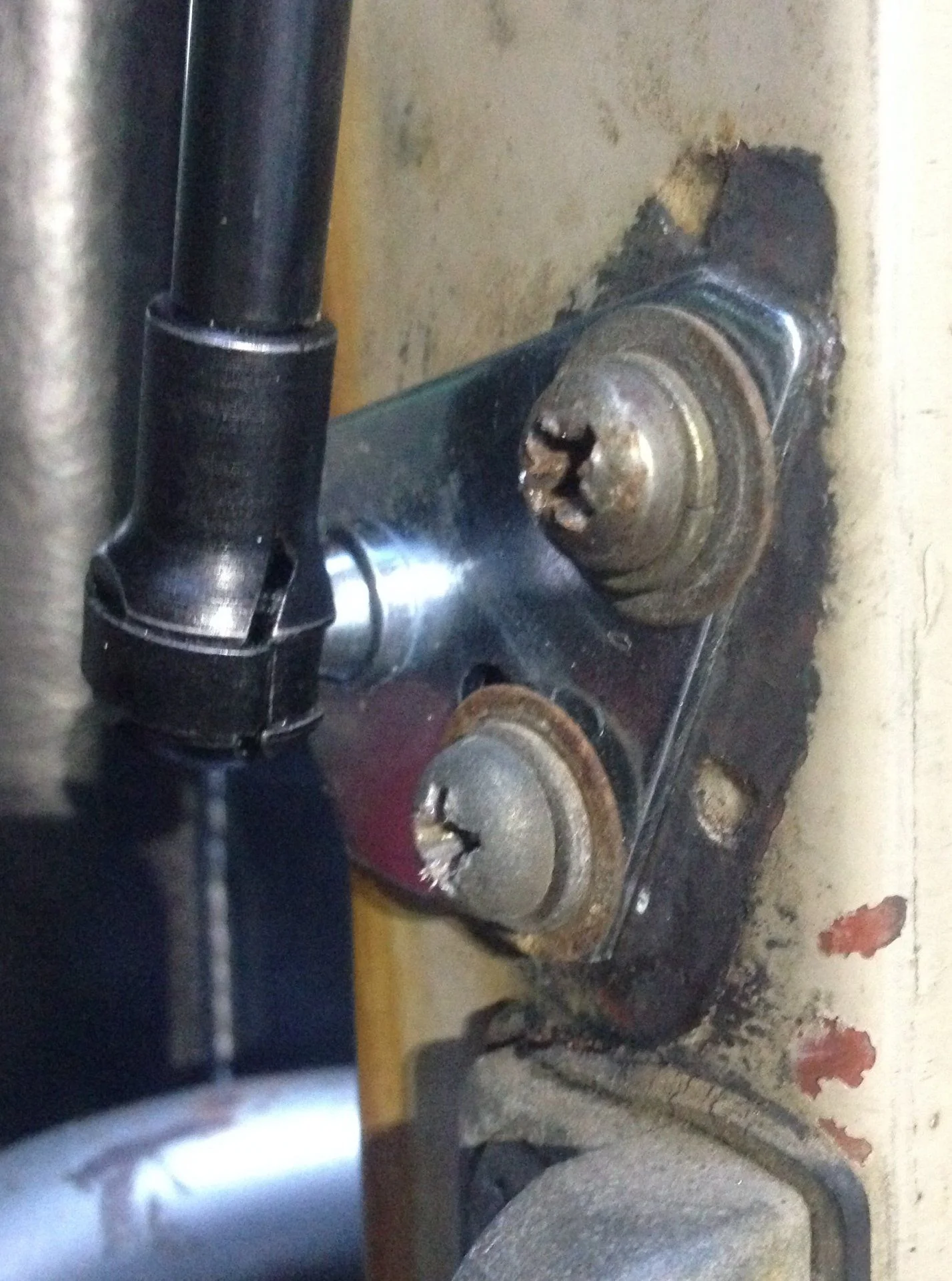

I added on McMaster part number 9416K74. I did not go with the quick disconnect because I think these give a cleaner look and the clip is easy to pop off. I cant say what shipping was because I ordered it with other items but it wasnt more that $8 for everything.
For the brackets I used steel brackets from a company called JR Products. These are RV brackets and when I contacted the manufacturer they said 50lbs would be no problem and they are often used with 150lbs springs. I bought them off amazon because of free shipping and free returns with Prime.
JR Products BR-12553 10mm Angled Gas Spring Mounting Bracket - $8.17 for the pair
JR Products BR-1020 10mm Flat Gas Spring Mounting Bracket- $7.70 for the pair
The upper brackets required I drill a new hole and open up the existing one I was going to use.
The lowers required a new hole and I cut off a tab about 3/4"
It all mounted up nice and looks very clean. Out the door I was looking at $43.35 for the spring and rod ends and $15.87 for the brackets.
It works great and gives me just a little extra travel.
