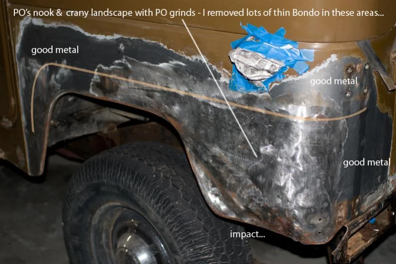

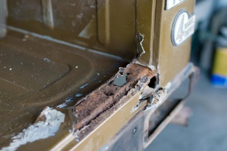

My drivers-side rear quarter panel has had a minor collision at some point in the past. The rear sill also has the standard cruiser rot, which some PO/body shop filled with little plastic bags of bondo from the rear of the sill. Also a good part of the wheel cover/quarter panel spot weld seam is corroded with larger swell dimples beginning to show on the outside of the quarter panel (passenger-side is the same).
I've pulled the tire carrier and stripped all the paint and plastic filler. Next I'm going to strip and clean the inside of the quarter panel to get it ready for hammer and dolly. At this point I'm only concerned about doing a bit of repair (the right way) and improving the cosmetics of the truck a bit. Somebody has banged/sanded, and its a bit rough, but it really looks better than I expected. Lots of good metal and the tire mount area seems solid. Hopefully I can hammer/dolly it out to look much better.
My main question is about the sill, how hard it would be to replace correctly and if there's a standard method to follow when cutting out the old sill and welding in a new one. I think my old sill might still be ok with some proper welding/repair. There is a small bend from the impact coming through to the curved part of the bracket (see pict). Looks ike it can be hammered out.
I'm also considering removing all the old seam sealer on the wheel well spot welds (lap joint) and seeing if I can clean/treat the seam area to stop or at least slow the corrosion. Maybe scrape out, treat, hammer/dolly the seams a little and air force POR15 in there for now.

Knee bone's connected to the thigh bone. If you're going to weld in a new sill, best go ahead and patch the quarters while you're at it. You'll need to weld to the area where there's rust on the quarter, so you can't properly install the sill without working the quarter as well. You're not going to have much luck with the seam along the top of the inner fender. "Pulling out the seam sealer" will not give you enough room to do any good, it's spot welded about every 2.5 inches. Whatever corrosion is there, is there. Only way to repair it is to replace the entire quarter. Replacing the sill is very straight forward, just cut, cut, and smoke hatchet a little and you're in. I've used lots of different sill pieces, similar to the sor one. All require some fab skills. If you can weld, or know someone who can, this is a pretty easy repair. Then you just need to learn body work!

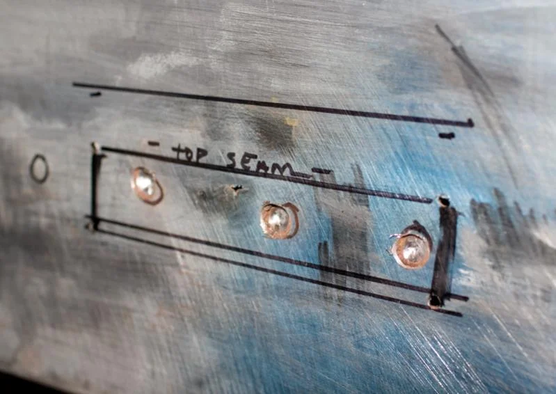

I thought at some point I could say, drill out the spot welds, maybe pull the wheel covers (and rear bed?), clean up everything, weld patch the quarter and weld everything back together. There seems to be lots of good steel left on the quarters to just trash them, and I like that they are original. If I need to replace the entire quarter at some point I may be wasting my time with the hammer/dolly cleanup now?
Where specifically do I cut? Are there alignment issues when the sill is removed, or will the floor, wheel covers, etc. hold everything together? Is the sill bracket welded everywhere to the quarters or only in certain areas (i.e. is the curved tire mount area welded)? Can I leave the bottom frame bumper in place or is it removed somehow before I start cutting?

Do a quick hammer/dolly rough fix on the driver's rear quarter and put on some temporary paint. I may play with the upper seam/old seam sealer/corrosion a bit, at least to get a temp POR15 in there for now. I'll post up if anything seems to have a positive outcome.

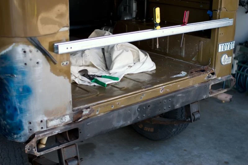

Getting a bit deeper in the sill.

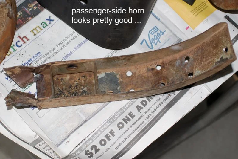

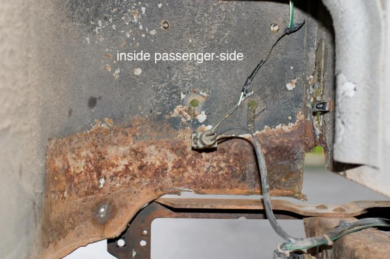

I had hoped to maybe save the main sill/horns - have it dipped and practice some fab/welding. Of course now that I'm getting in there it looks like it may be toast. The passenger side is the big hole, but the whole top seems to be questionable at this point.
The driver-side damage (rear quarter) is coming out (hammer/dolly) with lots of stuff falling out of the wheel cover seam (a few holes appearing) - so as the can of worms opens further...

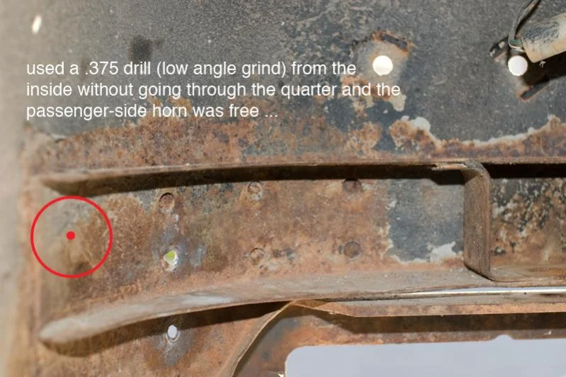

Anyone have an opinion on the cleanest way (least damage) to remove the welds at the horns? Can't really identify the spot welds.

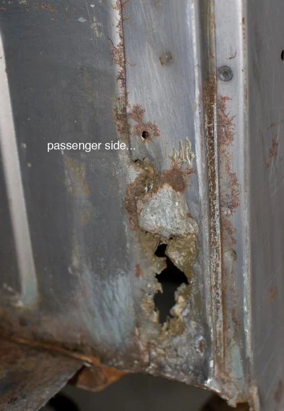

I'm watching your progress do to the fact the sill in my '78 is in the exact same shape, only the PO bondo is on the ps 1/4 under the "toyota-4wd" emblems. I can see my spot welds on the horns from the inside of the wheel well.

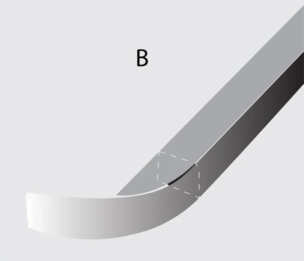

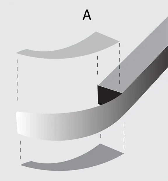

With that much of the old horn, you can fab a new one with minimal welding skills. Start with 2x2 square tubing, cut the "front" away from the top and bottom to the point where the curve first begins. Curve the "front" to match, cut away the top and bottom till you achieve the angle you need. Hard to describe, but not hard to do. You'd only be using the old one for a pattern.
Thanks Texx/folsom50 - your feedback is much appreciated.
What kind of 2 inch tubing, cold roll, anything steel? Any special wall size, etc.
Cut like "A", or more like "B" (see attachment)?

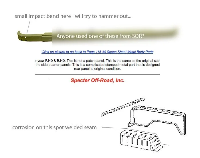

I'm still planning on buying the skin, the holes are pre drilled so I can use that as my jig to drill the sill for the tire carrier hardware. See below.
Rear Sil Skin pre '79
As far as the CAD drawing (photo B) you just posted, that exactly what I had planned on doing. I had seen where someone had used 2x3, but I guess it may be overkill. Looks like from everything I've seen most people are using 2x2.

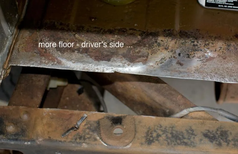

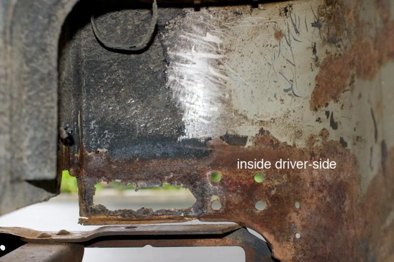

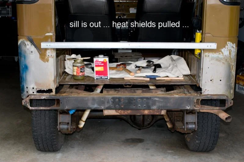

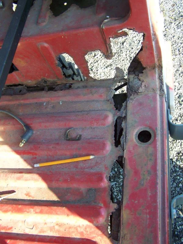

The sill is out
Well - the sill is out.

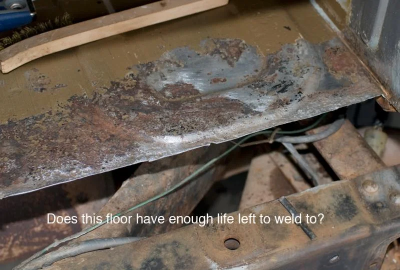

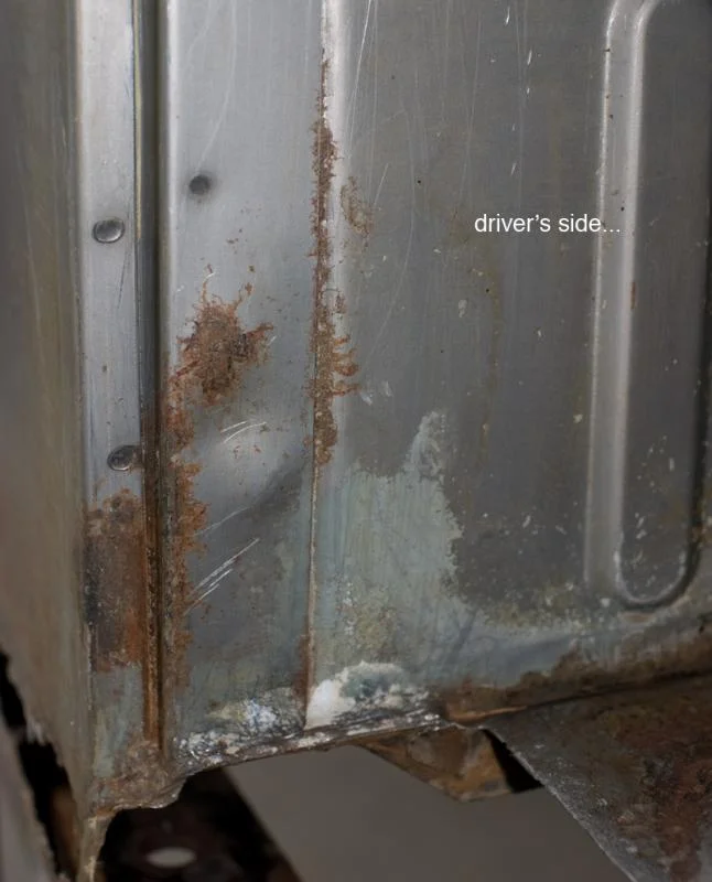

The floor, which is pitted, seems pretty solid and looks OK from below. I managed to pull the heat shields without breaking any bolts. Floor has a few big dents. The rust starting at the sill I've cut back a bit - may need to cut back more. This will mean an additional piece welded in to meet the new sill (minimum). Not sure if the floor is good enough to weld to in this area?
Rust in the lower quarters some of which no doubt needs to be cut away (minimum).
Still undecided about locating a sill or trying to fab something up. The CCOT cover piece looks good but I'm not sure about the inside horn thing they do.

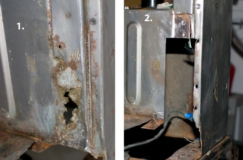

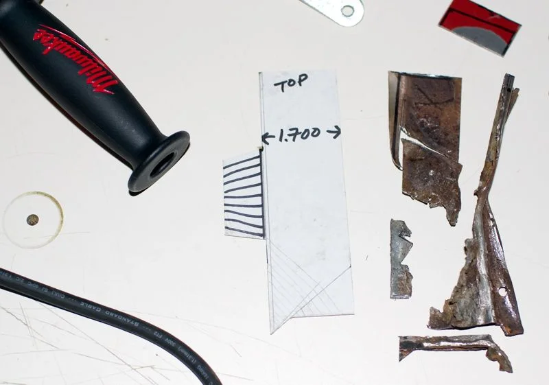

Beginning to explore a few seams and pattern some patches. Just a question of how far to go, how much to remove and if I can patch and rebuild areas in a reasonable way as I go. Also still pursuing the idea of patching the main corroded top seam on the wheel covers, little by little, which I know many think is insane :D
I'm thinking of ordering a full sheet of 18 ga and get it sheared to a bunch of established smaller sizes that I can then fine trim as I go along. Don't have any sheet metal machines (brake, etc.) so I'm limited to hand tools (and no air) at this point.
Need to find a better (accurate) way to cut out old metal - maybe an old style hand-nibbler of some kind. Also going to check the weld shop for some Clecos - hoping to do some decent fit-ups with the patches.

The floor in your picture is to rusted to weld to you ,have to start further back were the metal has no signs of rust or pitting,if you weld were you have cut in the picture you will continually burn holes in the metal and it will continue to rust out.
I would pull the entire floor and get a new one because you will never duplicate the dimpled pattern in the floor,and you won't be able to weld flat sheet to the dimpled contours of the remaining bed.
Any areas that show signs of pitting should be cut out till you get to good unrusted metal.
Looking at all the pics you have posted I would replace the wheel wells , bed, both quarters, and sill, if you don't the rust will keep coming up,time to open up the wallet and dig into the piggy bank.
