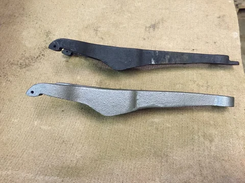

I have the 12HT installed and running but I ran into a little snag. After the installation I could not get the clutch disk to disengage from the fly wheel. When I finally had exhausted every option to resolve this issue, without removing the transmission and t-case, I gave up and pulled them last weekend.
The motor came with a newly installed clutch and throw out bearing. During the install I noticed that the throw out bearing was different from the original one on the 2H. So I used the new one. (It is always a good idea to keep the clutch, pressure plate and throw out bearing together when working with used parts). I also noticed the clutch slave cylinder was different. So I used it. When I examined the clutch fork I could see no difference, but it was in better condition than mine. So I used it. All of this was used with my original 2H bell housing.
I should have known better! It turns out the clutch fork is slightly different from my original. (Another good rule of thumb is to always use the clutch fork that came with the bell housing being used). When examined side by side it is difficult to see the difference between the two. But the depth of the pivot ball socket is deeper on one than the other. And there in lies my ultimate problem with my set up. Apparently there was enough difference in the depth to keep the throw out bearing from applying sufficient pressure to the pressure plate to disengage the clutch disk. There was also a difference between the slave cylinders. My original one has a longer cylinder than the new one did. The original one is going back on with the clutch fork.
Tomorrow I will install the transmission and t-case. While I had everything apart I decided to clean up a few annoying problems. My fuel cell had developed a small leak, so it will be going out to the radiator shop for repair. My original t-case had a very troubling leak. It was leaking from the split case joint. Instead of rebuilding the t-case at this time I'm opting to install the transmission, after swapping out the top plates, and t-case that came with the motor. I also blasted and painted the bell housing and clutch fork before installation. (In the pictures below the shiny new looking clutch for is my original after painting).

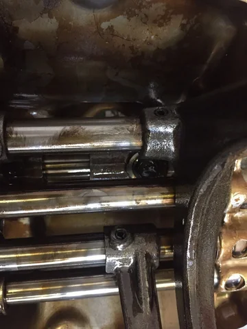

For anyone interested in what the difference between the top plates on FJ40 and FJ60 H55 is, here are the pictures. Also included is a shot of the inside of an H55.
The 40 top plate is on the right and the 60 top plate is on the left.
