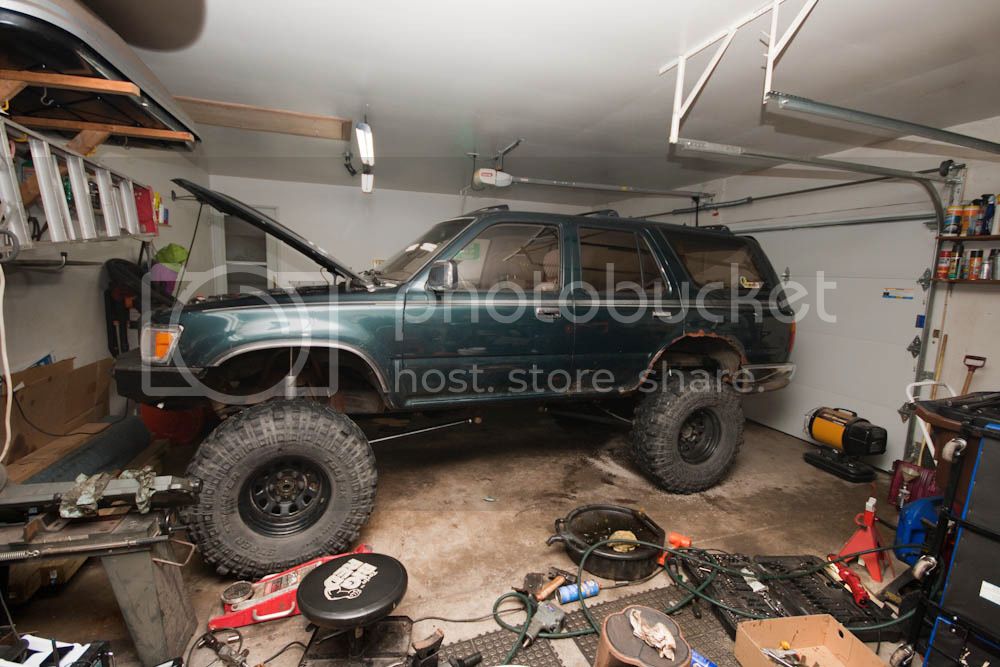

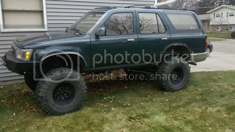

Cliffs on my project, been 2 years in the making...
95 4runner, 3link front, 4 link rear, 5.29's, High pinion front, locked f/r. started the project having no clue what I was really doing.
Finally got it finished enough to test it.
it shakes bad at about 45 mph.
Everything is tight, I believe the steering is aligned straight (didn't have a shop do it, but I triple checked my measurements)
I'm thinking the tires are flat spotted from sitting so long, how long should it take for the tires to heat up and round themselves out? from my searches most say a few miles, some say up to 150 miles.
tires in question are TSL SX 36/12.50/15
I only drove it about 5 miles today, came home and double checked everything was tight and nothing loosened up.
It tracks straight and rides surprisingly smooth until it gets up to speed

I do feel it at lower speeds too, it just seems to get bad at about 45 mph.
ujoints on the driveshafts are good, angles might be too extreme (although the rear can drop until the springs fall out with no binding issues, the front will drop till it splits apart.... still got to get a new one made)
turns out I didn't have enough camber, and my toe angle wasn't set right, got it aligned better and the shake is almost gone, turns a lot better now too
still might need another degree or two of camber
