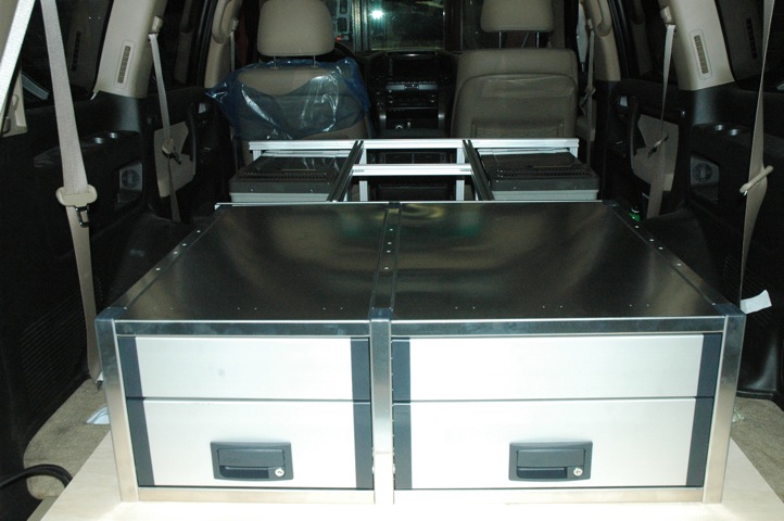

Now the sleeping plattform building phase has started
When you have ideas or suggestions - jet is the time to wrote them, because changes are still possible.
More pictures and news of the progress, you can find in the blog @ http://transafrica2012.blogspot.de
When you have additional ideas or solutions - write em!

You find 5 new Pictures under "Sleepingplattform" there is a progress :)

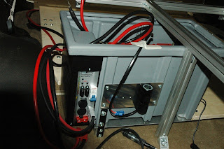

I have now more pictures online - from the storage room below of the sleeping area.
The buildup nears the finish state:

@Adventure Copan: Some pictures are specially for you (pump). The warm water i get with a "Helton hot water" device (google). The heatexchanger isnt visible - so im not able to take a picture - without parting out the car.

I had now severall time the chance to test the helton hot water device.
It is great!
At first: the surflo pump is to strong - mean - they pump to much water through the heatexchanger.
So i had to limit the waterflow a bit - and now - i could have a really hot shower anytime!
Surfy
