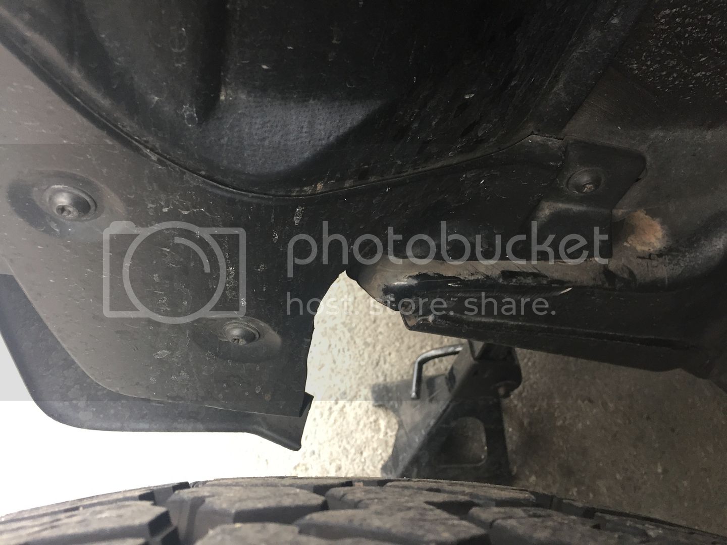

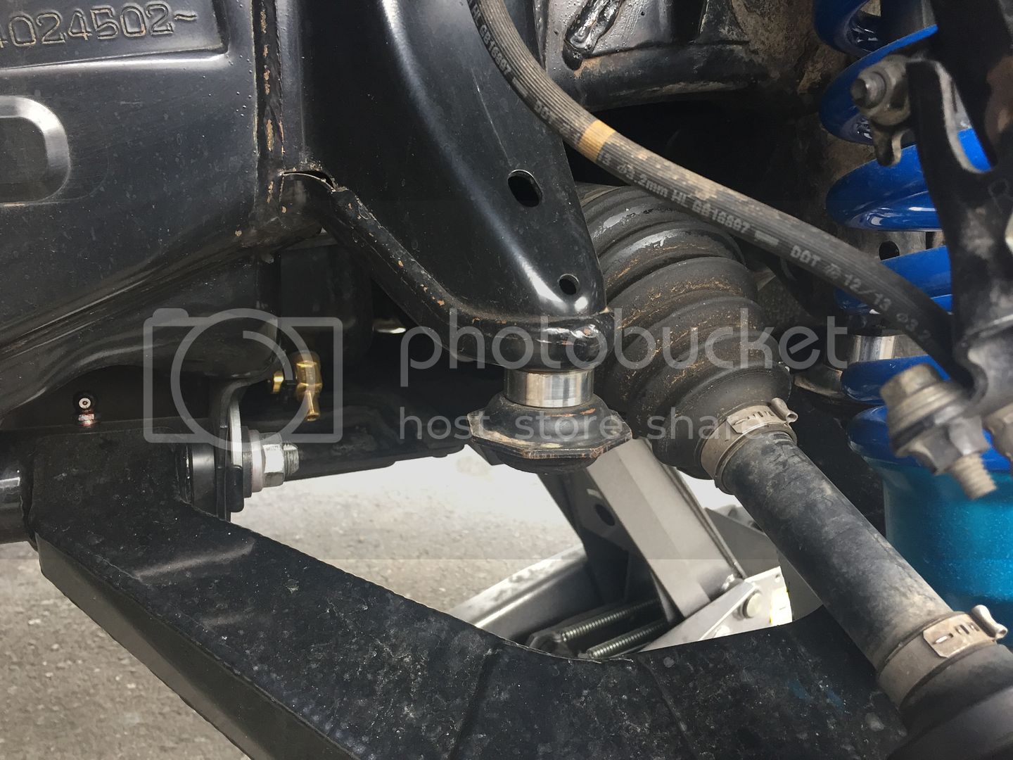

After the install of the Baja Kits UCA, I had some minor rubbing of the tire on the UCA at full lock. It would've worked fine with a different offset aftermarket wheel or spacers but I didn't want to loose the RW's and Jordan wants the kit to be able to bolt on to OEM trucks without any further mods. Jordan said he was going to make some tweaks to the design angles and he'd be in touch with me in a few weeks after they were laser cut, welded and powder coated. I got the call last week and dropped the LC off Monday morning. In this picture, you can see where the rubbing was occurring:
While it was jacked up, I took some pics of the minor trimming we had to do to fit the Falken Wildpeak 285/75/17's. Here's the mud flaps:

I didn't get any shots of the re-designed arm on yet. I'll post some when I do. Needless to say, no more rubbing on the arm. At full lock turned to the right, the drivers side tire touches the KDSS arm slightly. Only way to fix this is go back to a smaller tire, aftermarket wheels, or spacers. I'll live with the minor rub.

wonder if they would entertain the idea of making a re-shaped KDSS bar? (I'd buy one forsure!) Great looking truck and pics!
Yes get them motivated on the kdss bar
