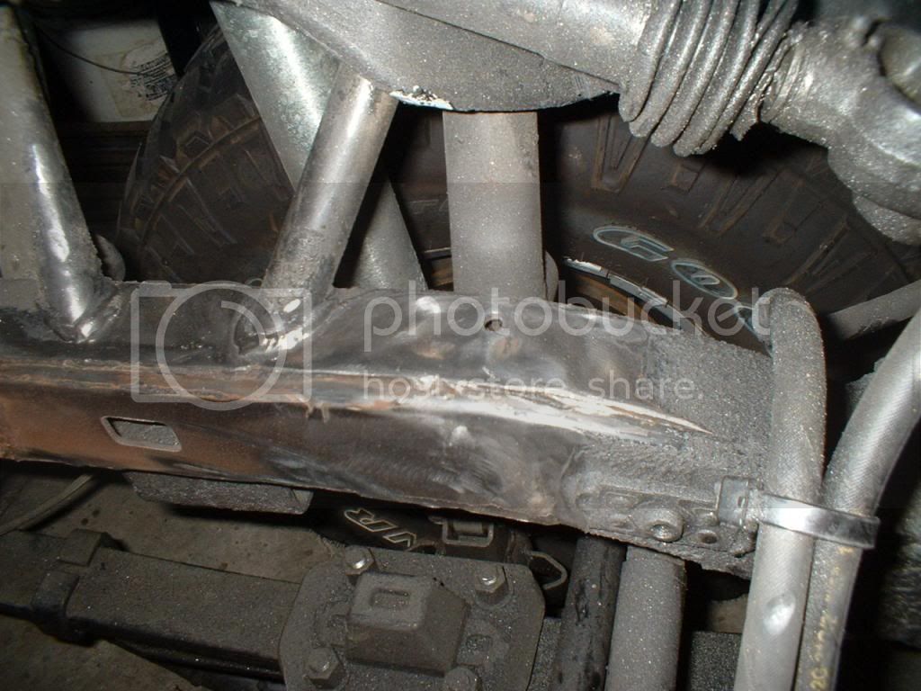

I cut the frame back about 8 inches. The shackle mount is the point is was cut at.

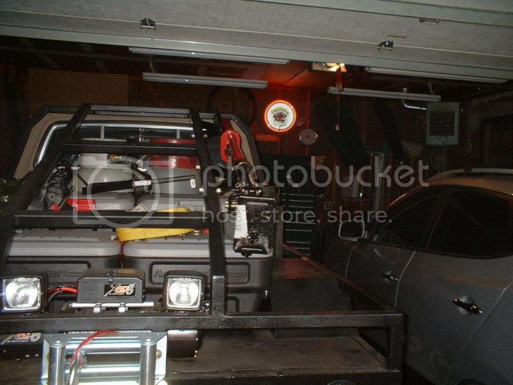

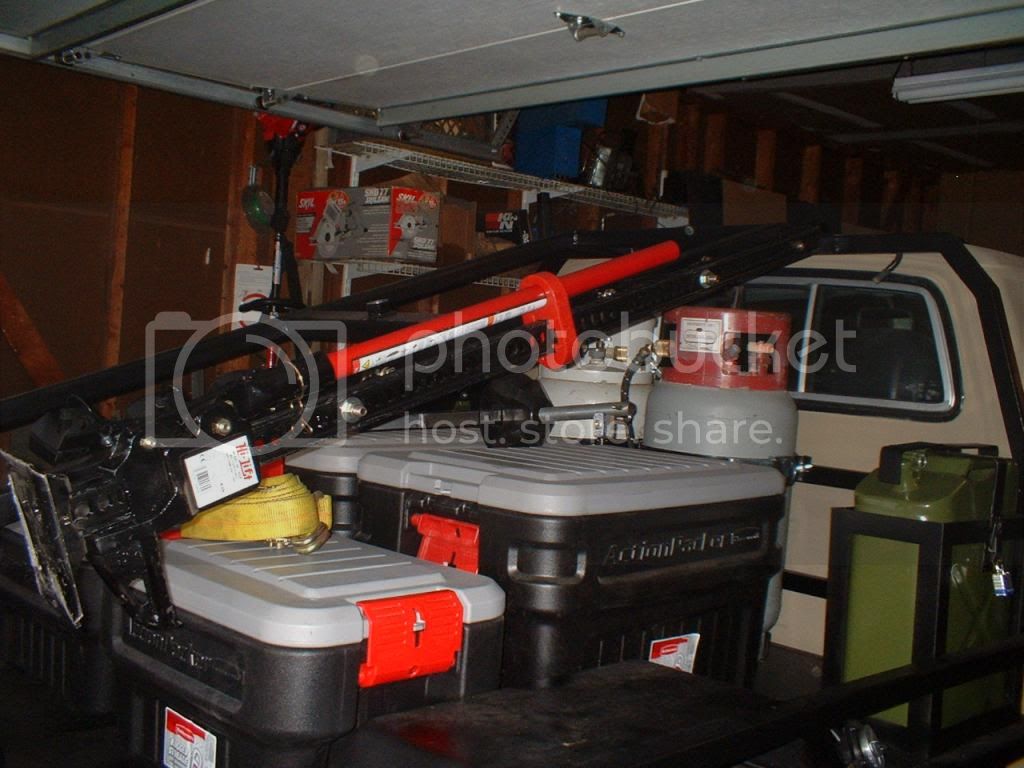

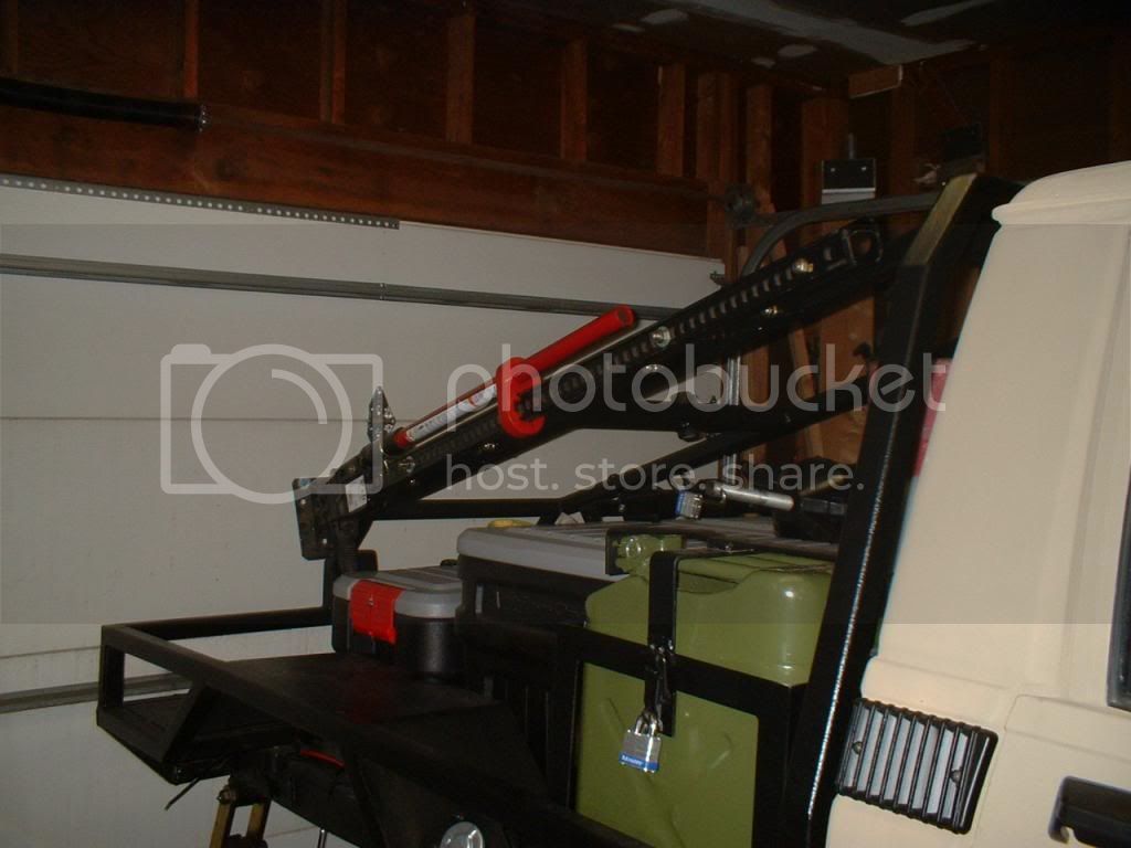

I hate waiting with not much to do so I figured I would build and install the high lift jack mounts. I simply bent material and welded a bolt through the mounting surface. They act as studs to hold it up there when bolting it down. I always seem to have a 3/4 wrench in my tool stash so no need to use some sort of wing nut to hold the jack in place.
Here are a couple of pics.

When all of the issues are resolved I then need to build a car port on the side of the house. The truck is too tall to fit in the garage when the light bar and spare tire are on the bed.

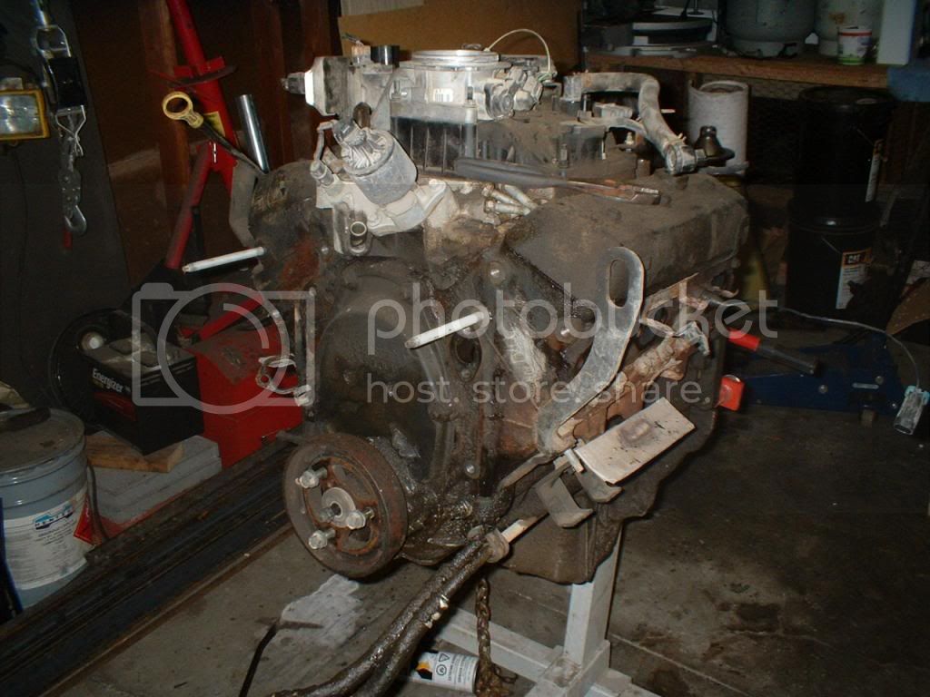

Enters the 1996 GMC 4.3L

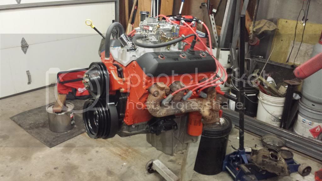

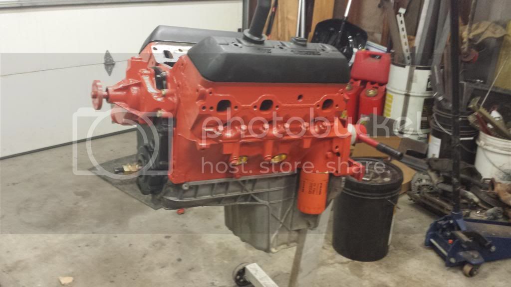

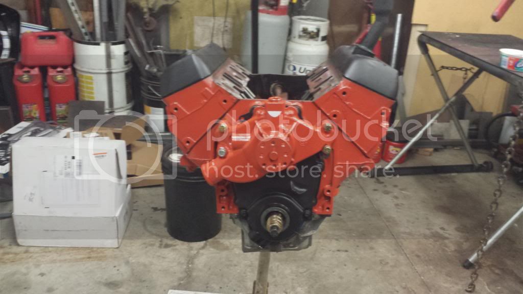

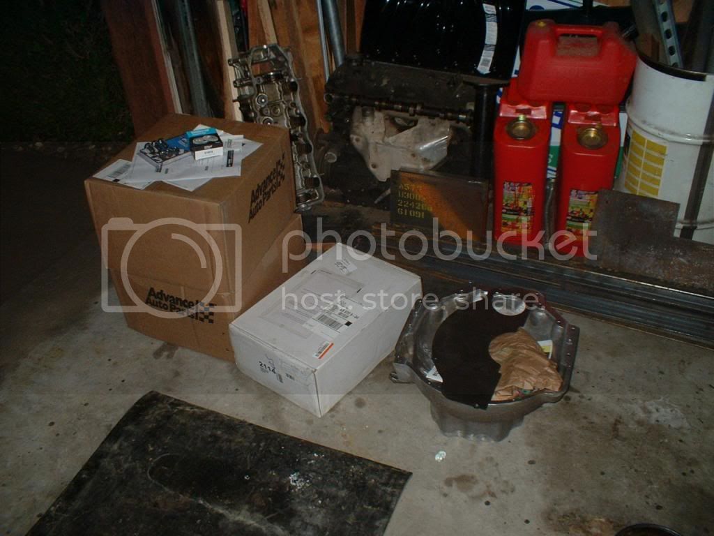

I am going to tear it down and give it a good cleaning and refresh it, add new where needed. This includes rings, bearings, oil pump, timing chain, valve guide seals and gaskets. It is getting a v-belt kit, 4bbl manifold, and a eldelbrock 500cfm carb. My propane system will be added to this engine. Things already acquired, flywheel, flywheel bolts, clutch and pressure plate, throwout bearing, starter, advance adapters bell housing, slave cylinder carb, and manifold. Need to buy v-belt pulleys and water pump, waiting to fit the engine to see what room I will have, long or short nose water pump. I also need to buy the gaskets, seals and distributor.
Some of the stuff has arrived.
There is a high torque, no nose starter in one of the boxes. The manifold and carb are in the others.
Tomorrow I will be pulling the engine apart.

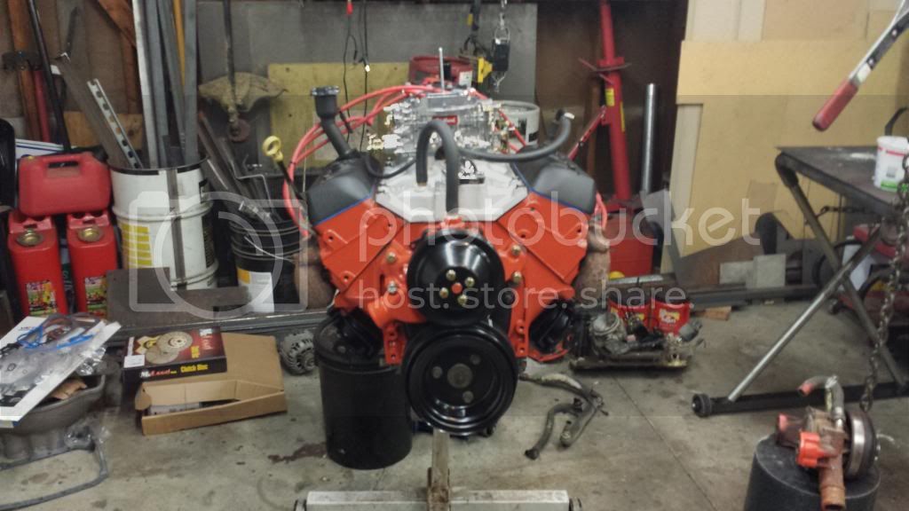

The engine is pretty much done. It requieres a few hose clamps and fittings, then it is reddy to install. I may have some time to remove the 22r but fitting the 4.3 may be delayed. I have to have work done on my right knee. This will keep me layed up for a while.
Thanks, no EFI, easer to install carb and I have propane also.

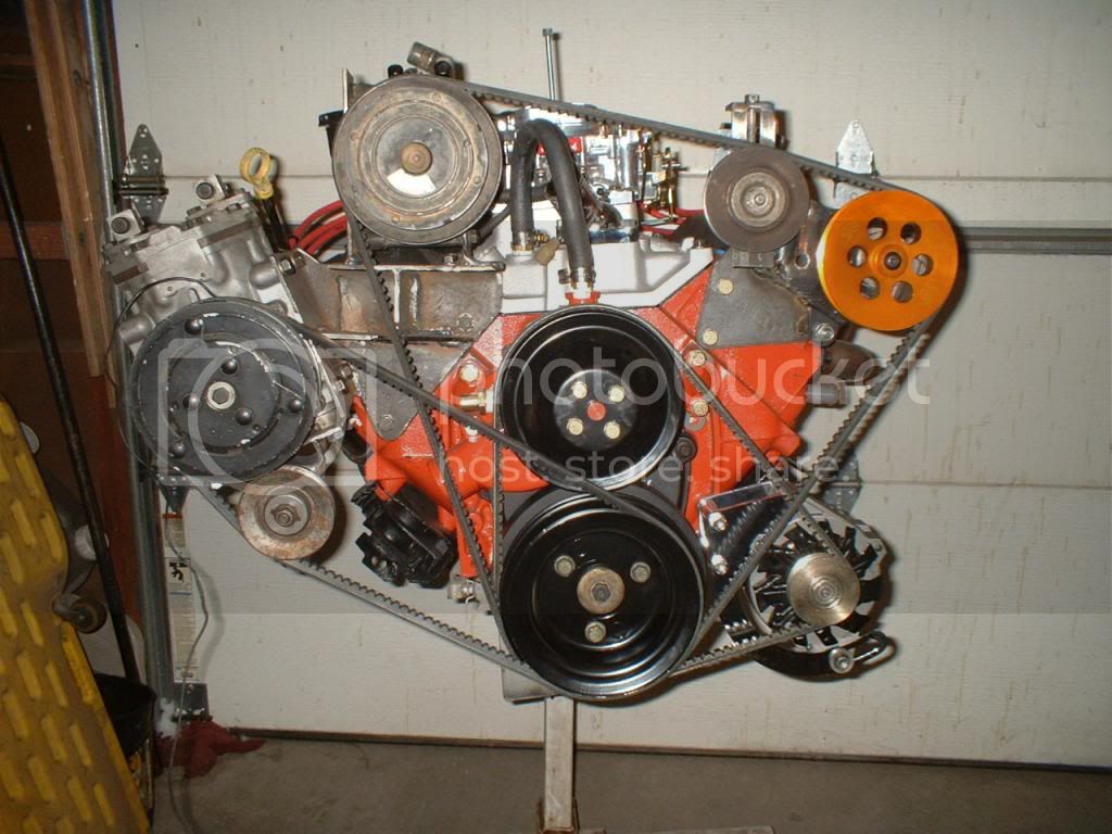

I finished building the brackets. I decided to buy a bracket for the alternator, I simply did not want to mess with it when it can be bought pretty cheaply. All belts are fitted also. Now I need to take it all apart and paint the brackets. The alternator bracket will be sandblasted and painted black like the rest of the brackets I made.
Looks awesome. Glad you are back up and going. How's the knee?
Hey man, good to hear. What PS pump is that you are running? Looks like a PSC or TG pulley on there. You like it? I have been considering upgrading mine when I do my motor build.
Thanks
IT is a TG pump. It is doing great but, I do not have a bunch of miles on it, so I cannot give an opinion on how long it has lasted.

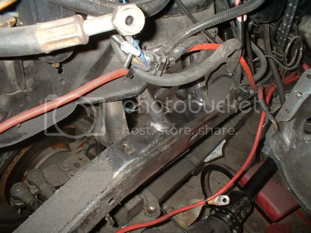

Yesterday I installed all of the goodies on the flywheel side of the engine and stuffed it in the truck. I did this to make sure I was not going to have to shave any of the input shaft, and where the motor mounts would be located. Nothing had to come off of the input shaft but the motor mount stands had to be relocated.
This morning I removed the engine and all of the stuff on the back side of the engine. I then cut off the old motor mount stands. Then cleaned the Herculiner from the area.

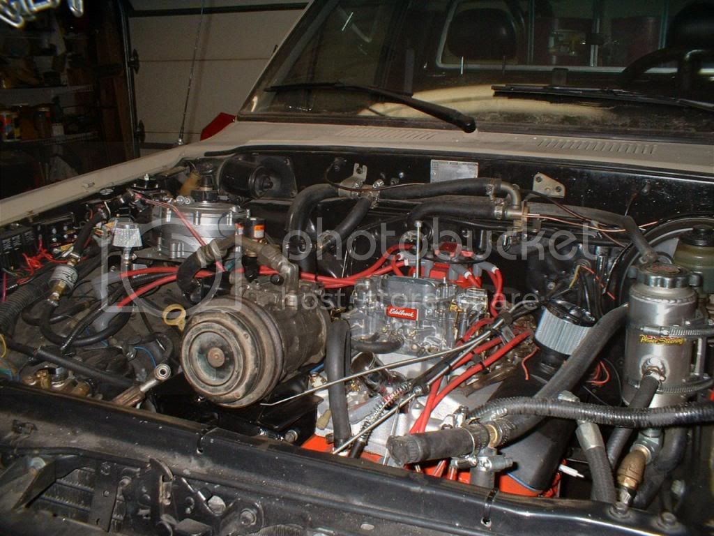

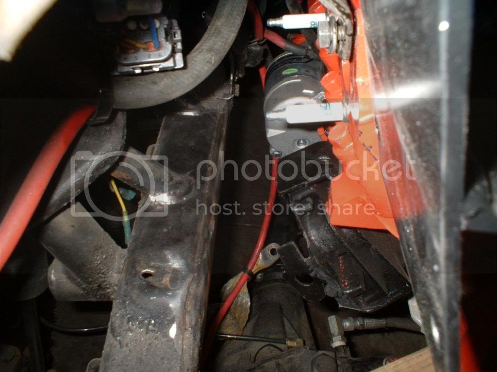

I installed the bracket for the AC and air compressor because the ac compressor is the highest thing on the front of the motor. Then I set the hood on the fenders and raised the engine until I had about 1 inch between the hood and the top of the compressor. The following pics will show the rest of the clearance issues.
The engine in a messy engine compartment. Still that little V6 looks pretty comfortable in there.

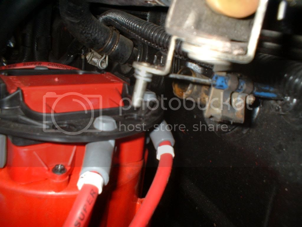

After doing all of the research on the 4.3 swap, I was a bit concerned on the firewall and distributor location. Well on my setup there is about 1 inch between the distributor cap and the firewall, no sheet metal work needed here.
As for the front of the engine and the radiator, again no issue there. There must be 9 inches between the lower pulley and the front frame. When the radiator and fan are installed I should have, at minimum, 4 inches from the pulleys to the electric fan.
Now I am stuck, I thought I had enough material to build the mount stands but dont. The top of the motor mounts will sit about level with the frame when all is said and done.
