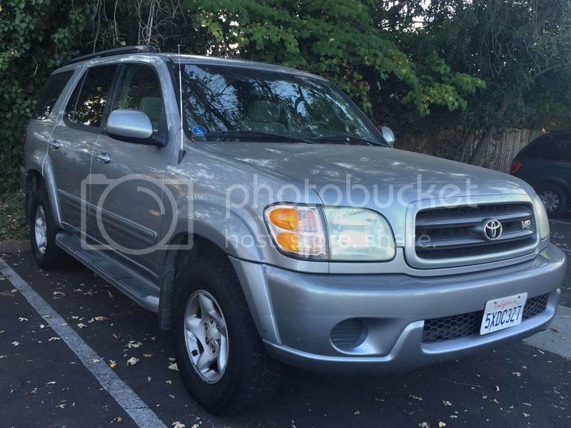

Picked this up a couple weeks ago. 140k miles. Other than the aftermarket sunroof, basically all stock.
I replaced some missing trim at the rear window, a torn weatherstrip/trim at the right rear door, the hatch pull down strap and a second seat head rest and tubes for same.
I debadged it along the way.
Then I ditched the running boards and mudflaps.

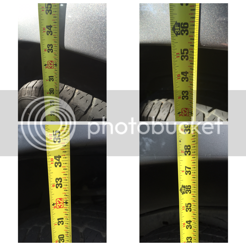

Yesterday saw bilstein 5100s, uzj100 rear springs and a 1" diff drop.

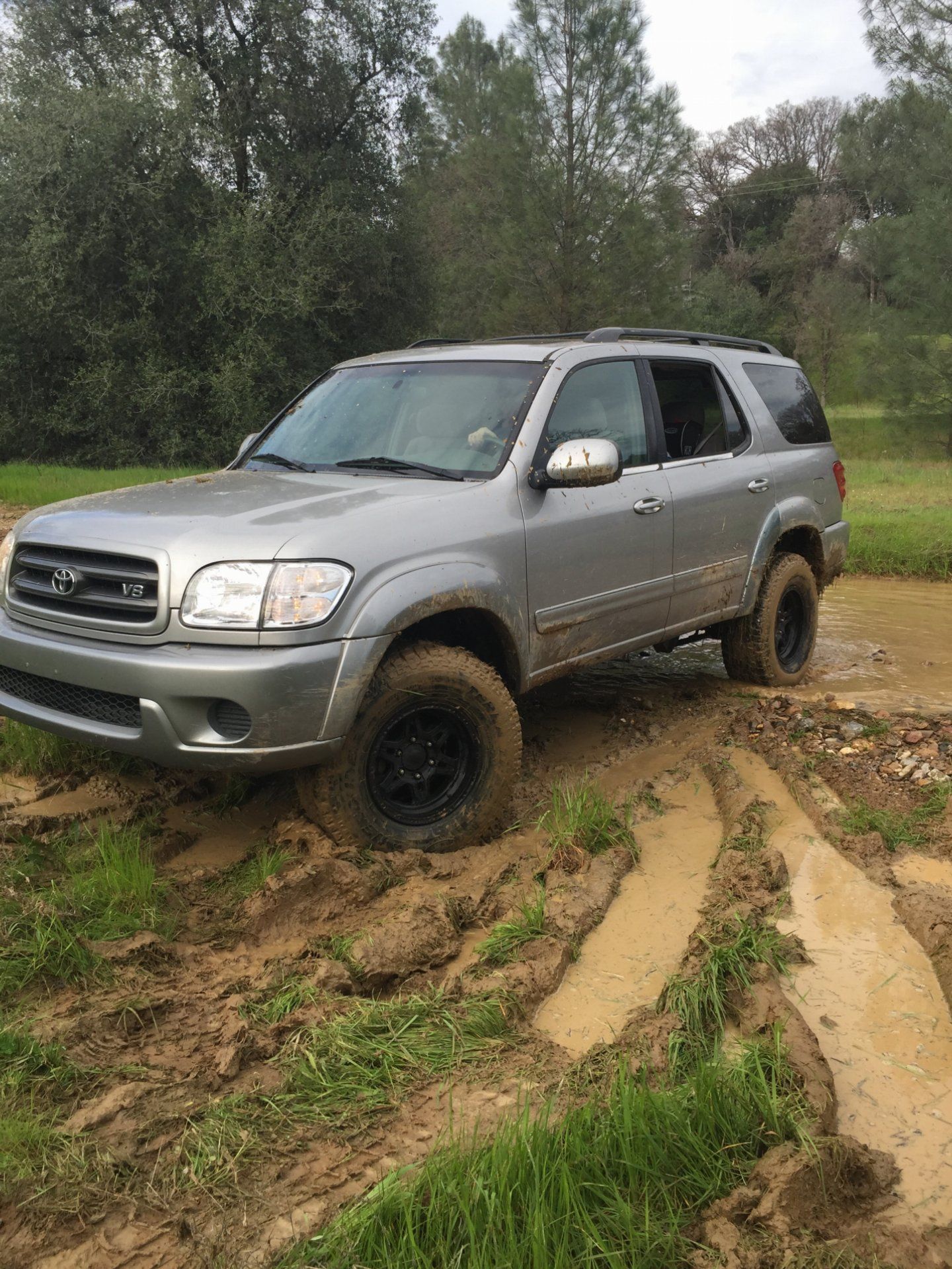

This Saturday I hope to swap on my 285/75/16s and wheels from my Tacoma.
You.. ditched... the mudflaps smh.. out here, people buy those left and right because they are in such high demand.. and hella expensive to replace!
Finally swapped the wheels from my tacoma on. No spacers, I'm digging it.

Looking good so far, projectTuRD! Did you use stock UZJ100 rear springs? I'm trying to help a buddy plan out a lift on his Sequoia and the rear doesn't seem to have aftermarket support. Thanks!
Yes, stock, used uzj100 springs and fjcruiser 5100s.
Thanks!
stubbswelding.com sliders showed up. Trying out krylon silver metallic to see how it matches with Toyota's Silver Sky Metallic.
So, UZJ100 springs gave you ~2 inches of lift? Looking at getting some to swap out my air bags in my '07 Limited. Hate those things....
