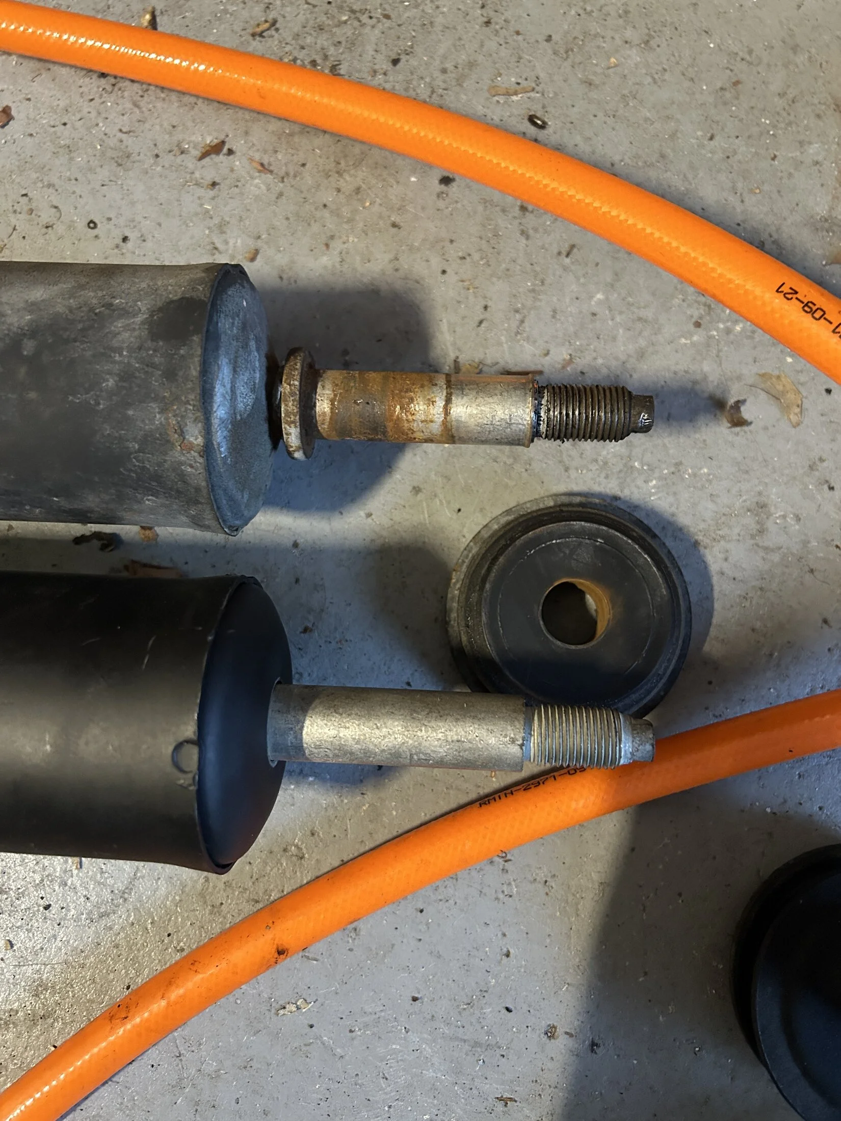

Hey again, I’m hard at work with the front axle rebuild but I also bought new OEM shocks and seem to have an issue. The new shock doesn’t have the seat / flange / perch that the circle washer goes on. Am I crazy or is this normal?

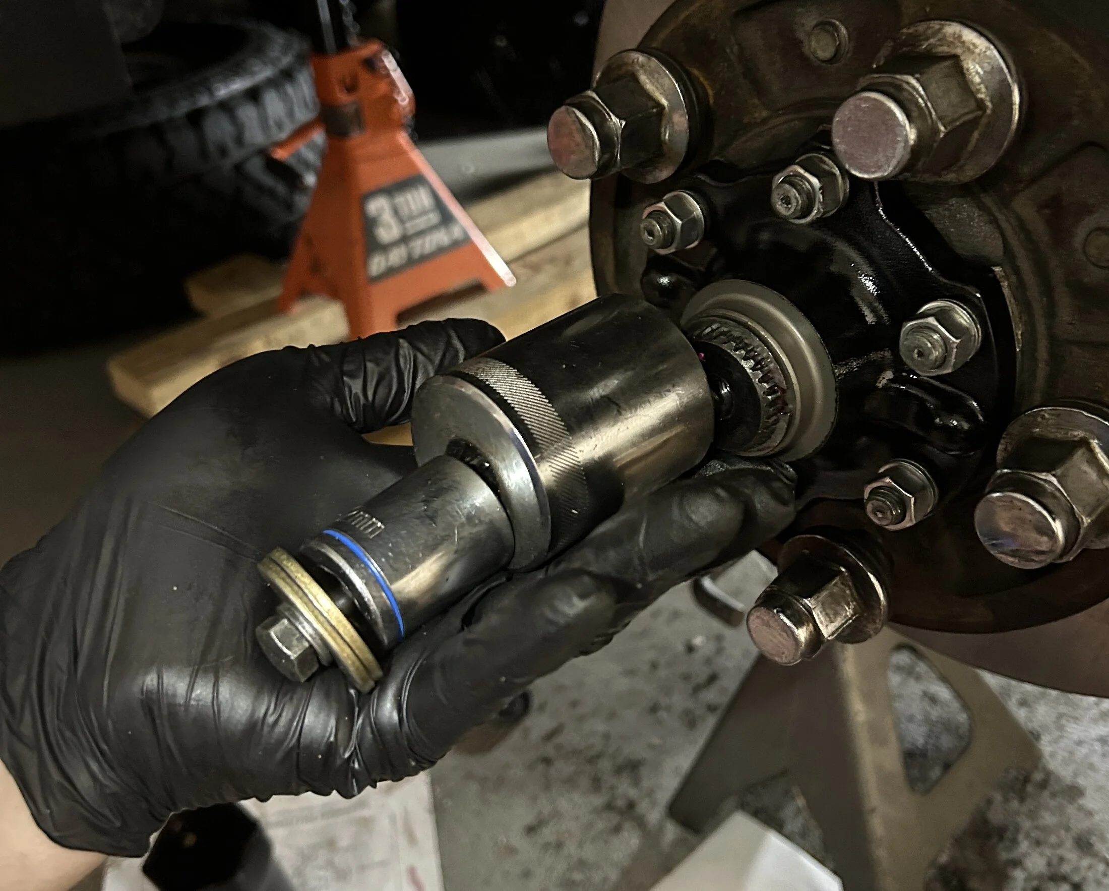

Ran into one issue right towards the end I couldn't find a way to fix initially, which was that despite every single thing in the axle/knuckle being brand new, the CV wouldn't come through the flange far enough to get the C clip on. No amount of prying with bolts and stuff like others have suggested would work for me. Probably all the brand new grease need to be squished out of the back side of the knuckle/needle bearing area.
Finally resorted to using a long bolt in the end of the axle and used a giant 37mm socket to act as like a ball-joint press style setup and after a bunch of cranking, that pulled the axle through enough to set the c-clip. Had to do it on both sides, but it worked. Hopefully this helps someone else in the future.
