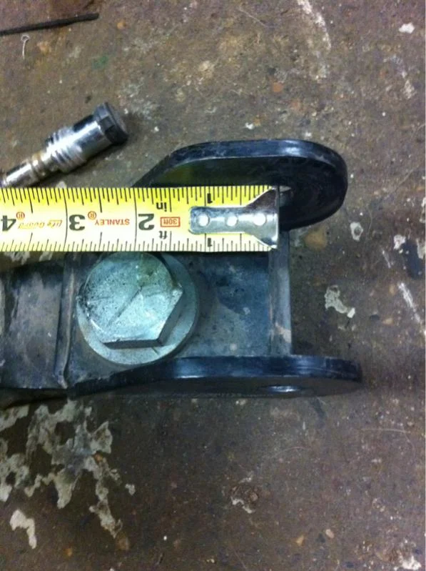

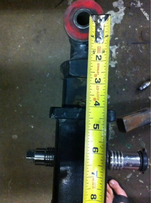

I snapped two pics with a tape for reference. Hope this helps. Look close to see the grease zerk at about inch 4. Kinda snug. The receiver is from Northern tool off the shelf and welded in. The male, I've had for years and bolted the CUAMCO Max Coupler onto it. This you must provide.
I really like my Max Coupler. Next most is to drill and weld nuts onto the receiver tube so that I can apply tension to the male inside the receive to eliminate pivoting off the hitch pin. Hope this helps.

Thank you, exactly what I was looking for.
