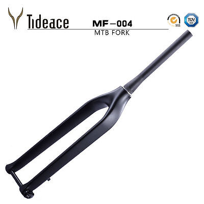

I was hoping to utilize a fork that I already have. It's an equivalent to this one.
I've stared at the Salsa Cutthroat for way to long to see how I feel about the 480mm fork look. I think I'm leaning towards just breaking out the wallet and getting a gravel specific fork. I've had good luck with generic carbon and can't justify $500 on an Enve or Lithic right now so I may look into this one. I've had a couple frames from this vendor so I feel comfortable giving it a try.
The Salsa's were what I had in mind when you mentioned the long fork/short HT idea. I think going 'full' gravel with the build and aesthetic (fork/HT length) is the way to go.
