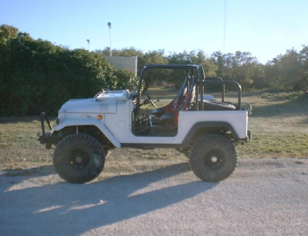

i have a sbc 350 700r4 in my 40 it is as far forward as it could be,i have a short pump spacer and a seven blade flex fan.moved the rad forward about an inch or so put a fan shroud on,made a bracket to hold the tranny cooler above the pass side of the motor so the fan blows air on it,never had it overheat offroading or rock crawling.it did heat up a little doing 70 on the hwy.

I have a 71 FJ40, 327 (TBI), TH350, 1 1/2" AA adapter, 3speed TC with vac shift.
I installed the engine as far fwd as possible. my 4 blade stamp steel fan is on a short spacer with a long waterpump. I went long because I wanted the accy's to mount close to the engine. I slotted the radiator mount holes on the chassis and moved the rad as far fwd as poss (took off the TOYOTA emblem). Rad has been recored to a 5 row, Hi efficiency core. I have my rad cooler attached to the brush guard (behind my winch).
Runs cool, AT temp shows good except for extreeme crawl conditions but never over 200. I tried flex fans, but I overheated. I got an 18" stamped steel fan from an old Chev truck and it works great. I did build a shroud.
Pic is of shroud area before the TBI.
