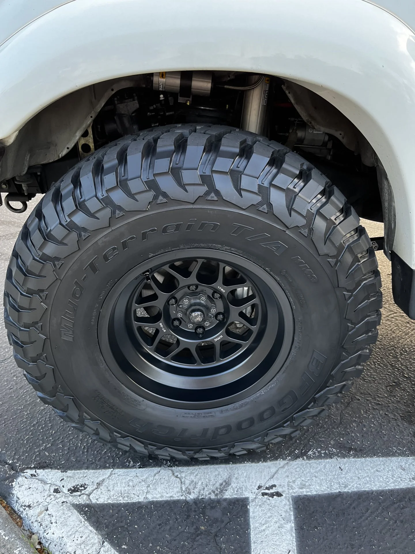

3) Per pic, those old school Duratracs are quiet and reputable ATs, but tire tech continues to evolve at such a rapid pace it may be time to get the latest and greatest. The trend is MT tires with hwy mannerisms like an AT tire while retaining MT ruggedness (e.g. BFG KM3s). Hard pass on hybrid tires. You get all the MT weight without the MT tread while still being louder than ATs (e.g Nitto Ridge Grapplers).

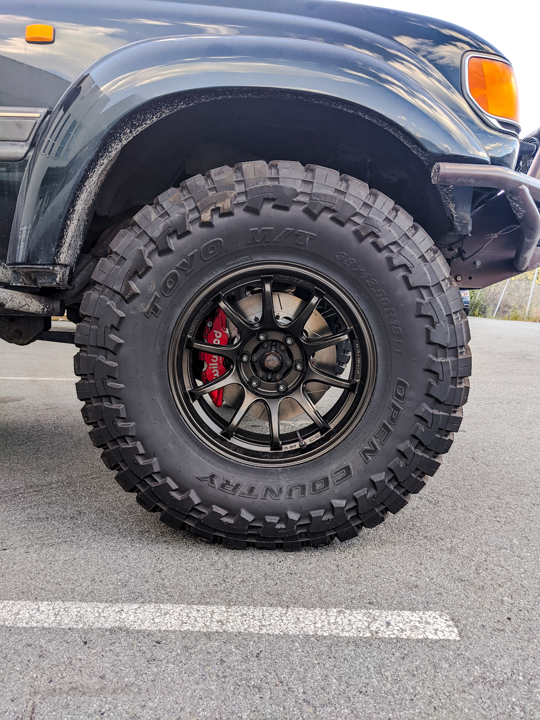

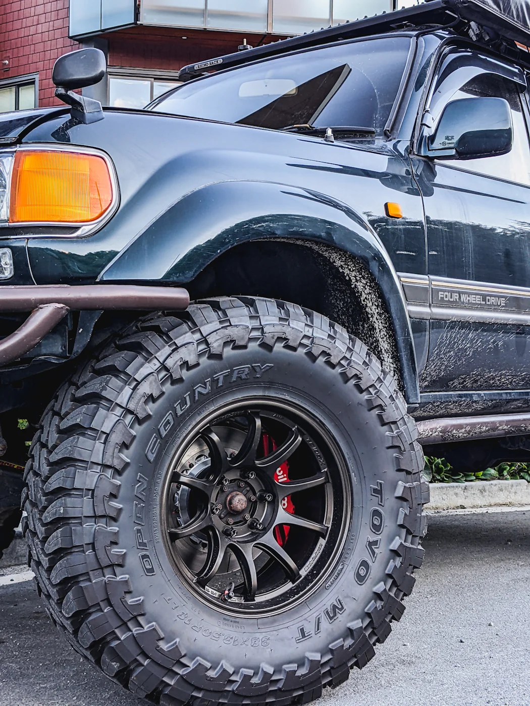

In my eyes, would look even better with more tire, less sidewall aka 17s v 18s. Those aftermarket brakes would look even more filled out. You get more bang for your visual buck and less tearing up of your 80.
38x13.5r18 have more volume than 37x13.5r17 ;) Same amount of sidewall.
Also my brakes wont fit in those KMC Terra's
You're making my point.
I don't like Wilwoods, but gl with that kit! I'm def in the market for a well sorted brake package even if it means potentially giving up my deep dish KMCs.
