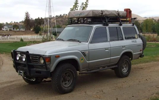

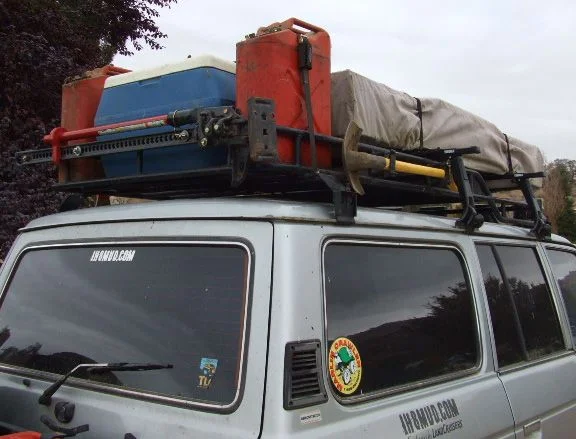

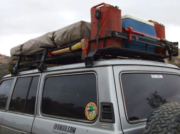

Here is what I did.
The High lift is held on with 1/2" bolts welded onto the frame and nuts. I use nyloc wing nuts to secure it.
The shovel and the axe are heavy duty conduit/pipe brackets welded onto the frame. I use a metal strap with nylock nuts to secure them in place.
