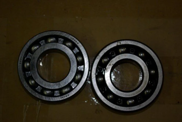

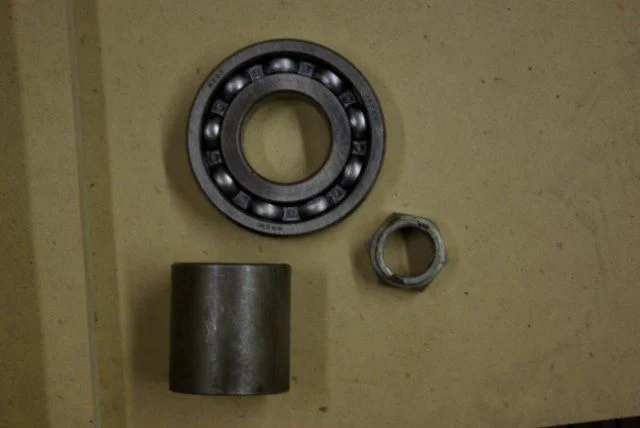

Tcase bearing(pic 2) from cruiser outfitters

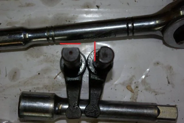

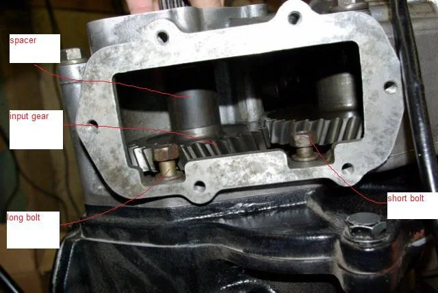

Tcase to tranny bolts and output shaft nut (pic 3 ) Longer bolts from 4 speed tranny. shorter bolts from 3 speed tranny cruiser parts.net

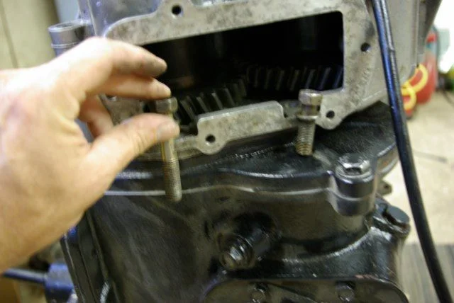

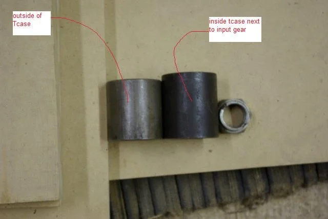

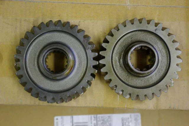

Spacers instead of PTO gear (pic4)

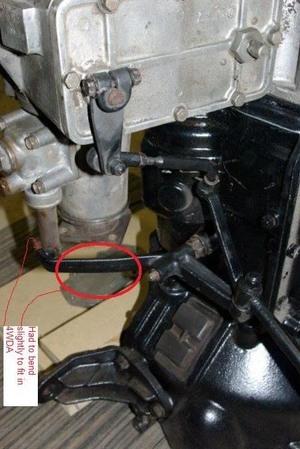

4 speed shifter linkage.. cruiser parts

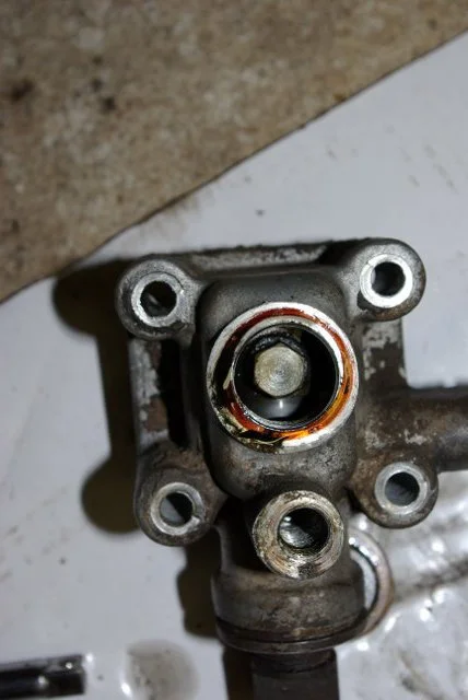

4speed hi/low shifter mechanism (pic 6 ) from a 4speed case

2.bearings

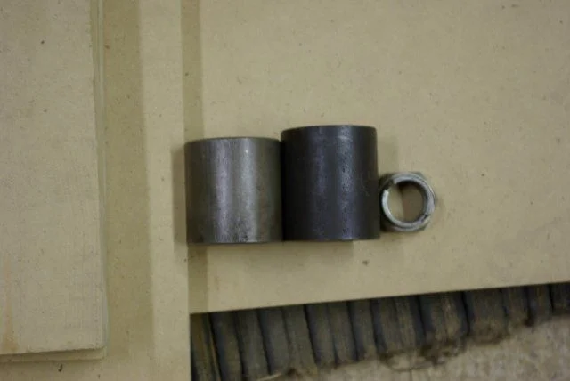

3bolts/nuts

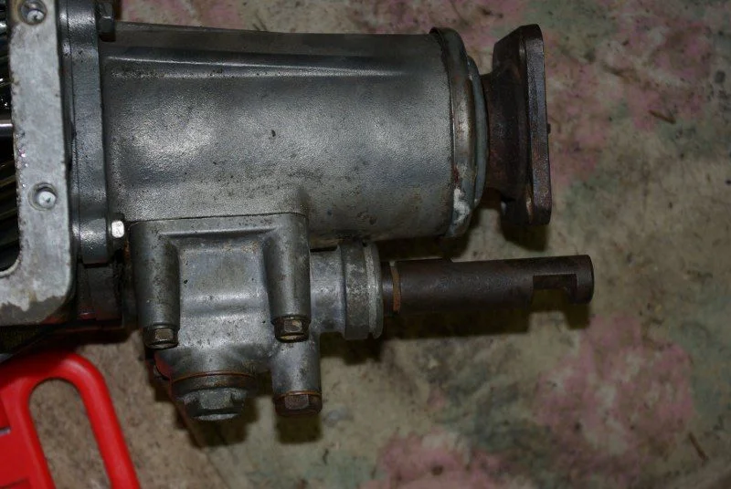

Spacers
pic 4 spacers

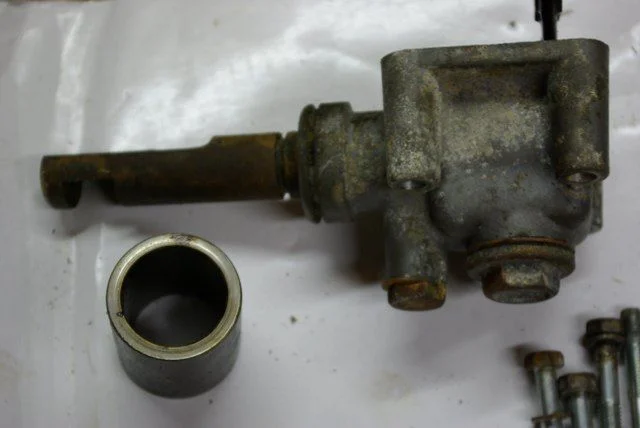

Hi/low shifter difference
the angle of the hi/low shifter is different for a 4 speed to a 3 speed tcase. I swapped the 4 speed shifter into the 3 speed Tcase.

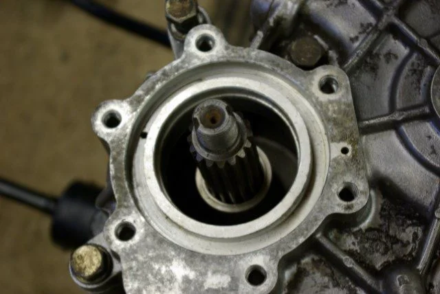

Shifter mechanism from the bottom to show difference in orientation(pic5)
4speed hi/low shifter (pic6)

Shifter linkage
The entire shift linkage was also replaced pic 6 shows the 4 speed linkage to be used. For now it back to work :D I will post all the install pics later today.

Placed spacer(inplace of old PTO gear or spacer)
Bolt placement 3 long bolt on outside of Tcase, 2 bolts inside case see pics for size
bearing
Placed new bearing on tranny output shaft w some 90w oil. It is a tight fit. I used a brass drift to tap the bearing into place. I made the bottom of the bearing flush with the inside of the Tcase?? there was still some play btwn spacer and bearing inside the case???
Placed shorter spacer on outside of the bearing then washer and then nut.

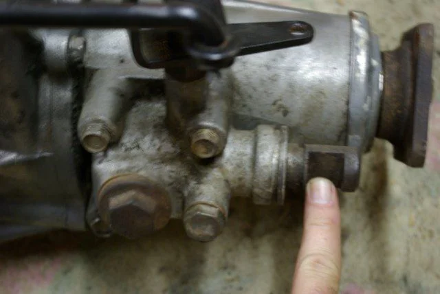

1. pic of 4WDA off nose cone

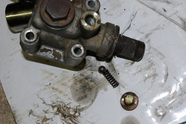

2. pics of accuator parts (took appart to clean) this is acually the 3 speed accuator forgot :doh:to take pics od 4 speed but they are the same inside Ball bearing and spring are under the front bolt
3. pic of second bolt in the accuator that when removed allowed removal and cleaning of the shaft and insides ........Others have said you could place the 4 speed accuator shaft in the 3 speed and it would work....... I did it for fun and it worked then I changed it back.:hillbilly:

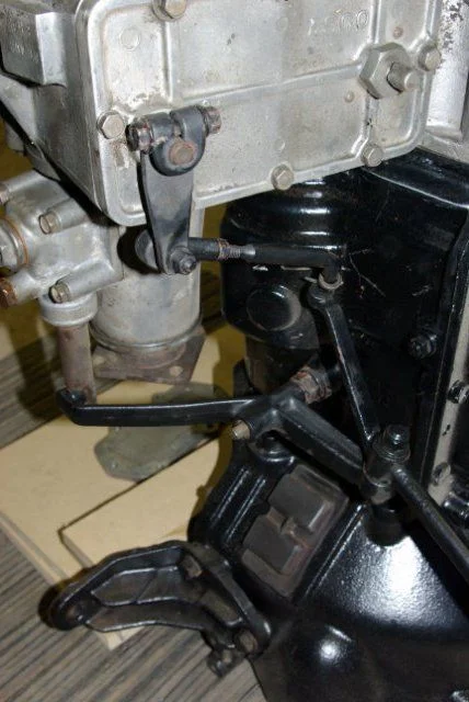

Shifter linkage
Last step:bounce: I removed top cover of tcase and put the 4 speed high/low shifter in the top cover to create the correct angle for the hi/low shifting linkage
Pics of linkage from different angles. With labels
