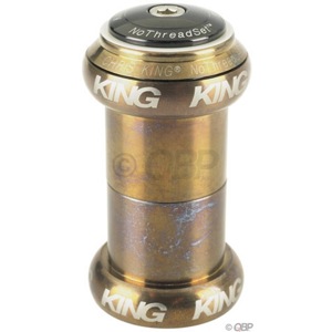

My question is this...............the current headset is by Aheadset. Is it worth upgrading to a King headset while I have it apart? If I remeber correctly, King headsets were supposed to be awesome.

IMHO, King stuff, while the best, is way overpriced. 90% of the performance from a headset comes from properly facing the headtube so it is perfectly square. Buy a Cane Creek S-3 for $30, install it properly and never look back.
BTW, I have a king on one bike and ironically, it is the only headset I have that has a rough spot.
I won't try to talk you into a King and get flamed over it. You definitely want to replace it with something. The Cane Creek HSs are nice and she'll probably never wear it out.
That said, the King headset on my Titus is 8 years old, on it's third bike and functions as new.
Use a metal t-square to be sure that it's properly faced. If not it's worth having it done for $15 or so at a shop. It will save lots of creaks. If there's paint on the edge of the head tube, it probably hasn't been done.

King HS is best. I agree with Fast Eddie's points...
I have king's on a few bikes and they can last many years...I have used them many miles in lots of mud, (new england), and no problems ever.
I ride a lot, race MTB & Cross and have done some road too.
If you want a HS that will last 10 or more years and need no adjustment once set up properly, get a King. If you want to save a bit of money and replace or service one every 2-4 years, (depending on miles and trail cond.), get a cheaper one....Just like anything else I subpose.
Cary, take yeor king apart and clean it, also look to see that the cups are both seated on a faced head tube. It could also be that it is adjusted a tad too tight.
* Muddy conditions can ruin most any HS, EXCEPT KING. If you are West coast and avoid mud, most other HS should be OK.

I know people want to say, oh great, a king lasts 10 years, but so do many other headsets. There are a lot of guys that have been running Cane Creek's for 10+ years. Very few headsets fail, and those that do are usually because of bearing contamination. IMHO, King stuff is way overpriced and I have one of their headsets and a set of their hubs on one of my bikes. If you ride in really muddy conditions ongoingly (pacific northwest, alaska coast, BC) then there seems to be difference because of their extensive sealing, but otherwise it is a waste of money.
Chris King headsets are overrated unless you trash, and I mean, are really really hard on bikes like I am and use a steel set to get more area on the head tube to add strength and keep in from ovaling out and eventually ripping off. Lots of companies are now making the head tubes a lot beefier and will not accept the steelset
Picture:
Like said above, any headset that uses a cartridge bearing is a quality unit, cane creek is a good example. I have also had pretty good like with the Pig from FSA.

Chris Kings rock but may be overkill, depending on how aggressive she is and the conditions you ride in. Cane Creeks are sweet, too, slightly less money and will perform fine if you're not a crashing, hucking, abusive rider. My wife's full carbon Trek Fuel has a Cane Creek and we've had no problems for 3 years and we adventure race, 24 hour race, etc.
