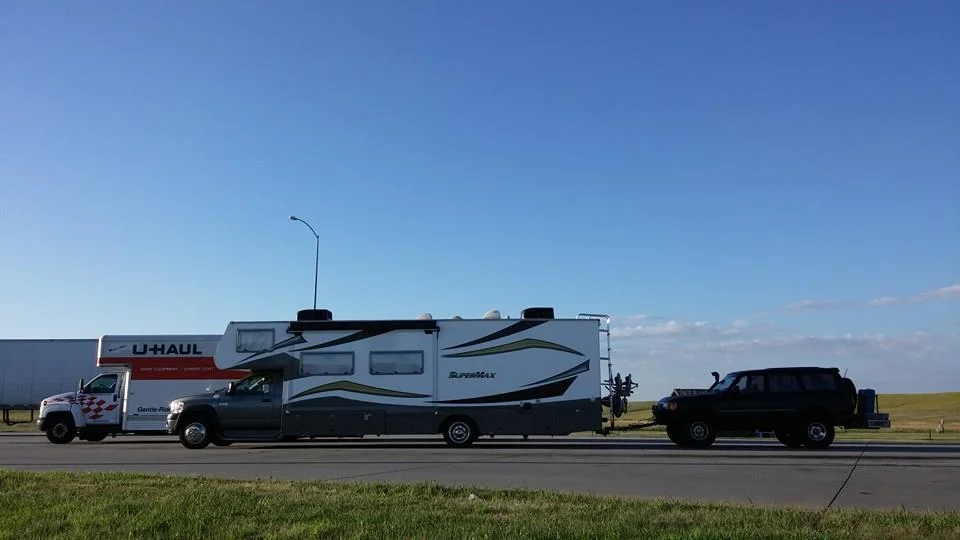

Motorhome towing an 80
TCASE Neutral/ Tranny in Park. I detail what I do in my other thread.
Recent shot, different rig

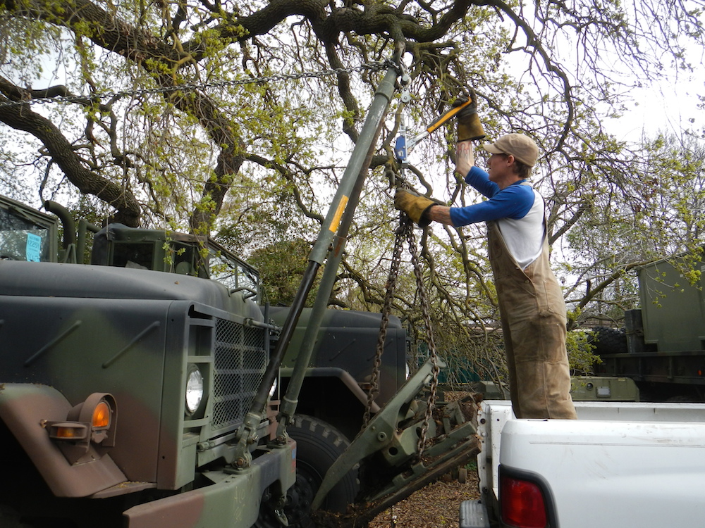

Muds a great place, we are mostly here to help and partly here to give each other a hard time! I'll update my other thread with my baseplate setup pictures. I've seen Blue Ox's military tow bars! Over kill for 10,000 or less rig like ours. Share A picture of it in tow when you get it set up. Definitely something you never see behind one of those rigs.
