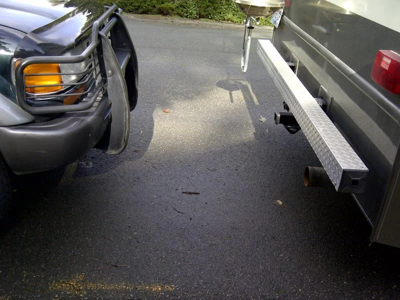

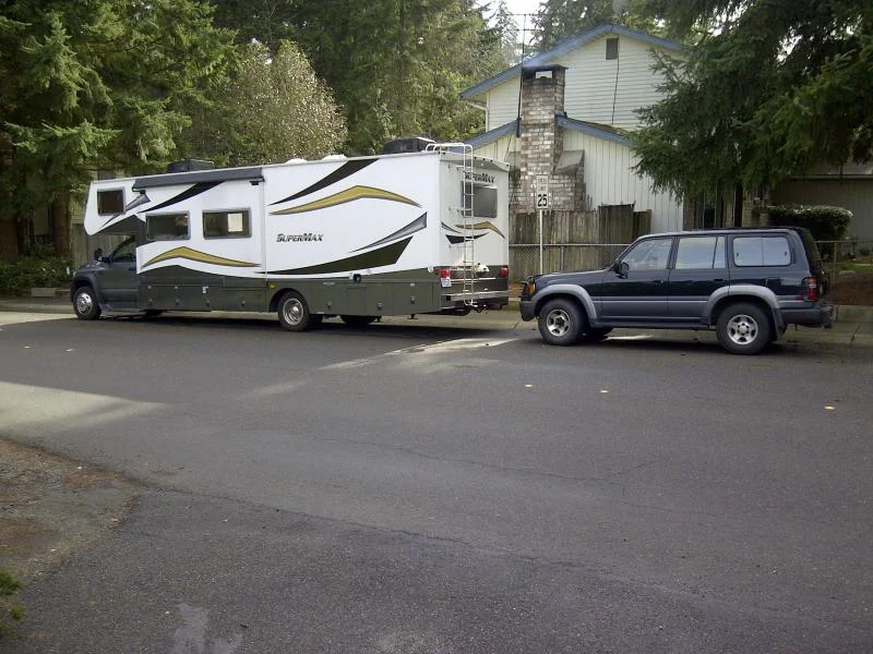

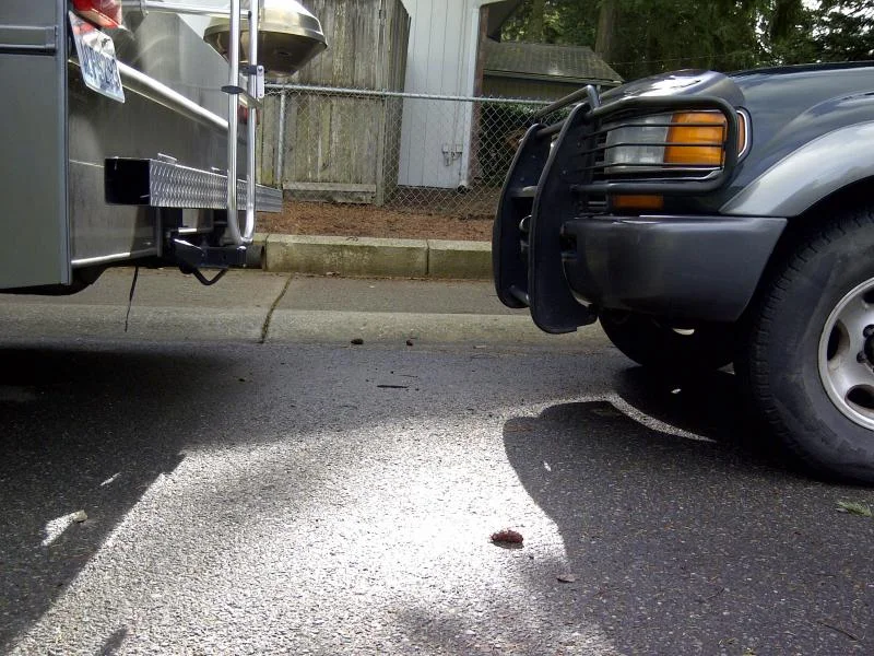

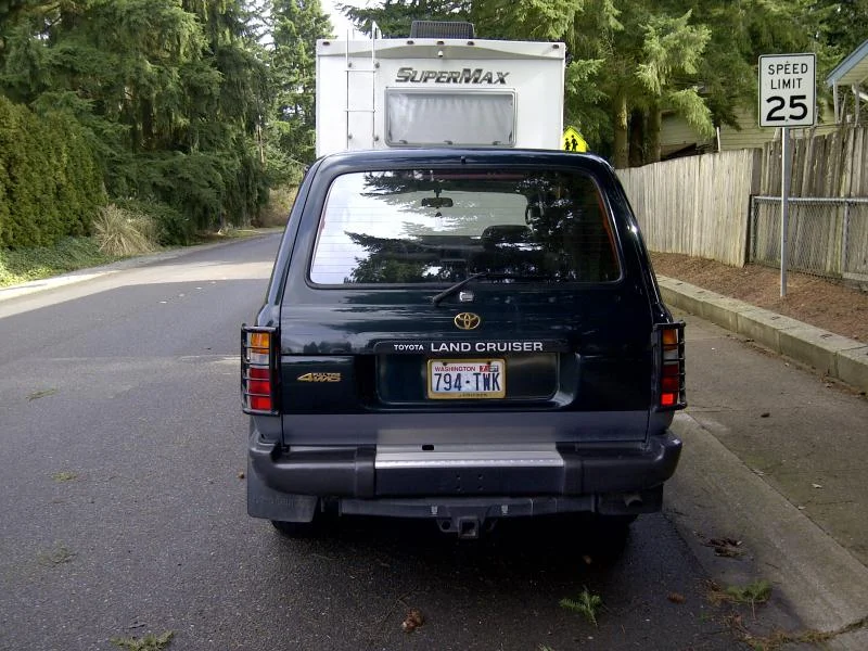

Done some research on an 80 Toad setup and hope this helps someone.
Recomendation is to go with a 10,000lb towbar.
I'm currently looking at the Blue Ox Aventa LX No. BX7445 10,000 lb towbar
Per the Manual, you want the Mounting plates no lower than 4" below the receiver.
(you can download the Manual from the link below)
Blue Ox Aventa LX Tow Bar - 10,000 lb - By Blue Ox
Picture One is the whole enchalada.
Picture two puts me right where I need to be
Picture Three is what you will see following me.
The Landcruiser Shown in the picture is NOT mine and was not hurt in the mockup process.
They make Mounting plates specifically to each vehicle... however I'm yet to source one for the cruiser so what I will likely do is get a (non arb) WENCH:hhmm: steel bumper and custom mount Plates that likely go to another large vehicle to the bumper.
Still working out the brake controller and lighting, but need to do it on the cheap. All parts will be researched and then bought 2nd hand on ebay. Brake controllers (when used) should be rebuilt (for peace of mind) and can be done fairly cheap from what I've read.

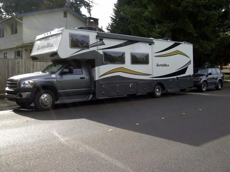

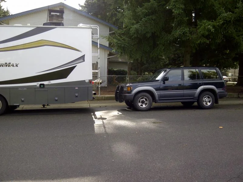

Few more shots

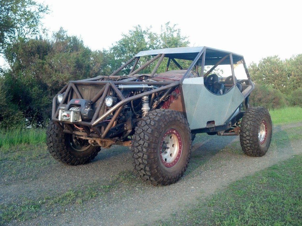

Read through all the flat-towing threads I could find and there's a lot of conflicting info. Tuner's experience seems to suggest that it might be okay in spite of Toyota's warning to the contrary. Planning on flat-towing this truggy behind one of our 5-tons, like this, using military surplus towbars. We've flat-towed a bunch of vehicles using them and they work great as long as you've got 3/4 or 1" shackle mounts on the vehicle being towed. Here's a link to some more info about the towbars if anyone is curious.
