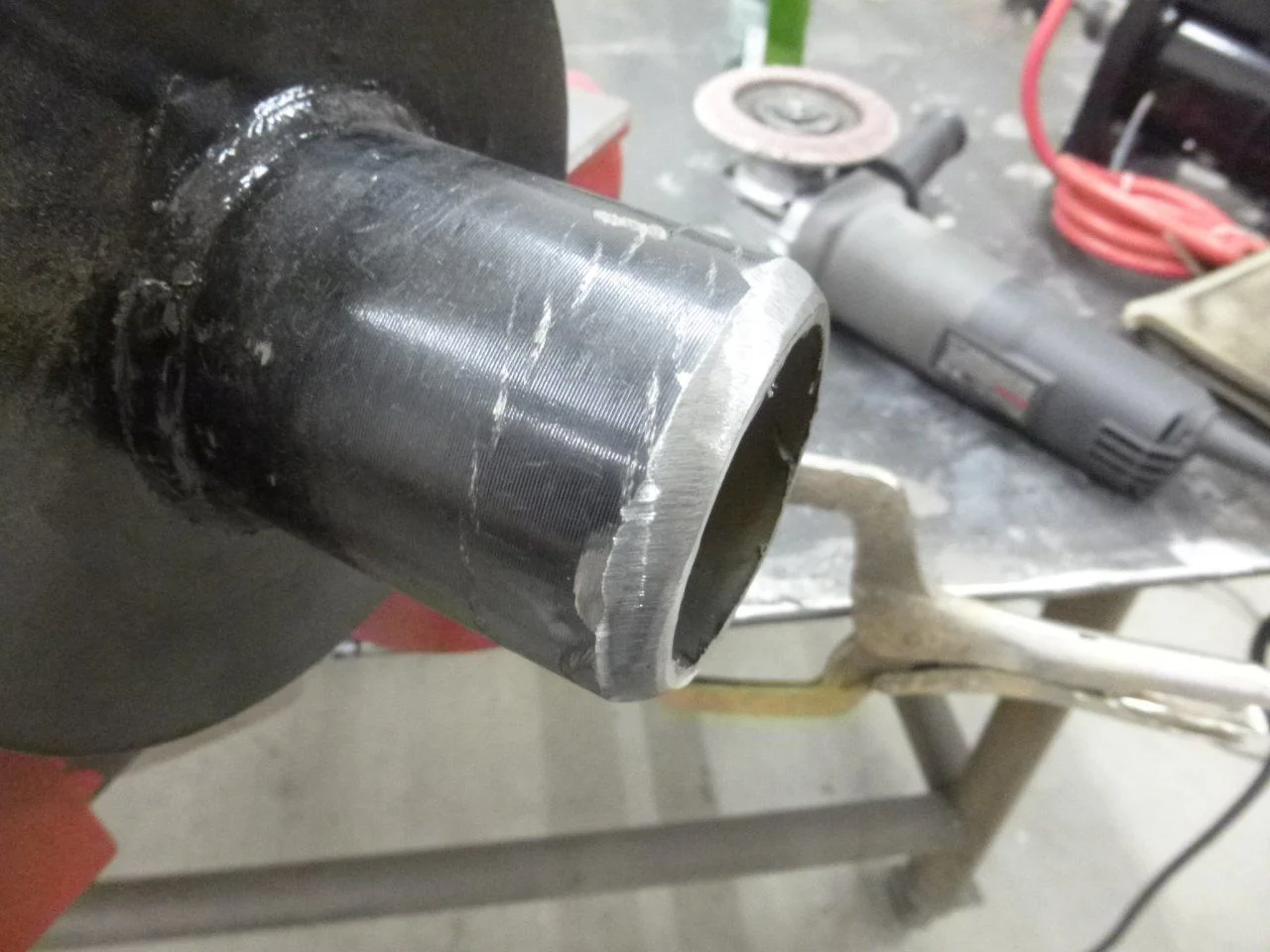

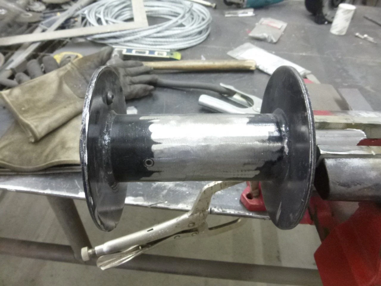

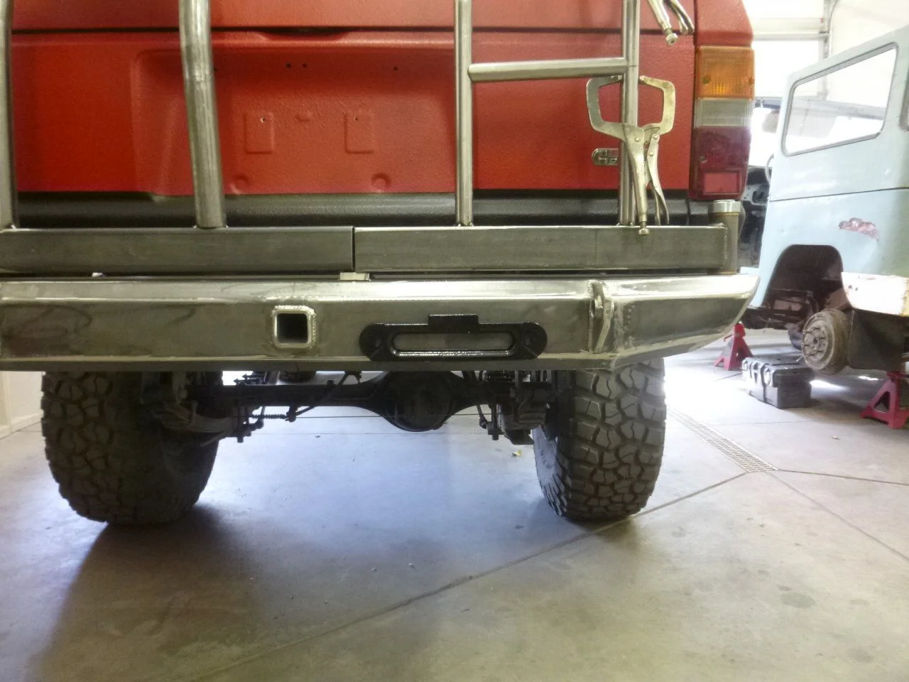

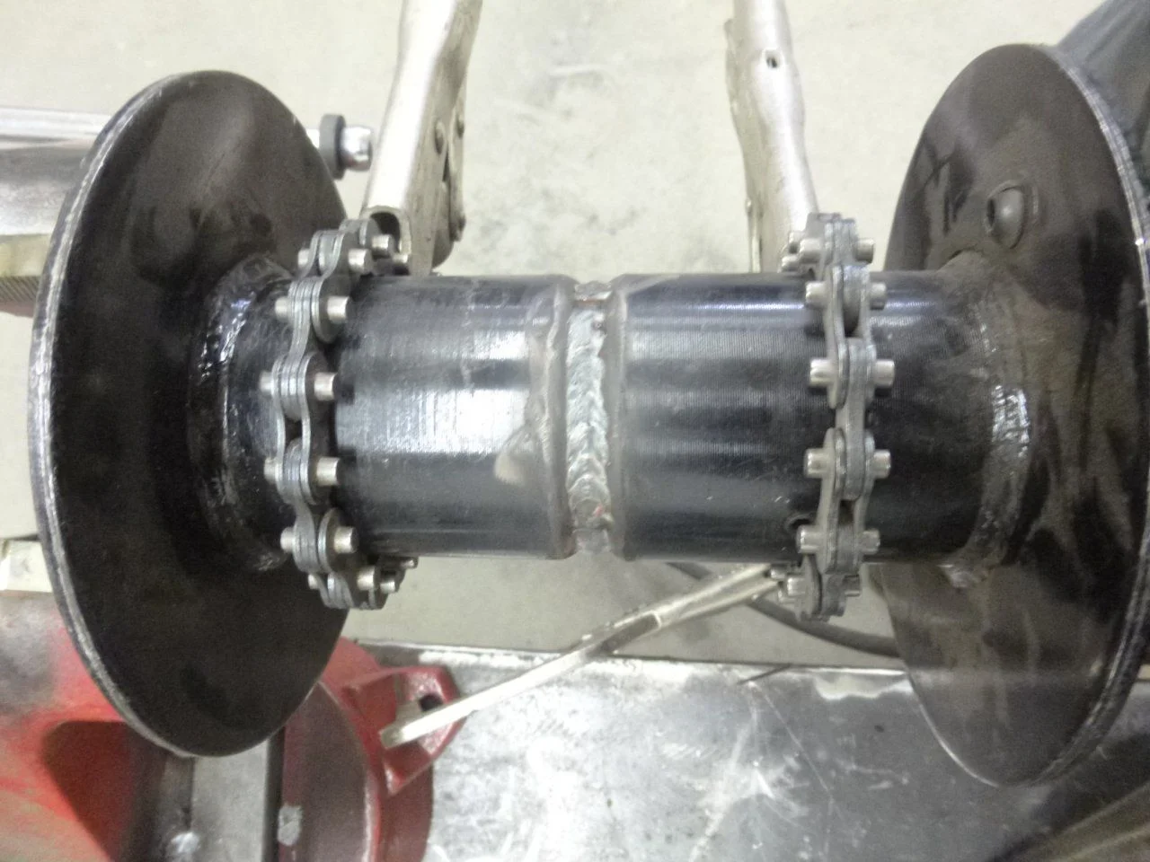

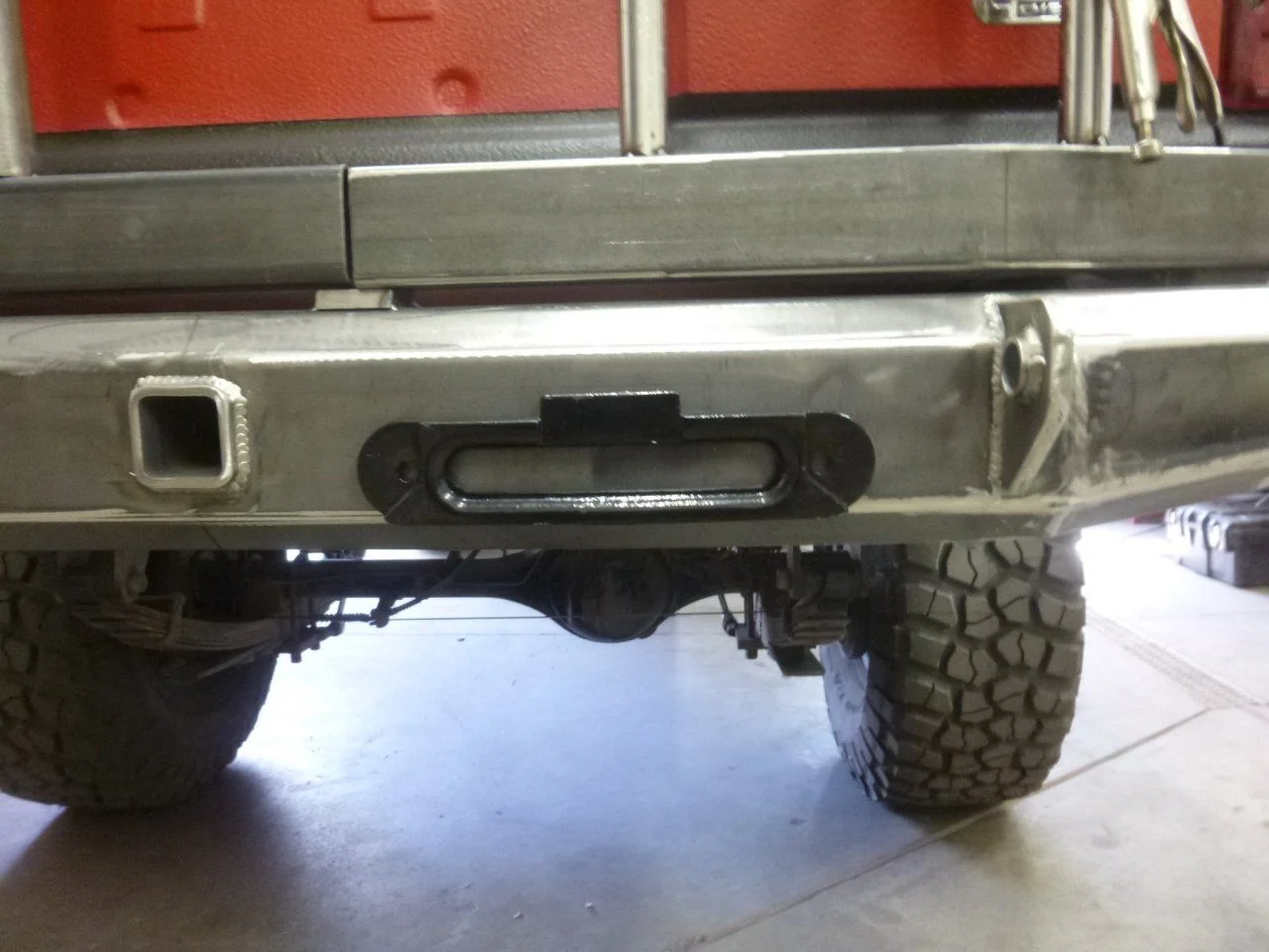

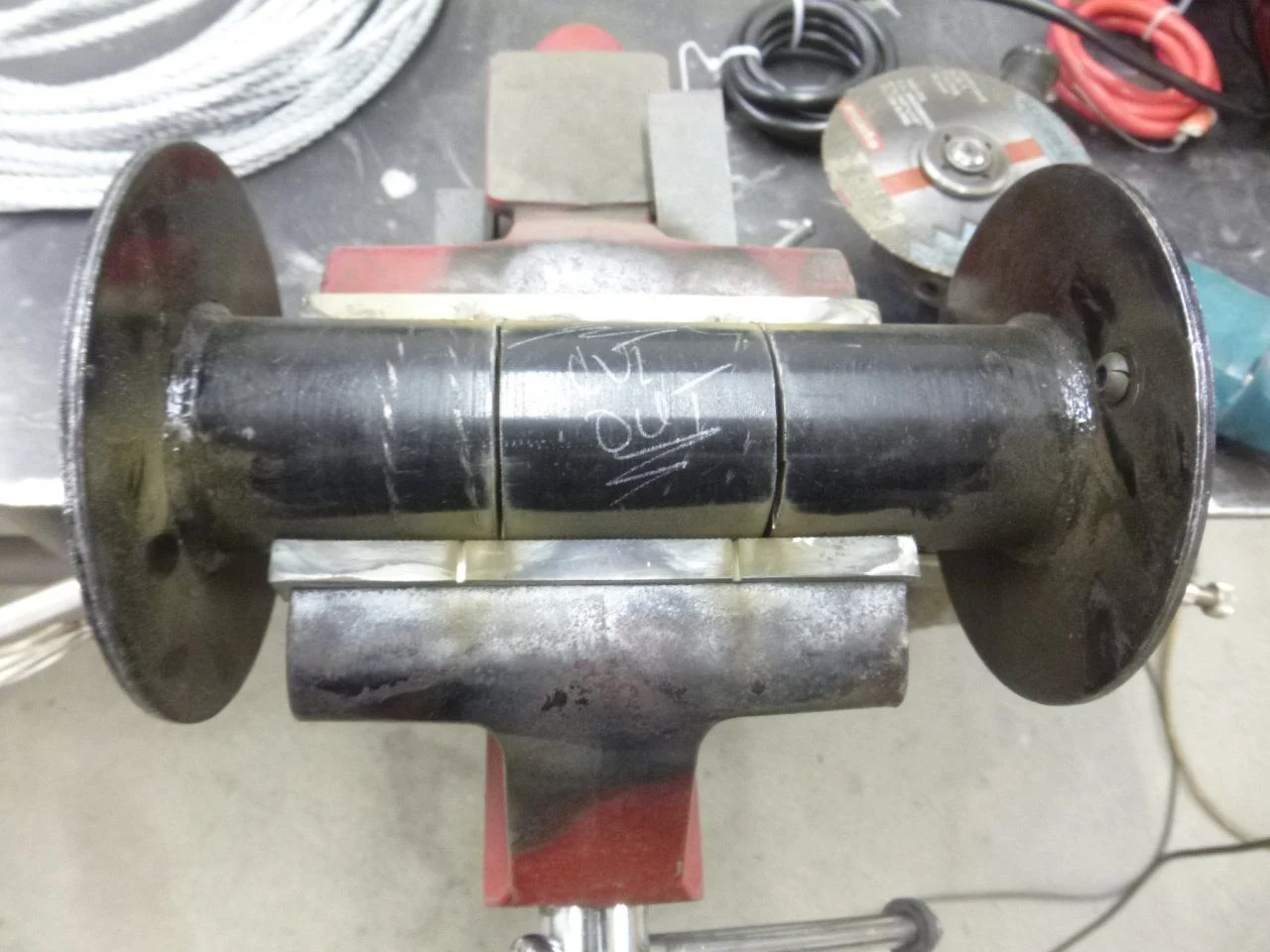

I need to find a really compact winch for a rear bumper build. I'd like it to fall in the 8K range if possible.

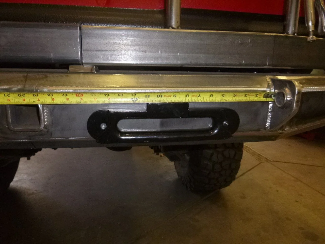

I have a tight 18.75" between my receiver hitch and frame mount I have built.

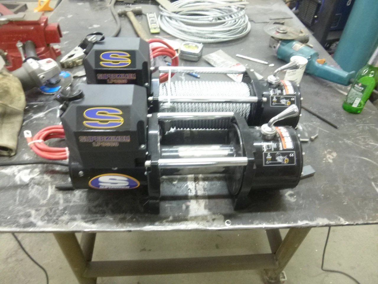

Any ideas? Superwinch, Warn etc.. are all wider than this in a 8K winch.
Here is what I am trying to do and be able to offer this set-up to my customers as an option for the 60 series bumpers.. Plan on doing this for the 40 and 80 bumpers as well...
Thanks for any help guys,
Jason
I seem to recall that Hickey Sidewinder winches were under 18 inches wide and 12 inches deep. Built in the 70's but would seem to be very rebuild friendly if you found one.
