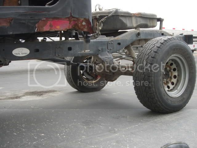

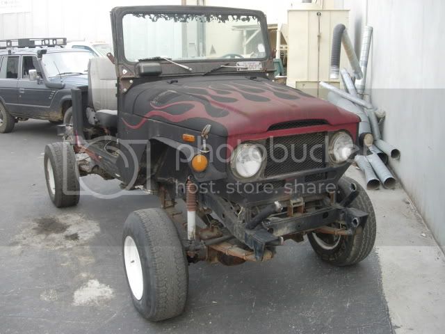

Here are a few pictures of what I bought. I initially went after just the axles because of the rear disk conversion and installed arbs but my addiction got the best of me and I bought the whole rig for cheap because it has a ’89 3FE drivetrain in it which means I now have a whole extra drivetrain to either rebuild or store for insurance in case I blow anything I am currently running.
On with the Pics!
Here’s what I bought to part into my rig.

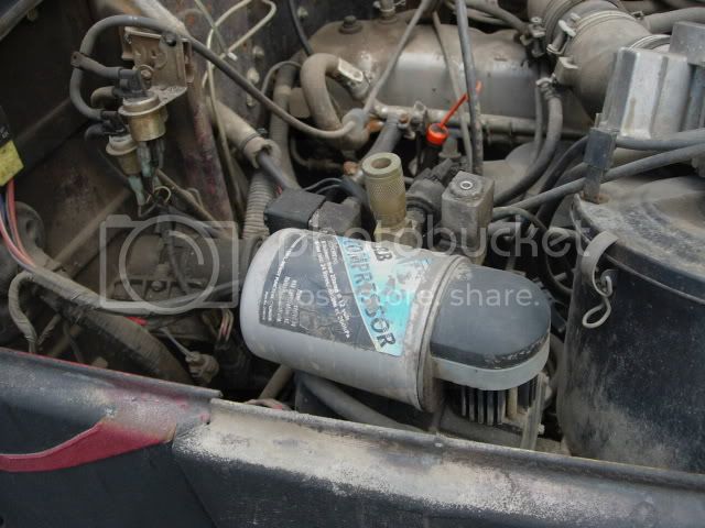

ARB compressor (includes wiring harness, switches, and everything.)

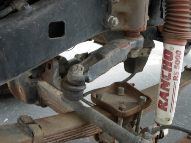

This is a shoddy welded steering arm which will not be reused. What’s its appropriate name and what’s the best replacement?

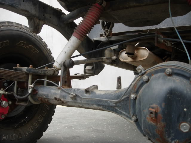

P.O. put on two shoddy traction arms, one busted off and here’s the other one. Again, this will not be reused. A proper Ruff Stuff kit will be used.

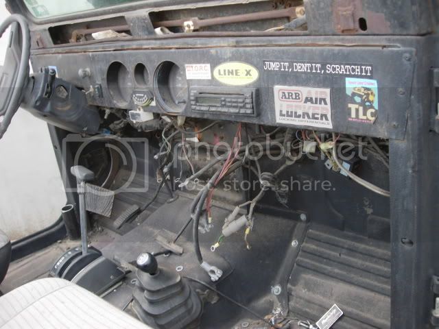

FJ40 Dash with FJ62 gauges.

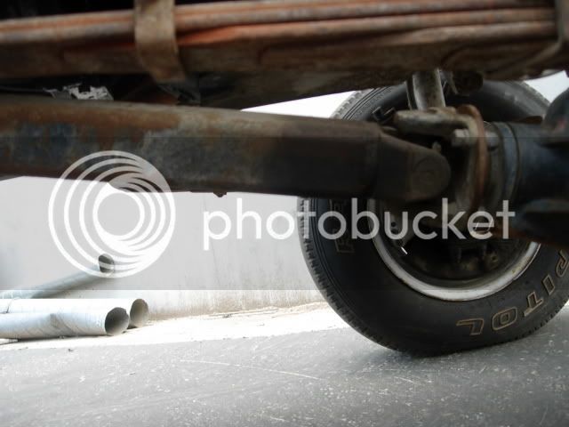

Trailer hitch receiver tube front driveshaft. Probably will keep this as a trail spare. I like to use my 4wd at high speeds and this just won’t do. I could be convinced to sell cheap if someone really wants it.

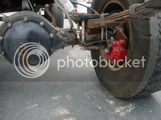

Rear GM disc brake conversion. TSM I believe is what it is called?

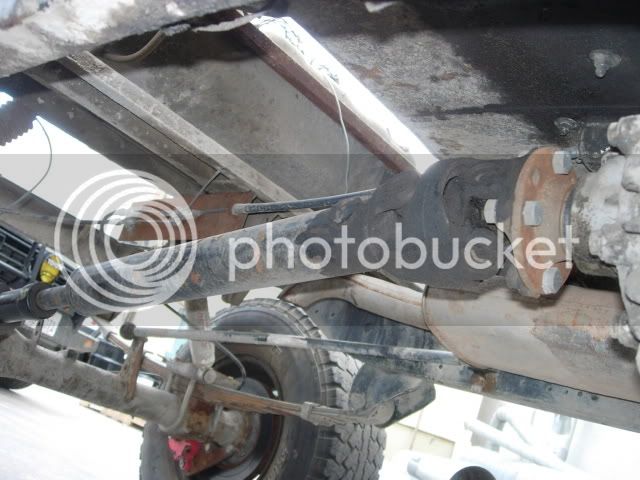

This is the rear driveshaft I will transfer over to my soon to be SOA rig. Can someone confirm it’s a DC shaft? I am unfamiliar with a double U-Joint driveshaft. Not what I consider a conventional CV shaft.

Yes, that is a DC joint
Yes, the frame, drivetrain, and axles were from an 89 Fj62. An FJ40 tub was then put on top of it.

That's a cobbed together mess. Glad you'll give it a better home. That Pittman arm is an accident waiting to happen. If you'll glance at my SOA thread, you'll see a cool Pittman arm solution that maximizes your clearance. You need all new steering linkage, that stuff there is just not usable. I can HIGHLY recommend the tie rod and drag link from 4x4Labs.
What is being used for steering arms? Can you post a pic of the knuckle?
Based on what I'm seeing, the axles look good, the ARBs are a real plus and the rear driveshaft looks custom and expensive. It is double cardan as mentioned. A very good deal at what you paid. Congrats.

Given the butchery of the previous build, I would consider cutting off the perches and doing your own. Really, that is an unsafe redneck mess and I would make a fresh start.
That e-brake connection looks funky at best.

I agree with you on the workmanship. It's a clodded mess. Fortunately he had the gears done preofessionally. I forget who but he didn't touch them. When I regear i will have the o-rings replaced. Mark also mentioned that and I agree with you both. New perches will definitely be done. I may even use my stock axle and rebuild the whole front end. We shall see.

Where is the cheapest place to get an 80's pittman arm? I just went through your thread and post on this Drew and it looks like a good substitute.
Probably a junk yard. They are available new as well.
If you want an FJ60 Pittman arm bored for 1 ton GM ends, I'll send it down to you. That at least gets you mobile while you look for an 80 series Pittman, assuming you use the GM 1 ton stuff. If you use 80 series ends, you best bet might be the Pittman arm from Marlin, that has a little less drop than FJ60/62 and comes bored for the 80 tie rod end. I think just the Pittman is about $75 or so.

Post a pic of the knuckle/steering arm set up. That's kind of critical to your operation here!
