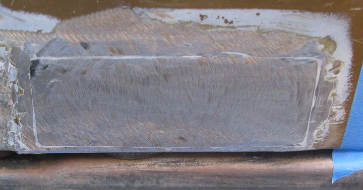

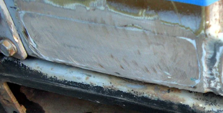

This was there when I bought it. This one had almost no change after 2.5 years. One of the four along the back did get bigger.

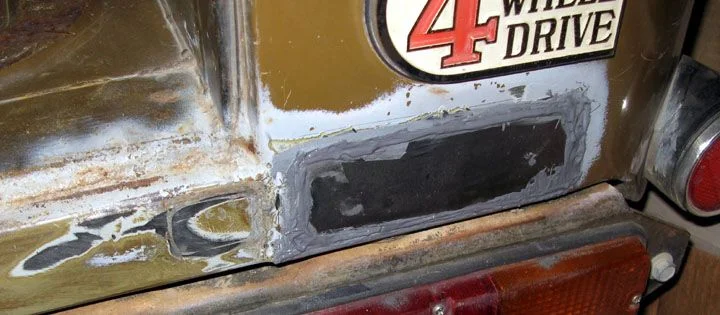

This one is right below the 4wd emblem on the right rear of the tub, '78.

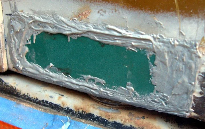

I used a high-tech metal bonding agent :coughjbweldcough: instead of welding. There would always be some exposed metal between the layers of the tub after welding. No moisture can get between the panels this way. I do have to use a little bondo to make it come out perfect. :meh:
I didn't take a picture of the repair before bonding. It was clean and shiny inside, and as far around the cut as I could reach with a dremel cut-off wheel. Then I coat all surfaces with bonding agent and use JB Weld putty to space the new piece out if necessary. This repair has a bit of putty on the left, but none on the right.

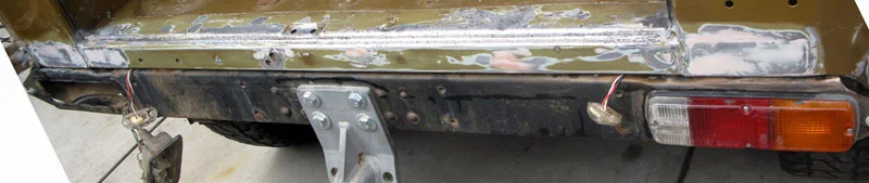

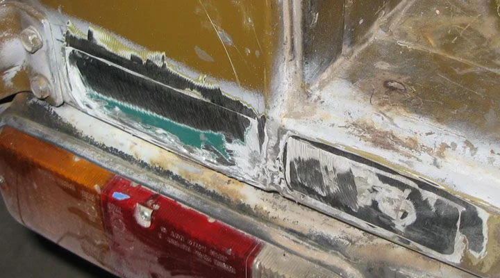

The 2nd and 3rd photos are of the repairs on the other side before and after some grinding. I hope the one on the right comes out as perfect as the one on the left. You can see my first repair in the first picture. I saved the largest and most-exposed repair for last. It was the first repair I had to use non-Toyota sheet metal.
I suppose I should've waited for finish shots before posting. After using this method to restore my bib, I'm confident this will look perfect and last longer than a welded repair. Credit for all the crappy gray primer to my PO.
