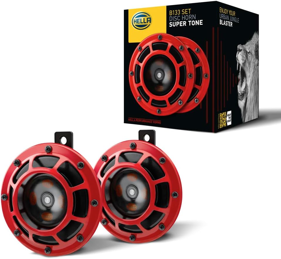

Well........ I found the old horn set that came with the truck and swapped them back in. All is now good. My 135 day old Hella horns developed an internal dead short. I know other have had luck with these, perhaps I got a bad set.
https://www.amazon.com/dp/B000CRZXPI?tag=ihco-20
