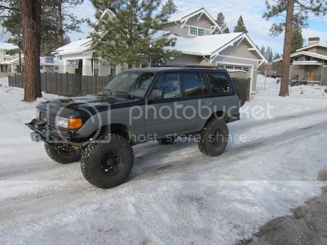

I have two 80's in the driveway right now, one with raptorliner and one with monstaliner.
Based on what I remember the raptorliner seemed a little thinner, but I preferred the monstaliner kit, and think it's a little smoother. These are both rolled on. Sprayed looks much better.
Pics from today...
Raptorliner:
Monstaliner:
