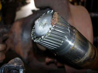

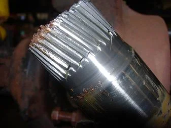

just off the phone with Poser....sounds like 1% bit his ass too...busted a 35-spline 4340 rear on his 9" and then a front inner as he was winchin out. exited in 2wd and double-lineing...

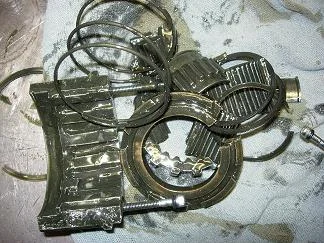

An autopsy of the rear axle revealed that a Warn internally splined lockout exploded.

After talking with a couple people that were with when C broke the inner on Brian's front, I found out that I was in the same spot when the rear lockout let go...only thing was I was on top of those rocks, and not wedged in anything...when the lockout broke, it also damaged the splines on the axle..so I need at least one new rear axle....and some poly drive plates I guess... ;) maybe Dave can get them in the same box as the 12" sway aways... if Jack at CTM has any 300m around there, I may go that route...and Fing spares!!! I had spares made when I did the original full float 60 that was under the truck for six years, had spare 35 spline chromo axles, lockouts, drive plates, and had no issues with it at all. Guess I was beyond due really though...

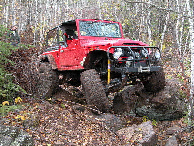

Good Gawd thats some K-Karnage. Wish Zilla could have been in one of those pics.
I think Russert broke in the same spot...Inner Axle, Hub, birf and a rear spring pack.... Quite a gate keeper. I think I will stay in the 99% percentile.... That hill sucks ass.....nipple

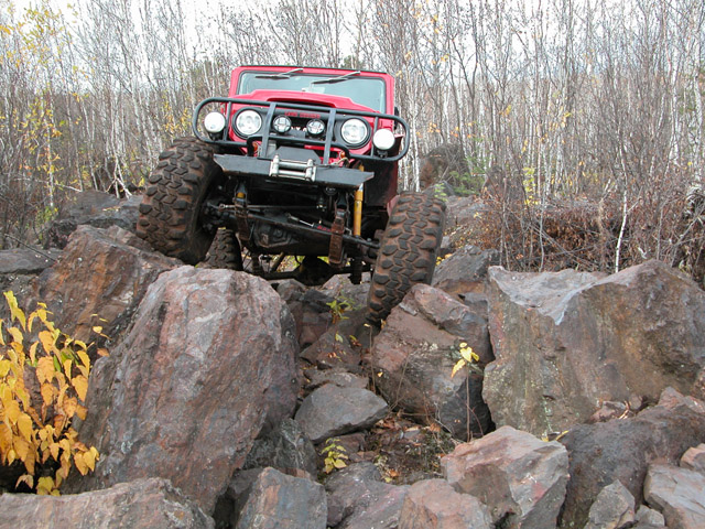

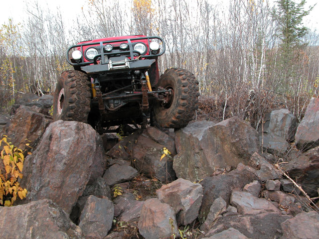

He stacked rocks the entire way. Did not want to ding the bling....
I had to winch a bit at that spot. Hung front and rear, and bound up real bad.
