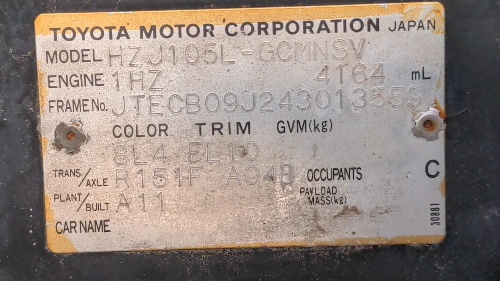

Some of you may have seen my posts about the white 2007 105 that just got shipped to Canada where it will live until I can import it into the US. It so happened that on the very same day I took delivery of my next, more challenging 105 project, a 2003 diesel 105 that again was a long-serving UAE government truck.
The Farmers Services Centre seems to be roughly equivalent to the U.S. Department of Agriculture, near as I can tell.

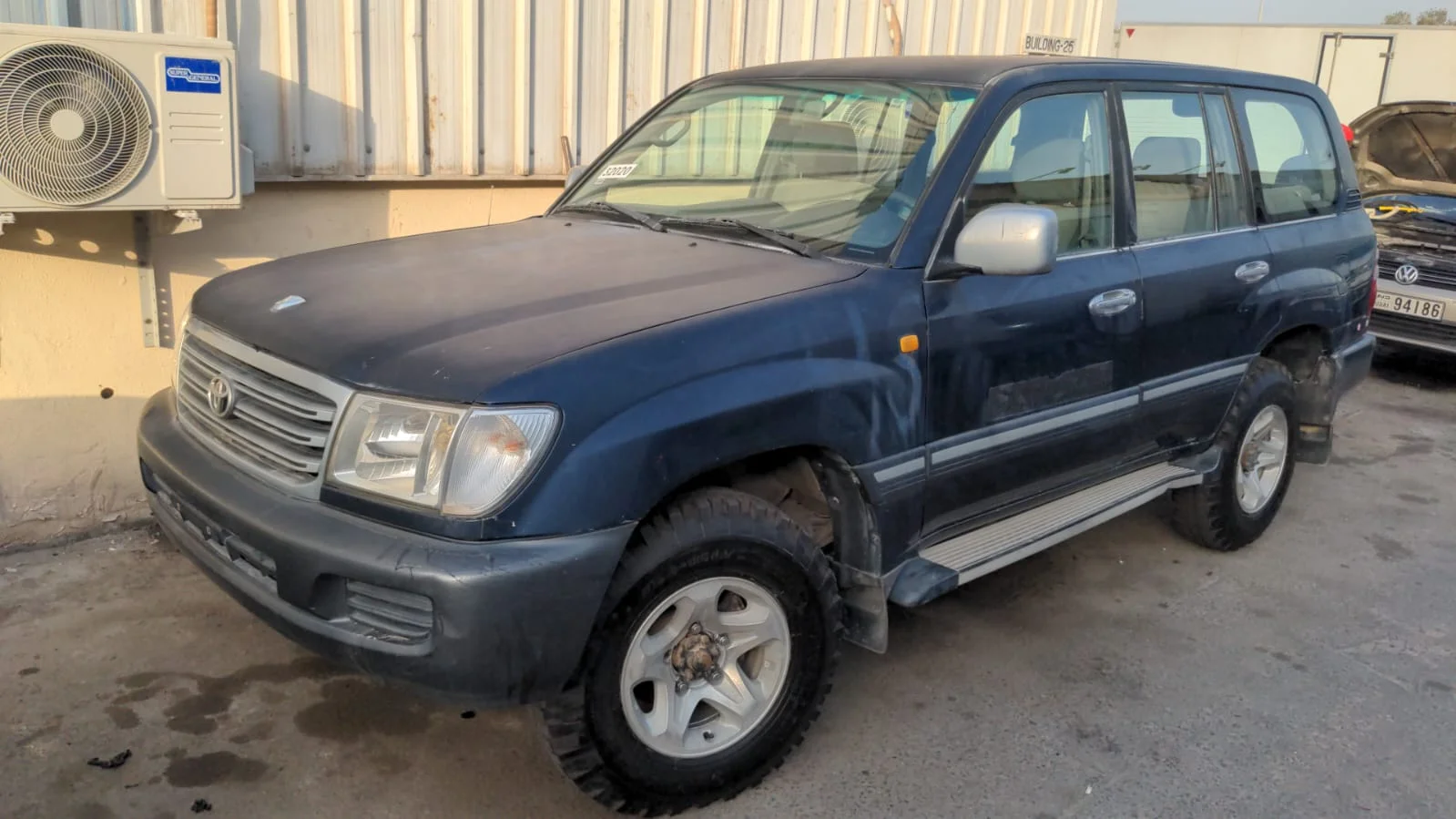

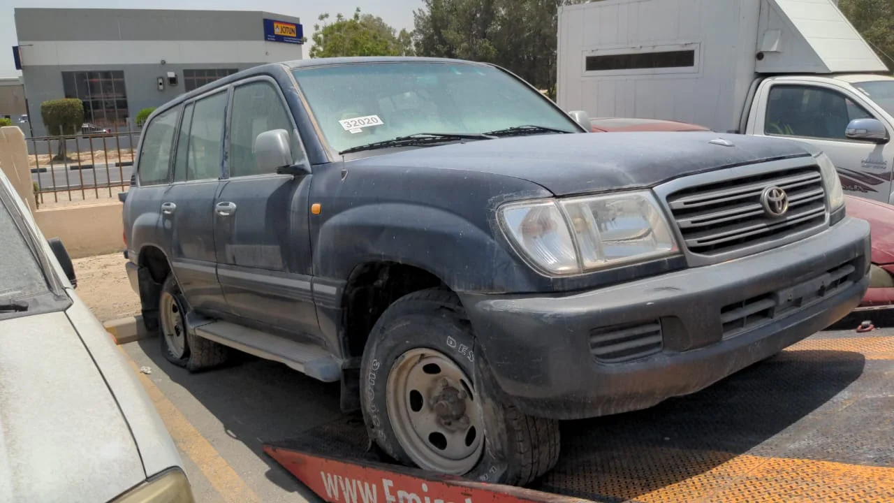

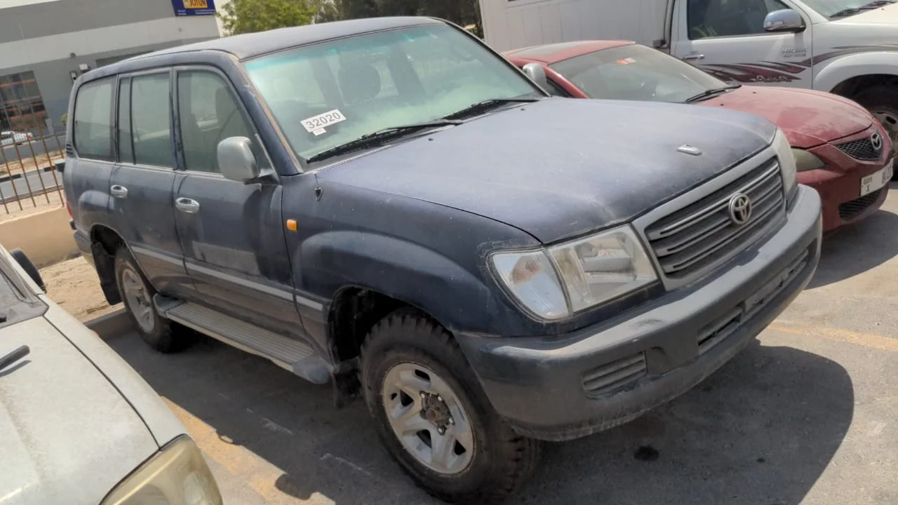

Anyways, this truck showed up on auction about a month ago and I got it after a bit of a protracted fight, but for what I think was a reasonable price, and I first laid eyes on Azraq at about noon on Friday:

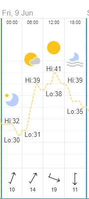

Yeah, it was bloody hot. I had dressed to get dirty. It was so hot that my phone shut down after a few minutes.
That is 105F. I really could not stand the sun for more than a few minutes myself, given the heat radiating off of every surface. AND I was driving a 70 series pickup with no AC so I was hot to begin with.

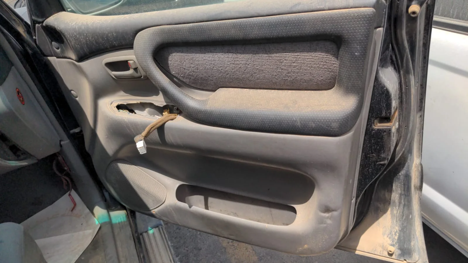

Between the time of the auction and the time of delivery, someone had swiped the door window switches, which was a major irritation. They also had damaged the door cards.

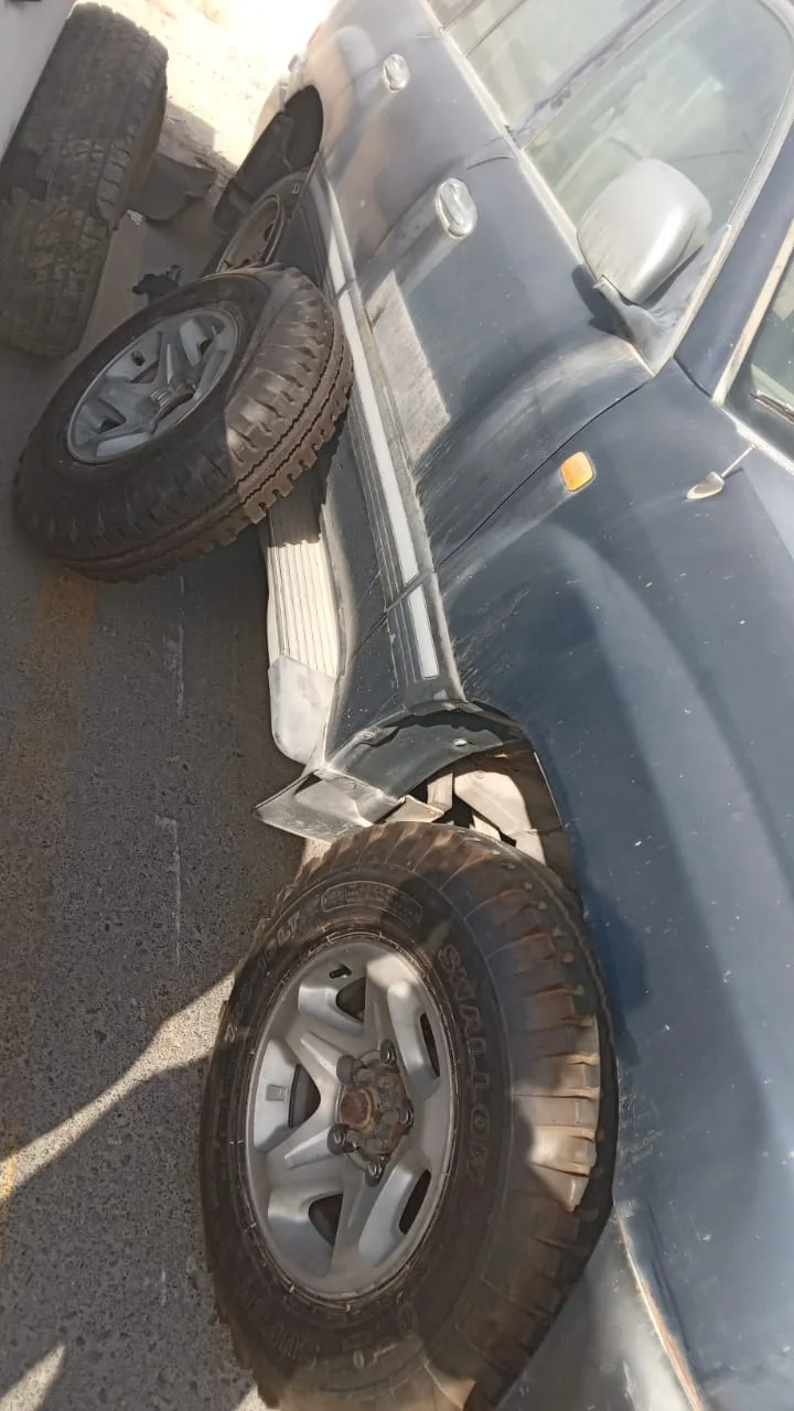

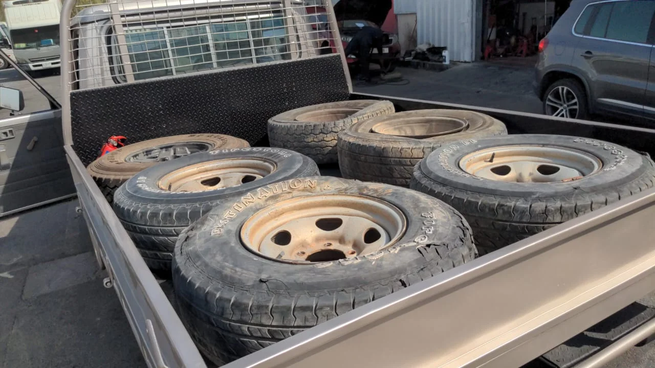

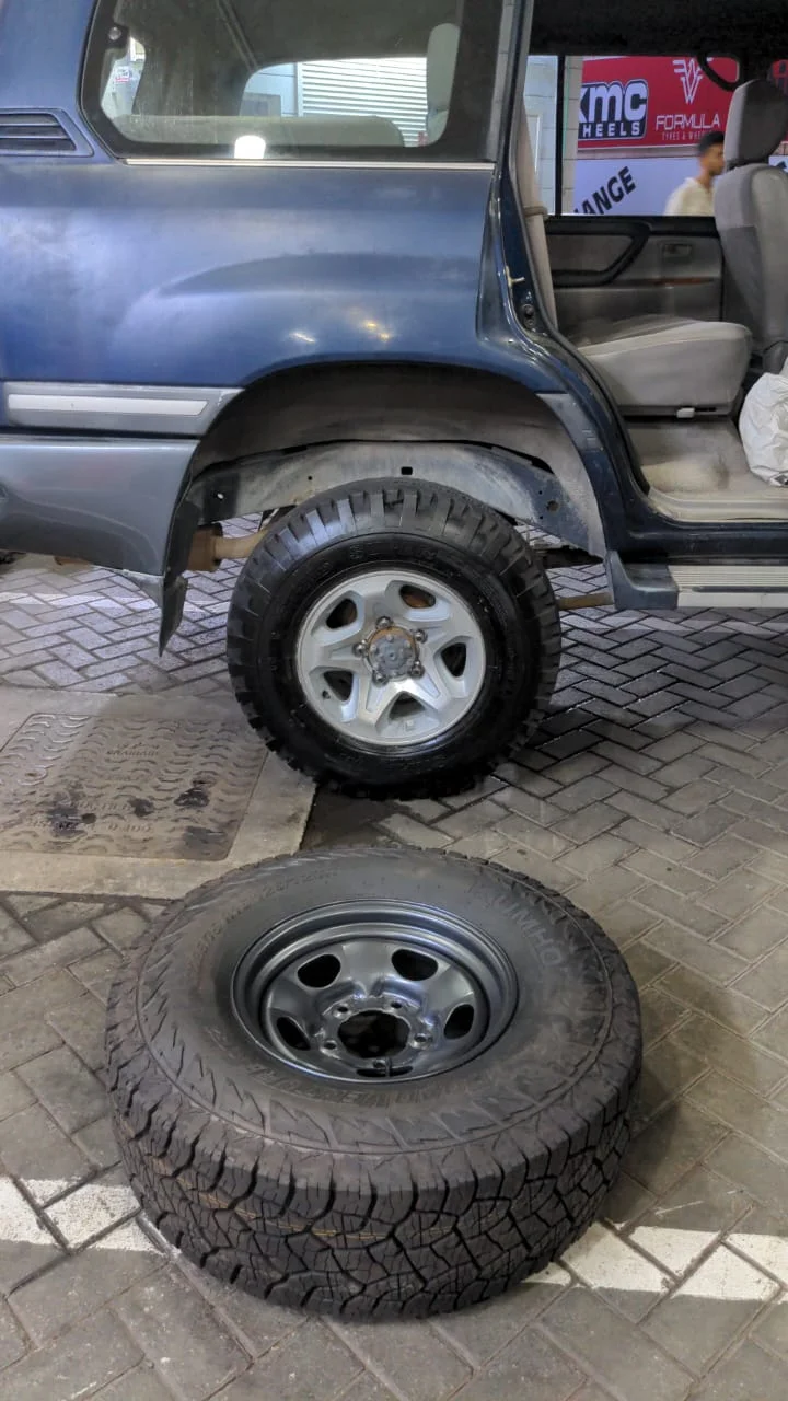

A few days earlier I had prevailed upon a friend for a set of loaner rims and tires. The guys at Powerhouse somehow managed to get them on out there in the direct sun. I could not have done it.
Overall the truck is in good condition considering the exposure.

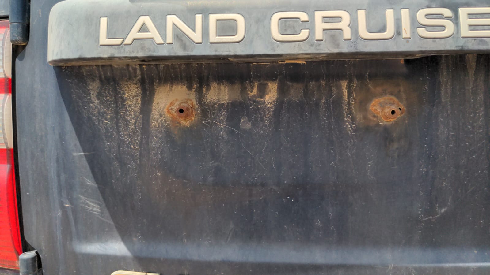

But there are some odd things going on. LIke these welded on license plate nuts

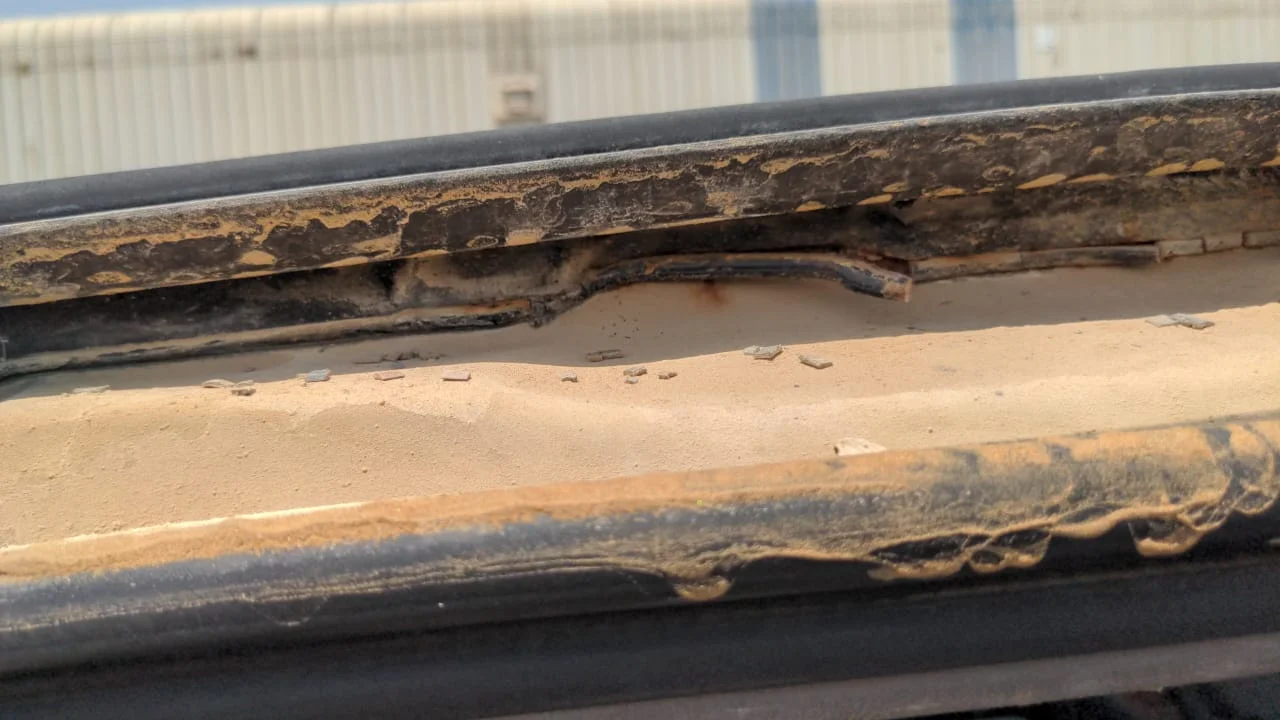

The heat has been so intense that some of the sealant between the rear and roof panels has melted out

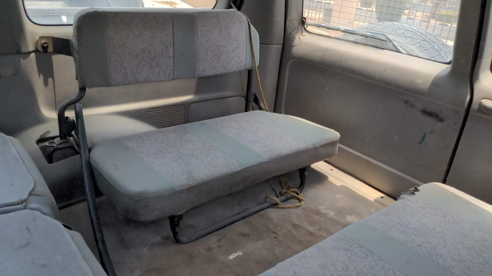

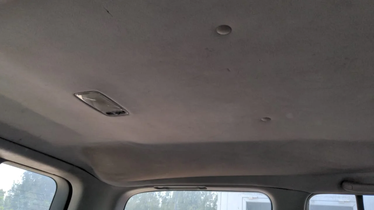

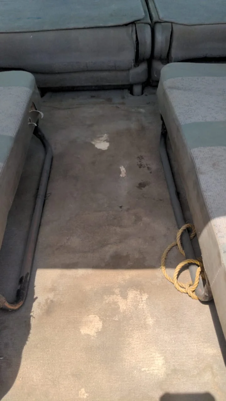

The carpet in the back needs replacing
And there is some light body damage on the right front fender; extent unknown

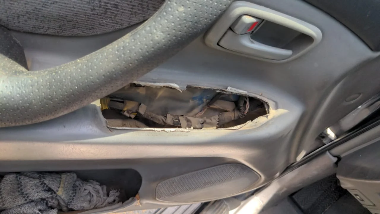

The right front door card probably can be repaired.
The left front cannot

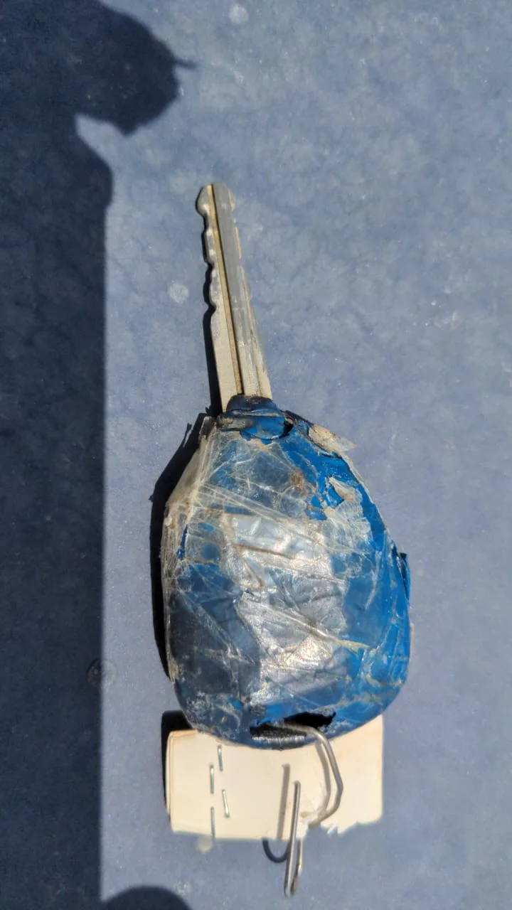

And wondrously, there is a key!
...of sorts

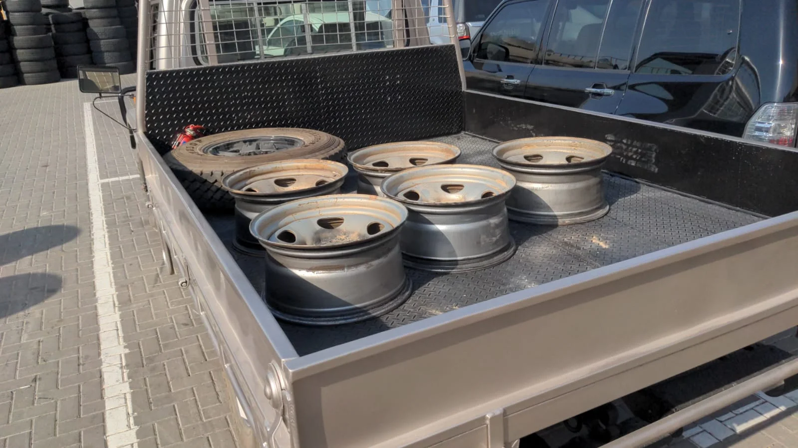

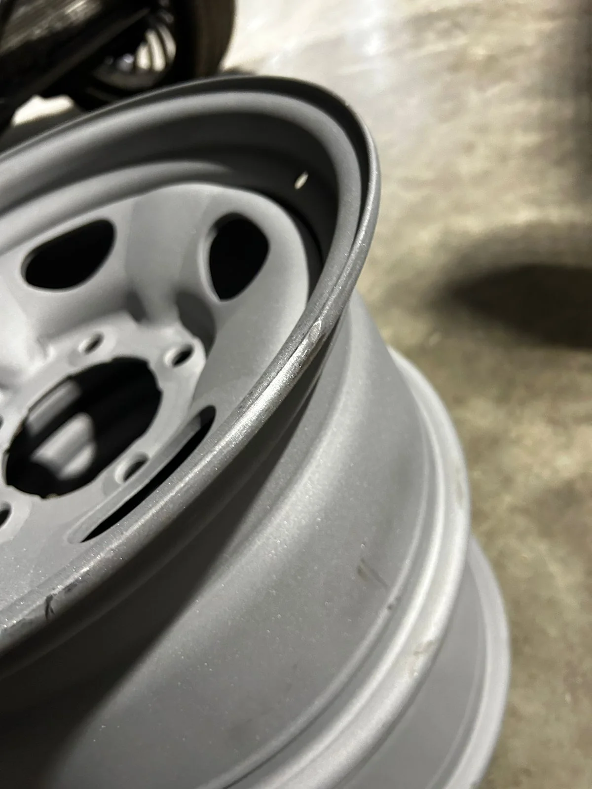

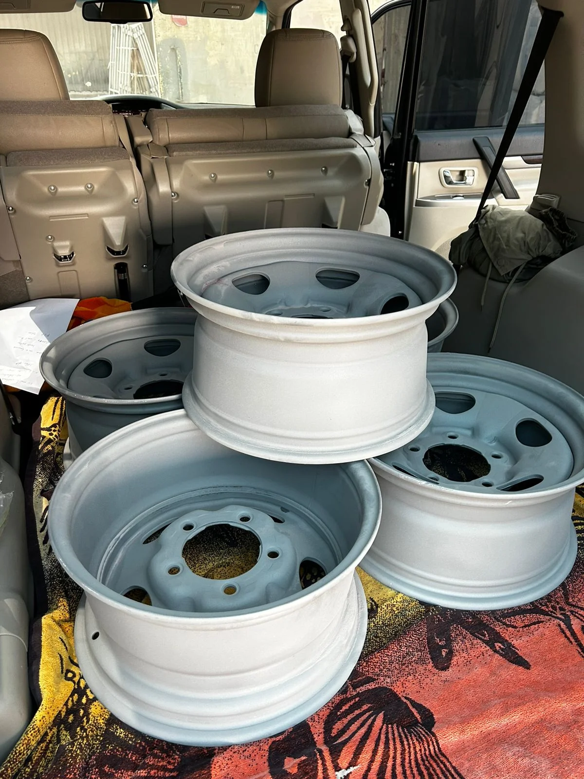

I then drove back to Powerhouse to see if I could pick up the old rims for refurbishing. It was hot. Nevertheless, all 5 were ready and the guys helped me load them up.
They look to be in pretty good shape. The tire shop got the tires off leaving

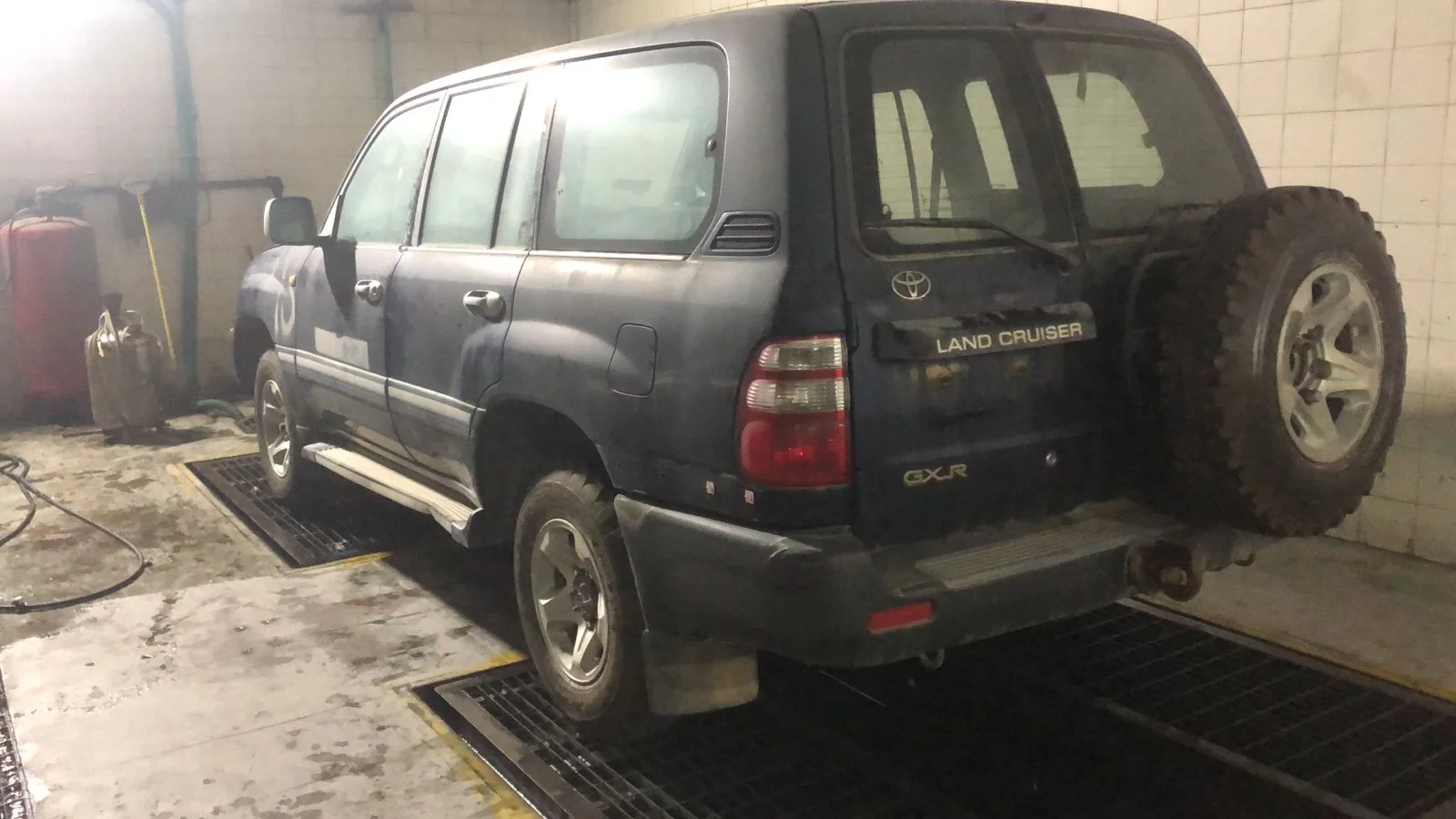

And the truck got its first bath in what was undoubtedly years
Then a little after 6 pm he sent me these two videos
So after maybe 7 years sitting in the desert sun, and with 445684 km on the clock this old truck after a simple oil change and battery install started and ran on 7 year old fuel!
Amazing! How can anyone not love the 1HZ?!

Today is Monday and I went by to have another look now that a lot of the dirt has been washed off. The truck does look better.

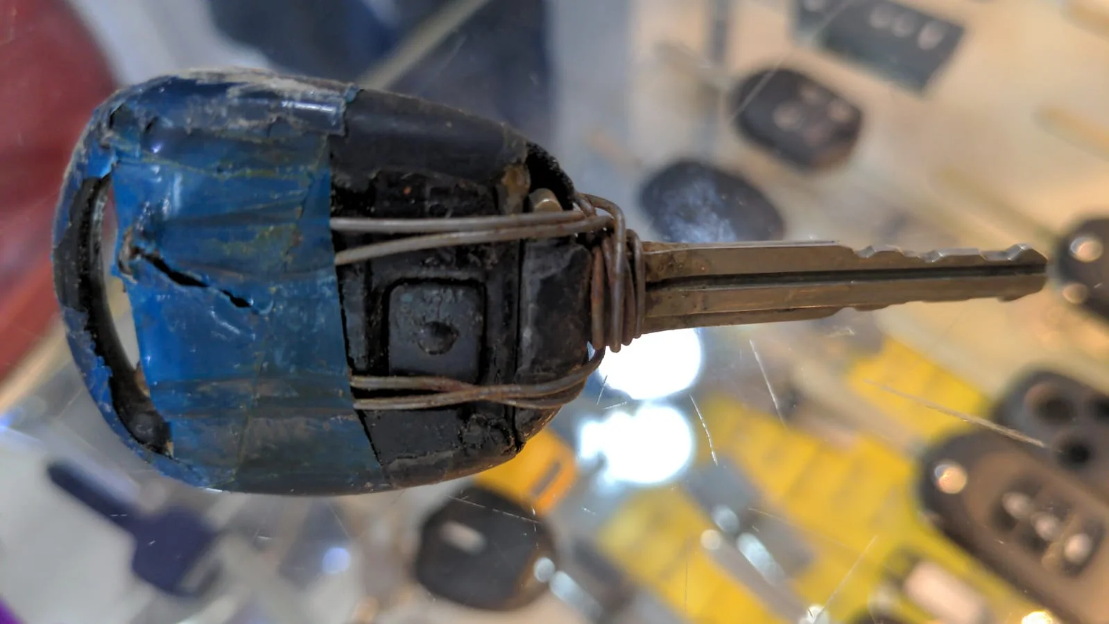

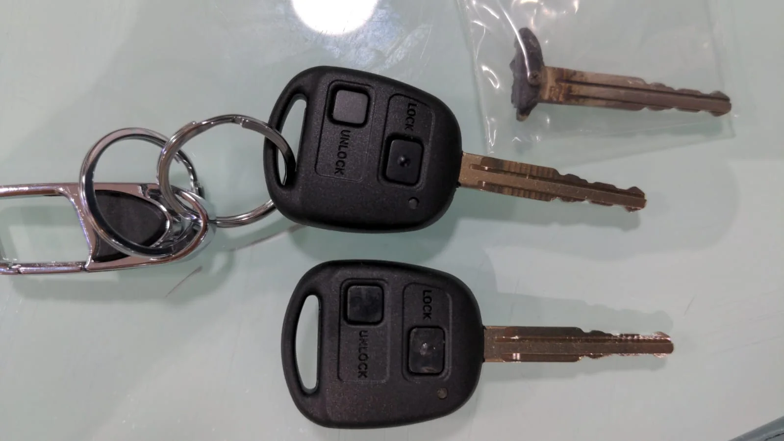

I also decided to go try to get a new case for the key. Someone had been very determined not to buy a new case for the key:
The operation was a success!

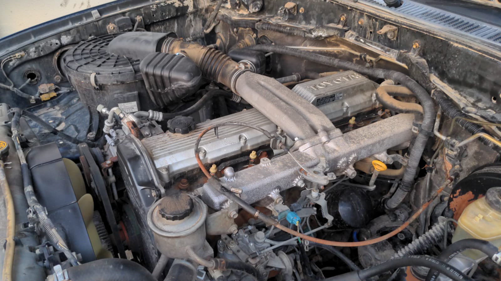

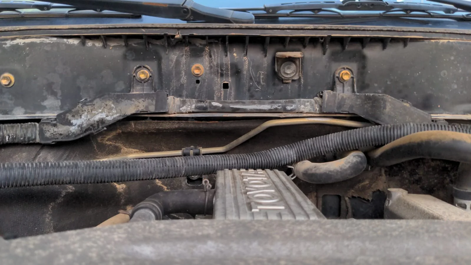

I then went back to the garage and both keys worked from an immobilzer perspective. The original electronics worked for the remote locking, but the copy unfortunately did not. I had some time for a closer look at the engine.

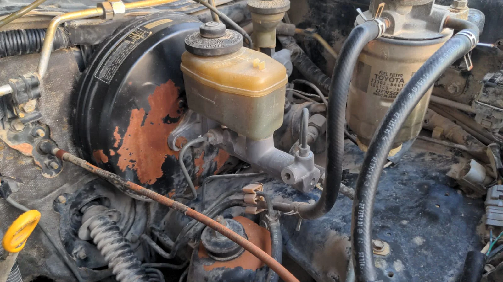

Until now I did not know that the hood struts had a hole in them so you can lock the hood in the up position. Makes a lot of sense if you think about it. Anyways, replacement struts arrive tomorrow.
The AC compressor would not engage but it would be surprising if the system had any gas in it at all after all this time. The guys will check tomorrow in any event.

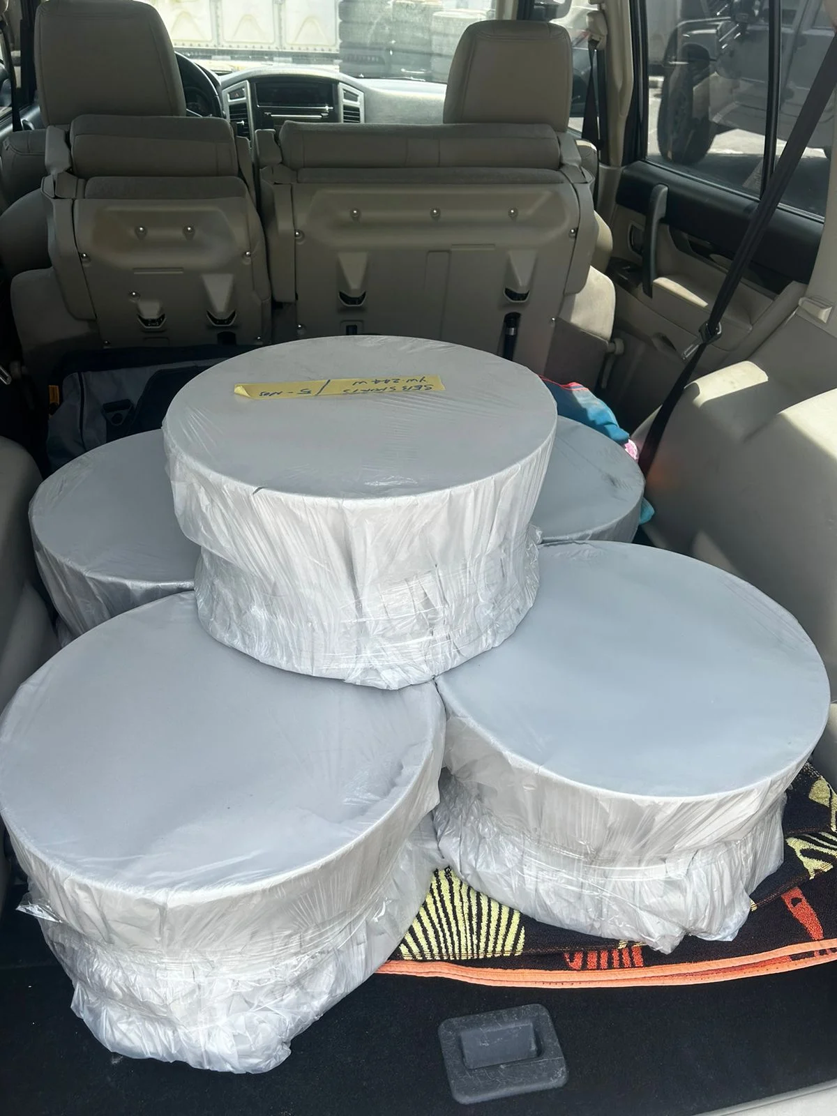

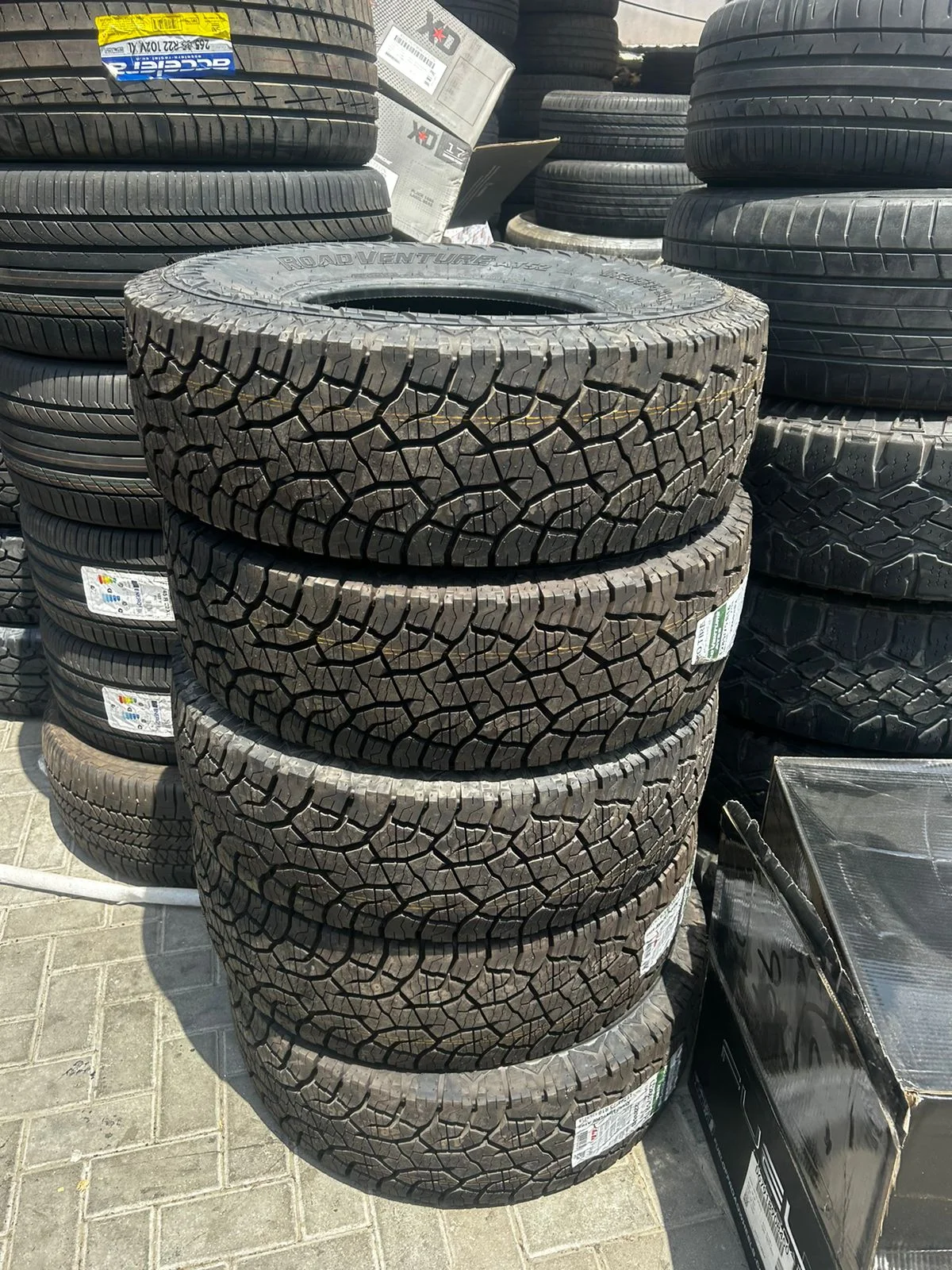

As I write this, it is noon on Wednesday. We are going to try to test the truck at 2 pm with the loaner wheels and tires. Meanwhile the refurbished rims are back from the powder coater and the new Kumho rubber is in.
These are the same tires as went on the white 105 just shipped to Canada.

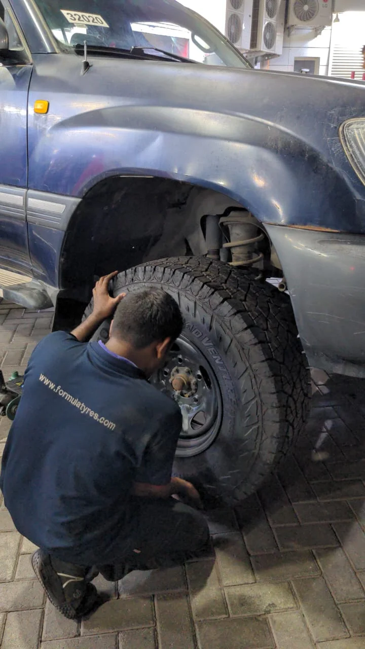

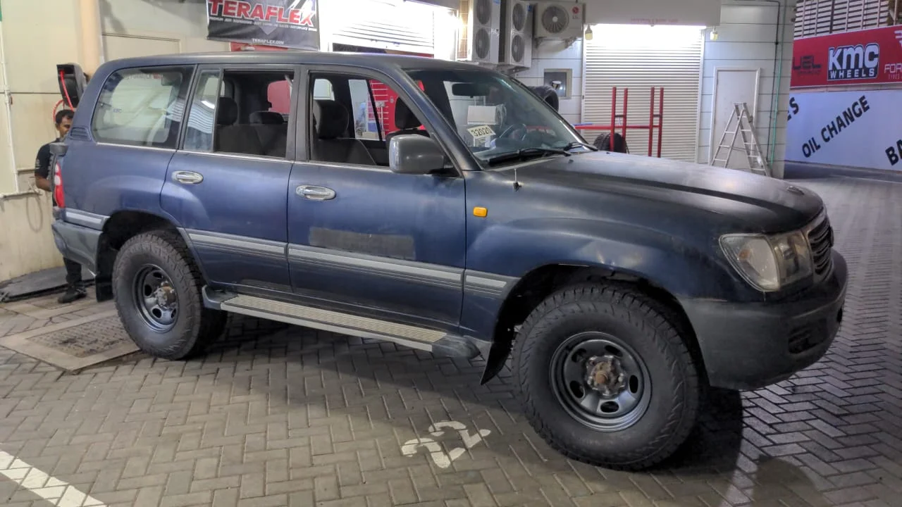

The next step was to get the newly refurbished rims with new rubber on the truck. I flatbedded the truck to the tire place.
and it came home for the first time
The thing is solid as a rock. It really is enjoyable to drive it has the comfort of 100 series and the turning radius of an 80. There was a little kind of something loose in the suspension but only thumped once other than that it just felt great it drove down the road straight and nicely the brakes are if anything a little bit too wonderful. I'm a little concerned about the oil pressure which barely went up zero off zero. But first impressions are very very positive.

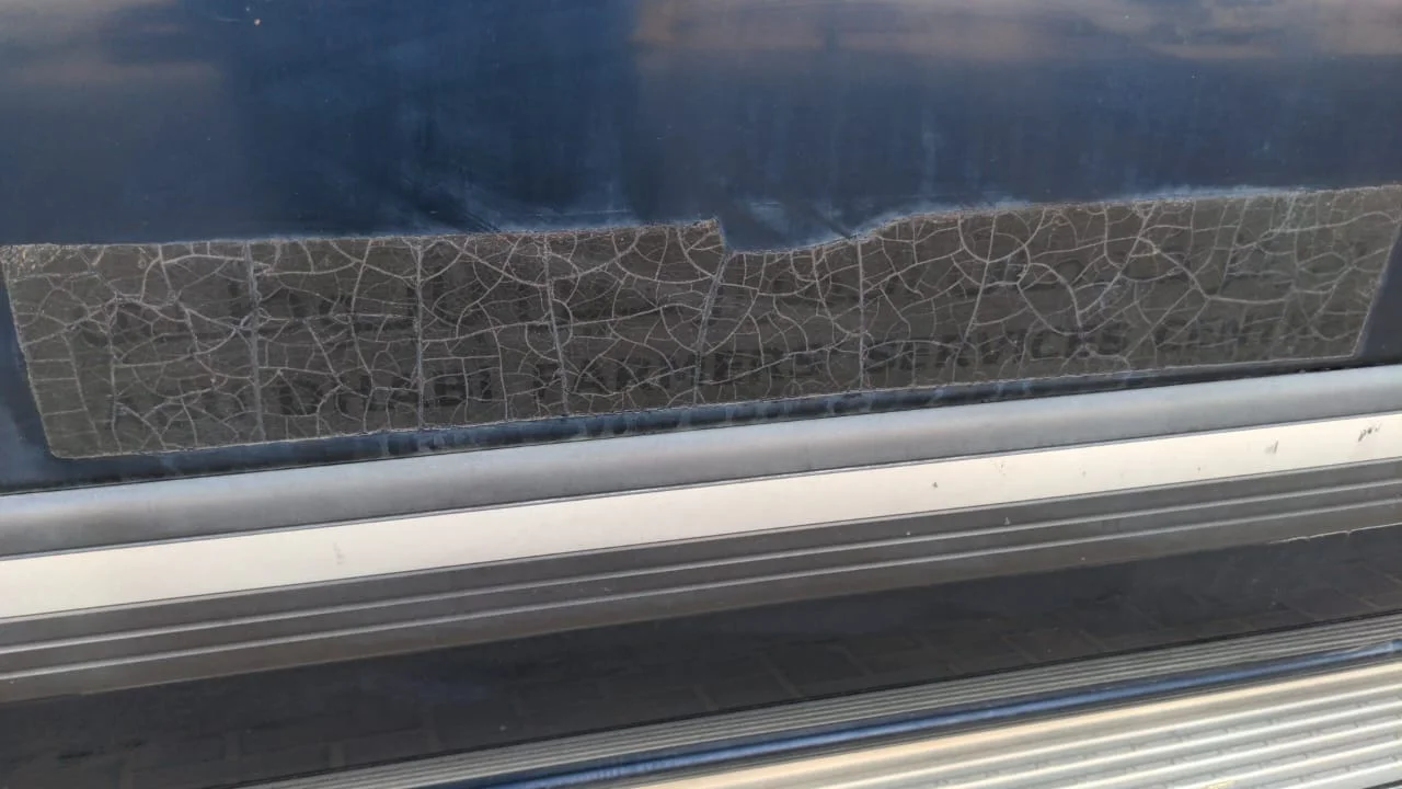

And I also had a look at the the sticker on the side:
It is a little like a color blindness test, but it says "Abu Dhabi Farmers Services Centre" in Arabic and English
