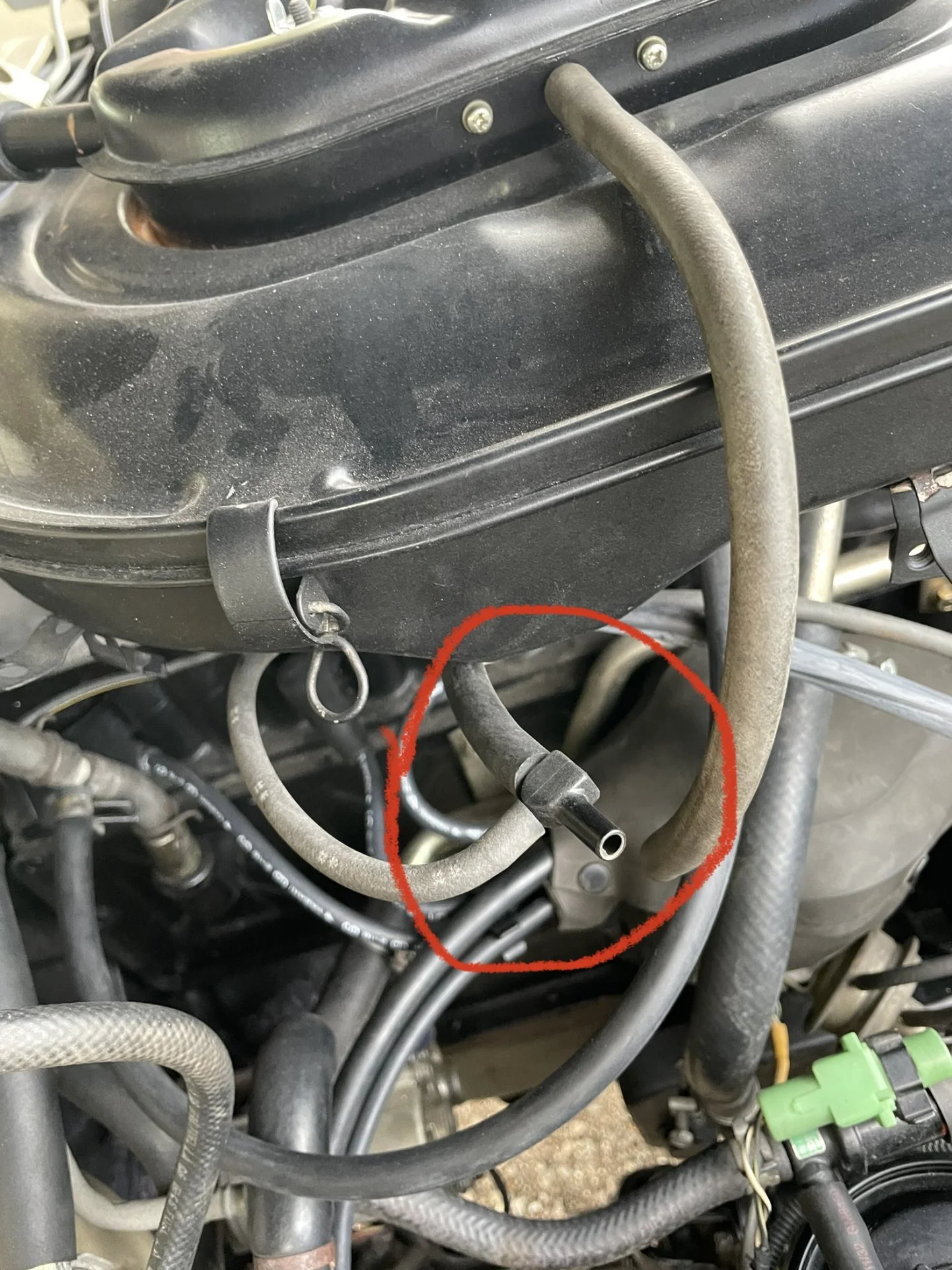

I have a stock, smogged FJ60 that I need help identifying a possible missing vacuum hose.
The t-connector is on the passenger side of the air cleaner housing connected to a diaphragm, not the air cleaner. Is this supposed to be open to atmosphere or is a hose missing?
the hose is not missing,
the hose right next to it that is connected to the top of the air cleaner housing,
plug it back together.

On another note I did notice that the hoses were not connected correctly. Went down the IH8MUD vacuum control valve (VCV) rabbit hole and learned more than I thought possible, including that the Toyota FSM diagram is incorrect……
