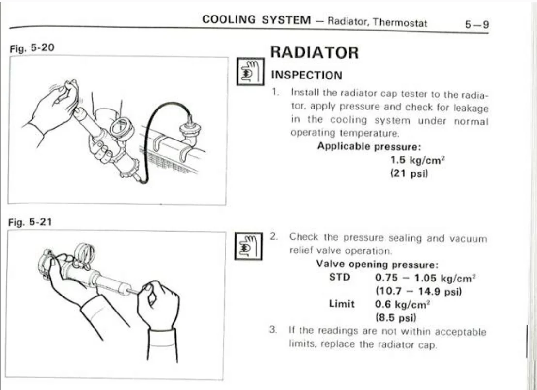

This is from the FSM. They do a pressure test at 21 psi (1.45 Bar). And they test the relief valve on the cap to be between 10.7 and 14.9 psi (0.74 to 1.03 bar). If the pressure on the cap you have is for the relief valve, then it does seem a little bit high.
You might be able to rent or borrow the pressure test equipment from an autoparts store. This is a good way to check where you might be leaking then address the leak with new hoses and/or tighter clamp.

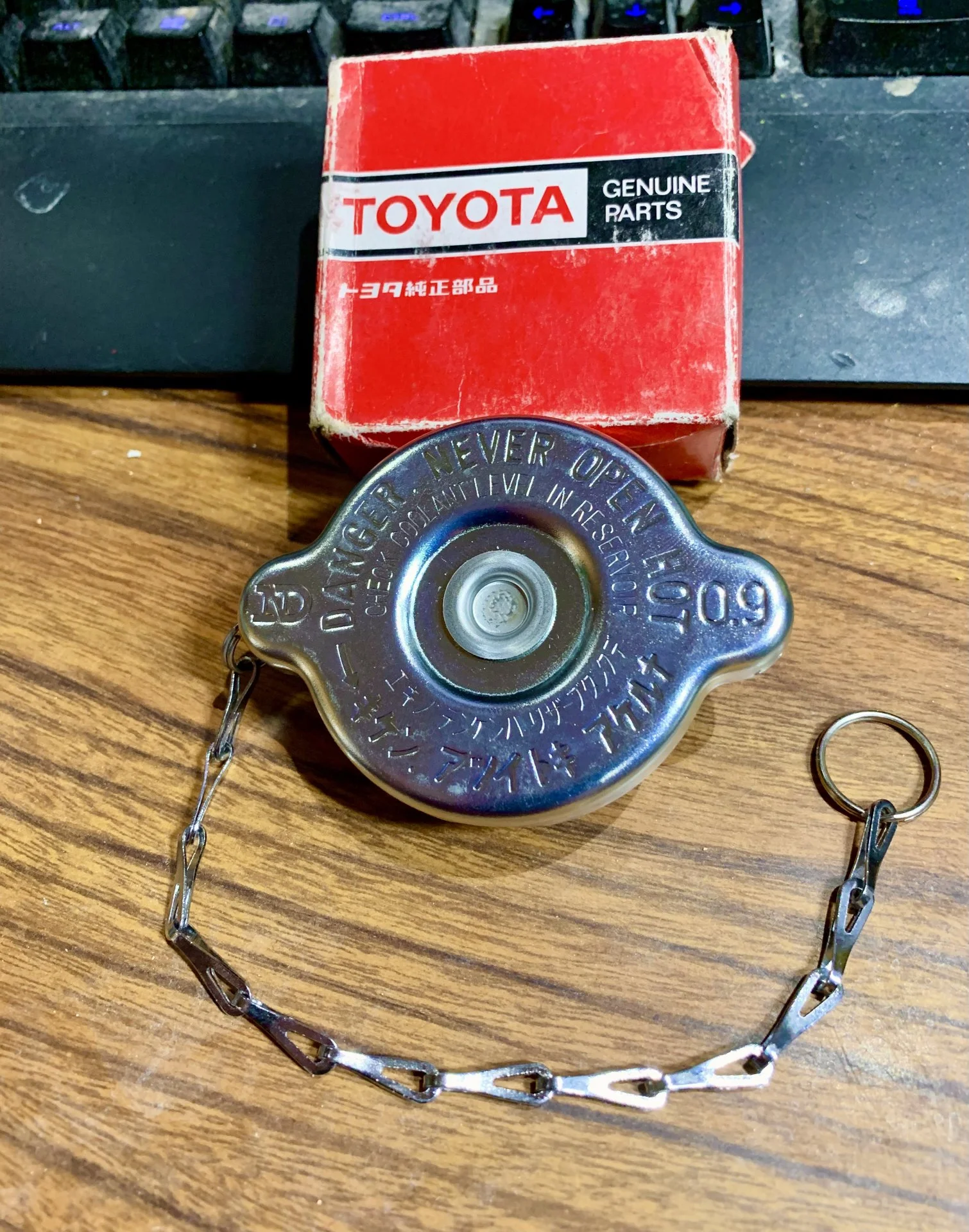

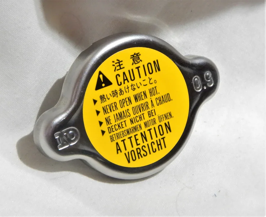

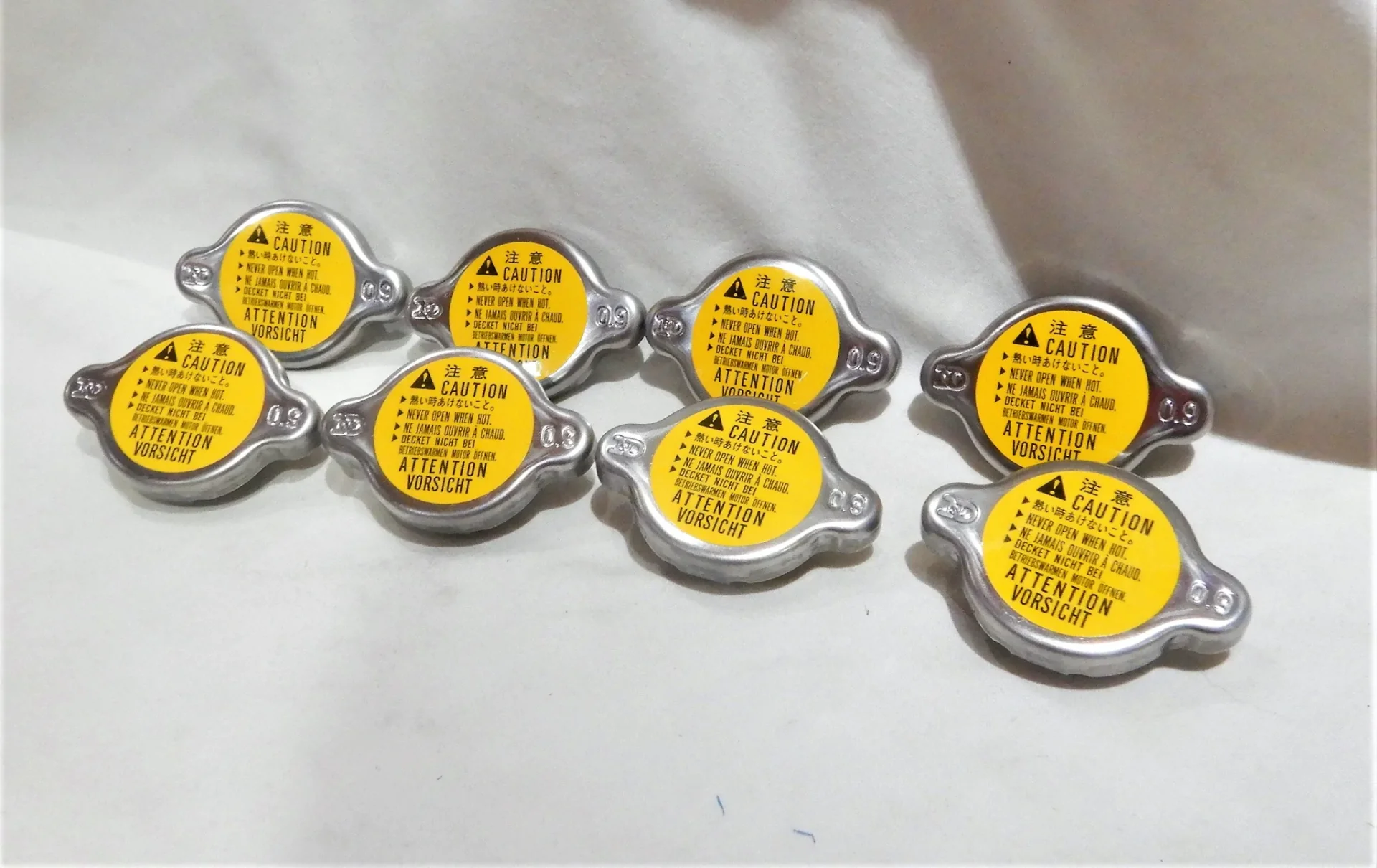

a genuine NipponDenso correct cap has 0.9 stamped on it
ALL Toyota vehicles use the 0.9 rating

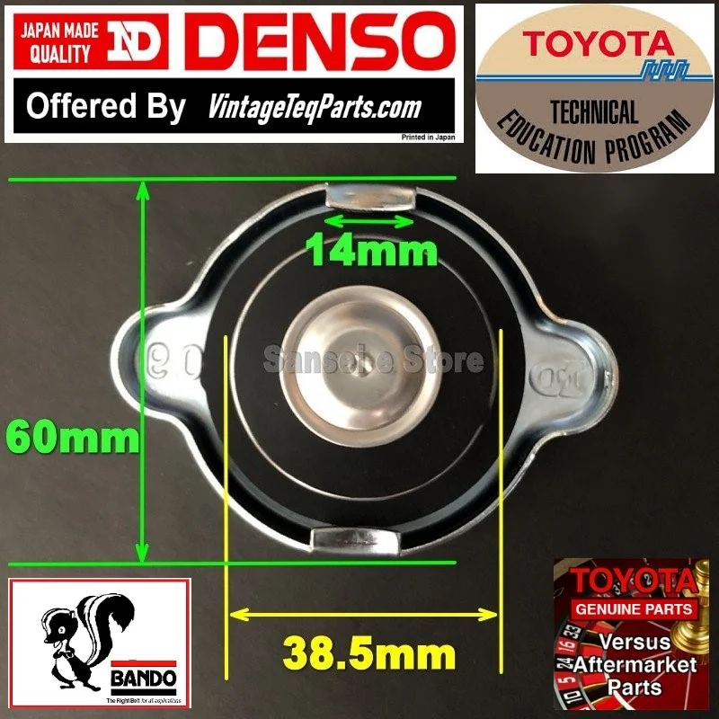

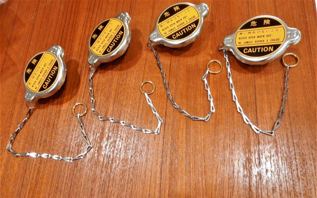

the size spec diagram i made a while back for Tutorial use here on MUD , is of the Pre-4/86 BIG CAP Only to be klear
i guess i should now make a SMALL CAP 4/86-Present Day size spec. diagram too now .......... 🤔
odd thing is CSF , the BEST aftermarket Radiator in my opinion , was all small caps till a few years ago , NOW are big caps much of the time , i hope they realized that
the BIG cap size spec. was needed for ANY 2F and Earlier F1.5 etc engine?
or was it simply customer demand for the timeless and period correct traditional Retainer Chains Laden BIG caps to return ?
hopefully both ! :)
the entire 0.9 topic is based on the Pressure Release feature hands down , as i understand it to be , i would NEVER install a CHEEZY Aftermarket ROCK AUTO China crap cap on ANY toyota i owned for sure
i have seen the damage i higher pressure rated one or a stuck shut SH#T one like moto-rad can cause on a sensitive Toyota cooling system during my tenure at the dealer ship level
all i can say for a FACT , and this is fact based in detail , NO TOYOTA i have ever seen comes with a cap other then a 0.9 and ALL Toyota OEM caps are stamped 0.9

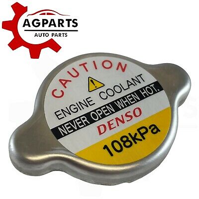

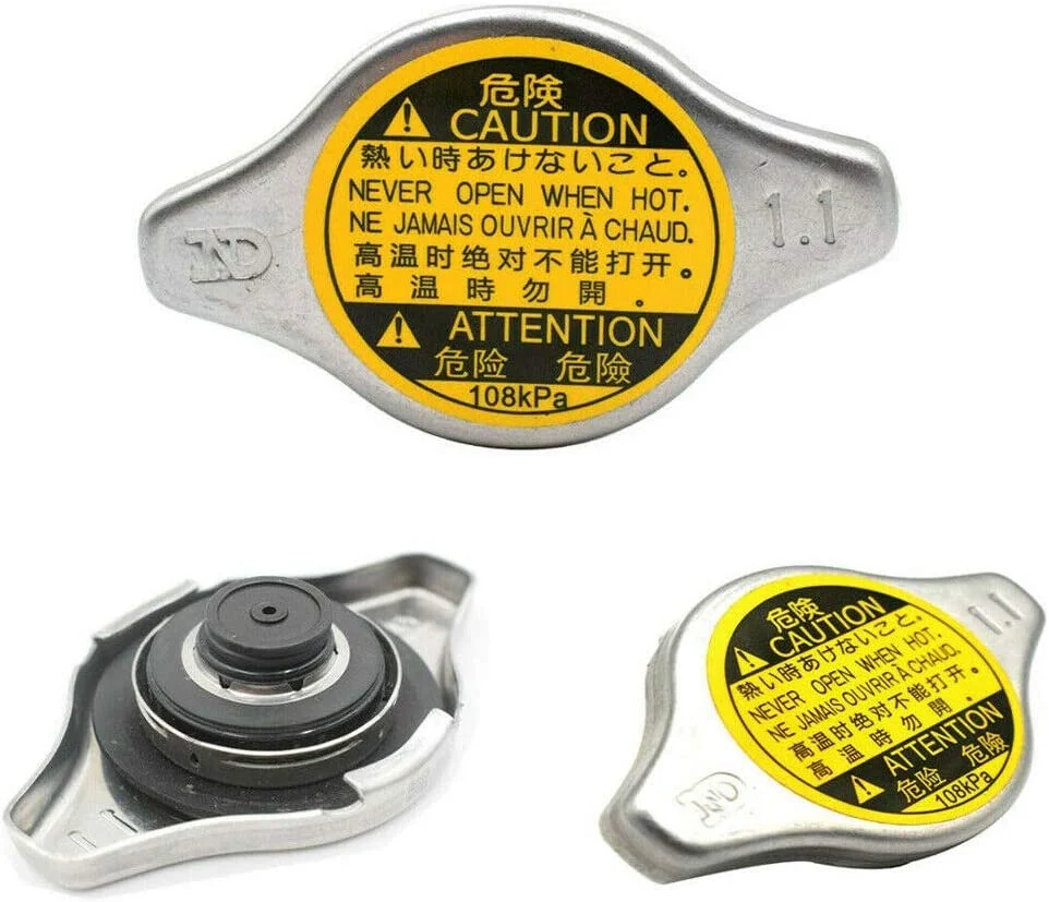

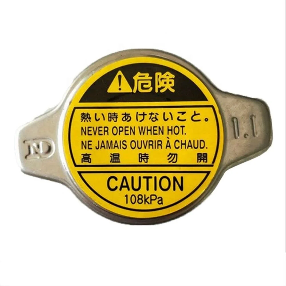

then BELOW MAP is a live real time LINKS of 100% counterfeit DENSO products i can say 100% solid are just that like cooling system parts Radiator caps IN particular
100% COUNTERFIET DENSO NipponDenso Radiator caps
Amazon product ASIN B0B7RMSRYD
Amazon product ASIN B086C3TN15

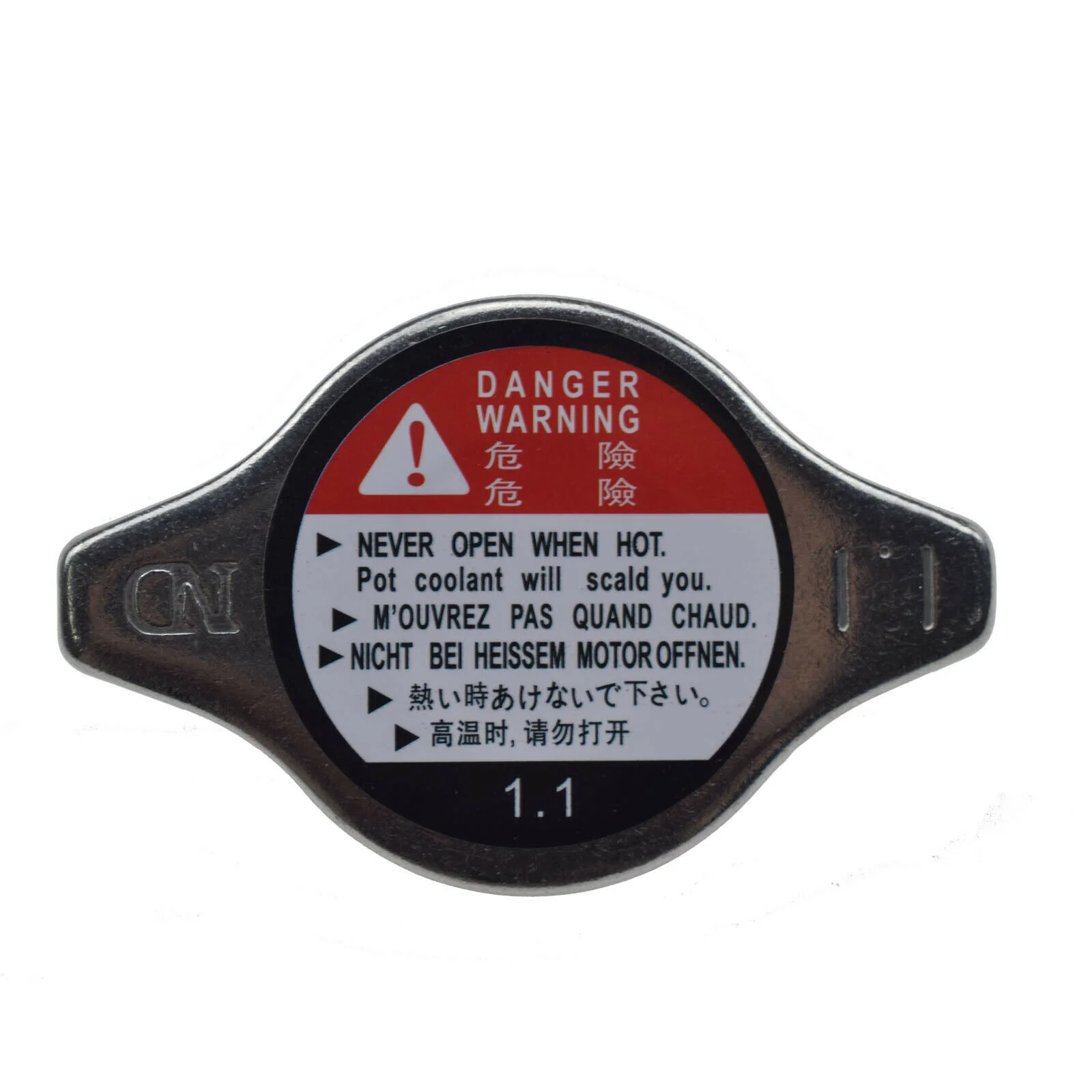

So, it appears that Radium Engineering makes a few different BAR rated small radiator caps that fit the Mishimoto aluminum radiator for FJ60 2F's. The link is here: Radiator Caps - http://www.radiumauto.com/Radiator-Caps-P726.aspx
The lowest BAR Radium makes is 1.1 BAR which equals 16.0 psi. It's not the 0.9 BAR/13.1 psi that the OEM Denso cap appears to be rated. But 1.1 BAR/16.0 psi is 13.3% better than the 1.3 BAR/18.9 psi that the lowest rated small cap Mishimoto, so it's better than nothing.
Will post to this thread as I experience the results of the lower rated cap. I just installed it today on my FJ60. I have been experiencing slight water leaks over time as the Charleston, SC weather in August exerts its influence on my motor.

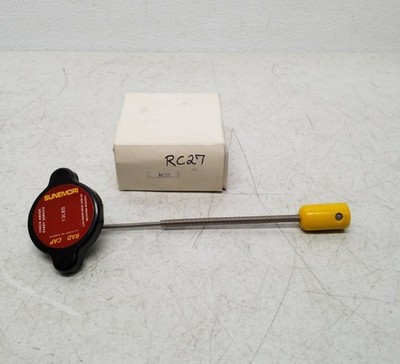

I know this one fits, its rate at 13 lbs. I run it on my Mishimoto radiator, it does have a sacrificial anode attached that can be used or easily removed.
