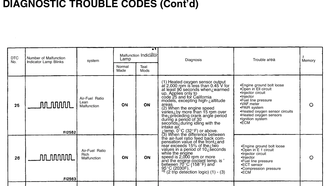

Looks like OBD 1 uses the same strategy to detect a misfire, bit on OBD 2 trucks they're constantly being monitored for a misfire and this looks like it's 2 trip detection logic, so it would have to detect a problem in 2 drive cycles. I'm asking as much as I'm telling.
Also, not really the OP's question but for general edification there is no "misfire" code on OBD 1 trucks, 25 & 26 "lean condition... " are it. OBD 2 is more sophisticated with constant monitoring of misfire (doesn't take 2 trips to detect and flag, it's nearly instantaneous) and ability to pinpoint which cylinder is misfiring.
So yeah, maybe don't worry about the MIL for now.
Also look closely at that FSM page and appreciate the Japanese man (or woman) who translated it into English for us.

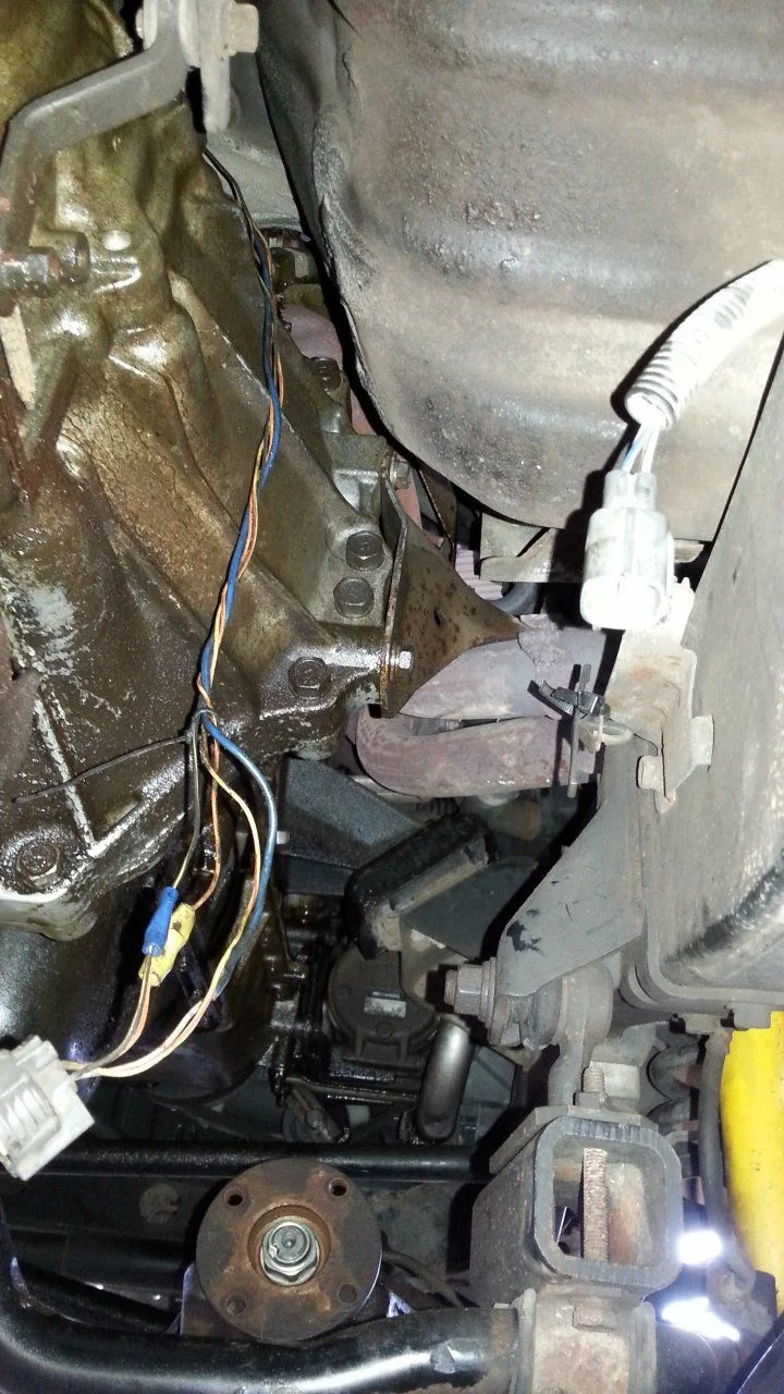

Thanks for all the replies I was on to checking the o2 sensors next and I remembered the wiring for the inboard sensor was always a little janky. I had seen these splices before but just assumed an aftermarket sensor had been used. It never gave me any trouble, so I didn't give it a second thought.
Now I realize these splices were made upstream of the connector, and there is no wire loom around the wires where they go above the transmission, so someone has been in there before me. Also, there is a blue wire that is fatter than all the others, and had a strange splice into the white wire leading into the plug. The blue wire looks like some sort of coax with an inner wire and an outer wire, and it has an abrasion that was covered by electrical tape . I am planning on redoing these connections next but that I have never seen anything like that fat blue wire. I traced it back and that's how it emerges from the main harness. So I am wondering how to make that splice???
That wiring looks a bit suspicious. 02s are voltage based. So a bad crimp, corrosion, aftermarket O2 could be a possible source.
I highly doubt it's because of the missing drive shaft. (In case someone points that out)
Although I would assume if you had a bad sensor it would go into limp mode. Closed loop and run a bit rich and not pull a code 25 lean. Just my guess.

What's that connector coming down off the frame rail?
Thanks R
o2s appear to be OEM I will be redoing those splices today (although that fat blue wire "coax"? has me stumped)

That connector coming down is from the o2 sensor

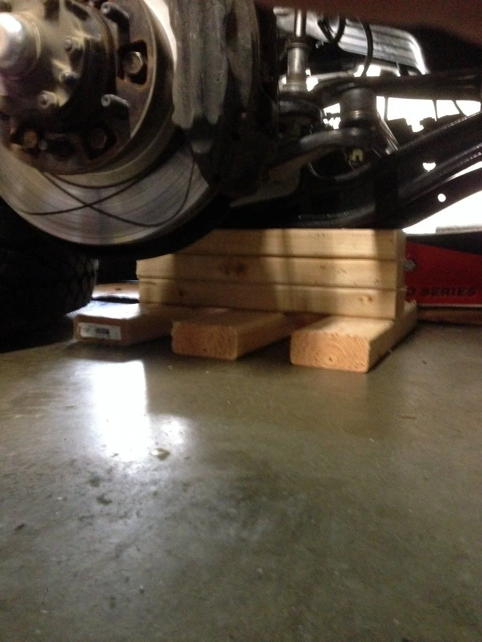

I have been trying to avoid all work that is involved with that (Removing throttle body etc.). Working on that area on a lifted 80 is a major PITA. I am actually thinking about building some sort of platform, so I can sit in the engine bay and work right there
Or, just remove the two wheels and sink her to the ground!

speaking of lowering, this is what I do: put the floor jack under the front diff, raise, remove both wheels, then lower it until jack bottoms out. This puts the disk rotors about 1/2" off the ground.
