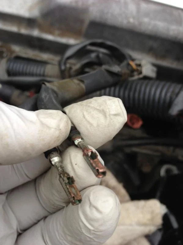

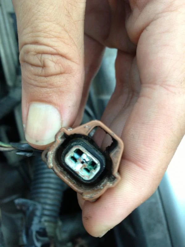

Ok. I found the bad injector. #6. Seriously corroded by drips of coolant leak from the heater hose above. What's a good cleaner to clean it? Should I use dielectric grease when I put it back. Thanks for all the info on the disassembly...it saved me all the guess work!
Go with an electronics contact cleaner-leaves no residue. Use an appropriately sized fuzzy pipe cleaner to rod out the worst of it and then finish it off with some more contact cleaner.
Not so sure about the grease when you're dealing with narrow tolerance low voltage signal. I could be wrong however...
I'd personally look at buying a new harness end injector pigtail and cutting off the corroded one and splicing in the new one. Not worth doing a half arse job on electrics unless you want to turn your 80 into a rover product...
What's the injector side look like - I'd consider a new injector if that is a mess as well, keep the original as a spare if it is functional.
Where's the coolant leak coming from - bad hoses, clamps or a heater valve that is about to give way. Read threads on this forum - the heater valve deteriorates over time and the plastic pipe ends will give way catastrophically, has happened to many including myself.

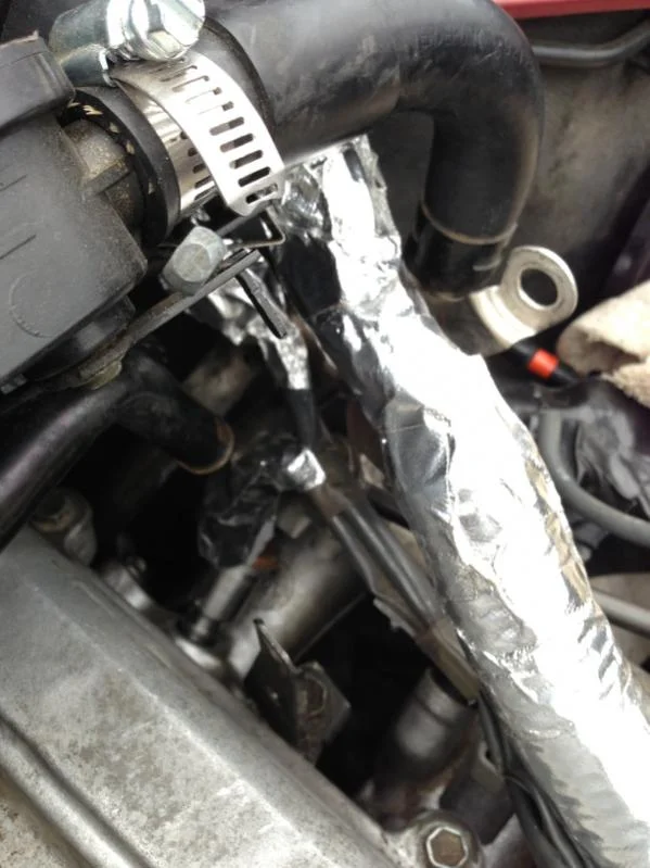

Thanks for all the tips guys. My LC runs so smooth now. I replaced all injectors and seals with rebuild injectors, replaced injector #6 connector housing, wrap heat shield to the harness, and replaced the heater control valve to fix the leak as well. ..putting misfire to a graceful closure :)
Excellent! Glad you did the job(s) properly. Now you can enjoy your vehicle.
