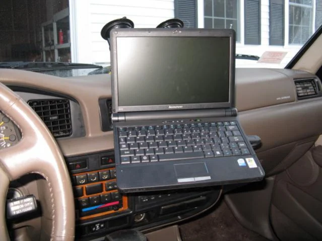

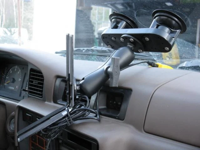

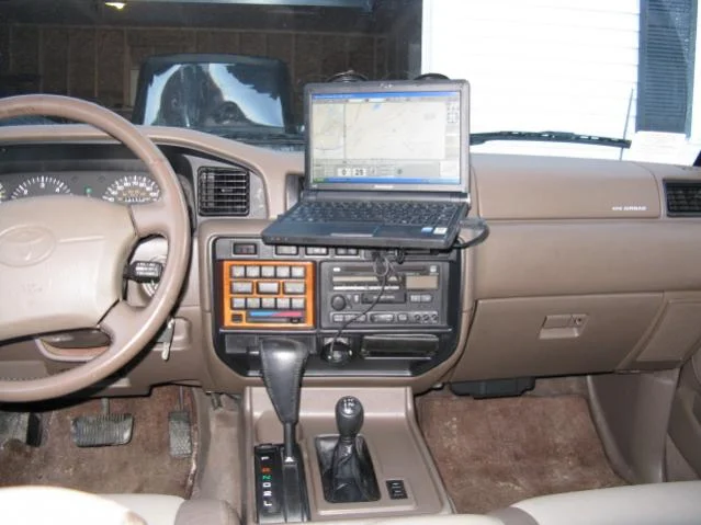

I just bought one of those mini laptop computers (Lenovo) to use in the cruiser to run my DeLorme Street Atlas and Topo program. It also has the advantage of wireless internet. I fabricated my own mount using a Ram suction windshield mount as the base, a 6" extension and on the end of that a ball mount. To the ball I mounted two 1" strips of aluminium bent to my liking. The computer is held in place with Velcro. I took it for a shakedown cruise and don't see any issues. Feel free to comment.

How far apart are these strips?

The suction cups are pressed on and then a lever thrown to cause a vacuum. They really hold well. Ram makes a great product. The strips are only about 2 inches apart. The computer has a 10.2" WSVGA (1024x600) AntiGlare TFT display, is 9.8" wide, 7.2" deep, 1.1" high, and weighs 2.6 pounds.

It is the Lenovo S10 and no it doesn't come with built in GPS. I am running DeLorme Street Atlas. I want to try National Geographic for Topo software. I think it would hold a 15" laptop. The aluminium may have to be a bit thicker to support the extra weight of a full blown laptop. The mini laptops are a lot lighter than a regular size laptop. The Ram Mount is very well built and will support just about anything. I also run an Itronix ix325 in the same mount and this is a lot heavier than the Lenovo S10.
I doubt a trooper would worry about this as it really doesn't obstruct my view. Maybe he would say something secondary to being pulled over for some other reason. I could always quickly close the screen. I've had no problems in the past running larger computers like my Itronix IX250 or the tablet Itronix IX325.

Your set up is a very nice alternative. I use suction cups all the time for such including ram cups. They work, but do tend to lose grip over time. I've found that both extremely cold and extremely hot weather beating down on the windshield will cause the suction cups to rapidly lose suction for some reason. Just keep in mind. If it were me, I'd probably find some way to brace it from the bottom to minimize vibration and take some of the load off the windshield cups.

Thanks for the advice on the suction cups. I will keep an eye on them. I've used both a tablet with touch screen (Itronix ix325) and a laptop with touch screen (Itronix ix250) and I don't like having just a touch screen with no keyboard. I feel the mini is the best of both worlds. Small and light, I have a keyboard so I can use the touch pad and keys, and can live without the touch screen. The Itronix ix250 had both the keyboard and touch screen, but it very, very heavy....

I too am wondering how well it will hold up to the vibrations of being in a vehicle. I did find one limitation yesterday..... The computer did not boot up at -10. I used the truck vent to blow hot air on the computer for a few minutes and it booted fine once warmed up a bit.
