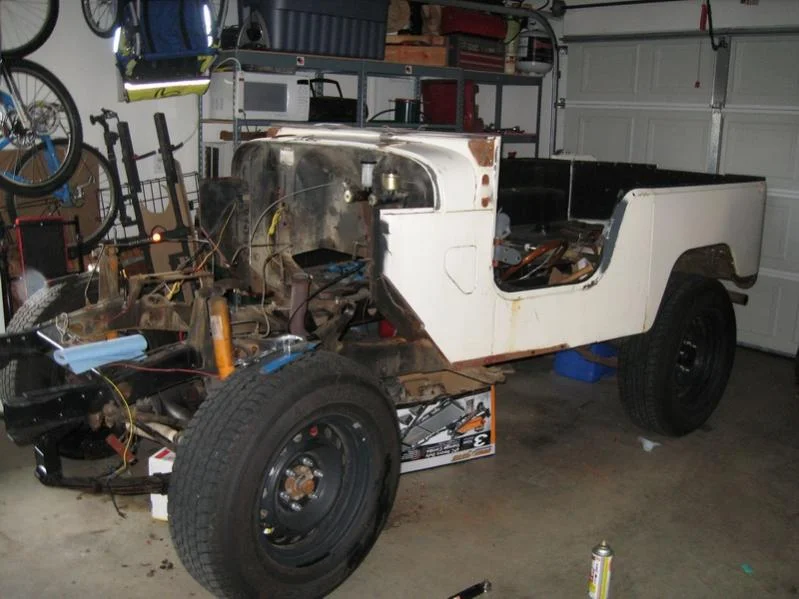

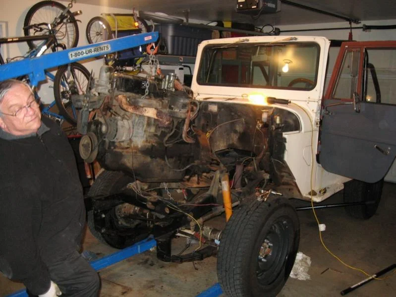

We got pretty far in one day. I need to get down to the frame by the end of tommorow(March 29, 2008), so we can get it to the powdercoater. Thats my goal anyways. The compression on the original motor all checked in...nothing below 130. Spector says im in pretty darn good shape for a '62. I have had a blast stipping this baby down. I cant believe how simple these rigs are. Major thanks to my pops that flew out from San Diego to get this project started with me. I will continues to take pics and post them here.
:clap:
Yes I have a rig in Roseburg but not for sale. Well I have another one that might be for sale.
here are the pictures..... of the tear down.

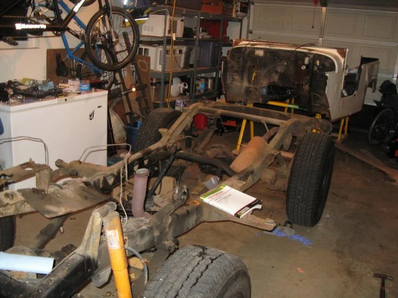

Sandblasted frame
I droppedd the frame off at the powdercoater on Monday(finally!). I called today and they have just blasted it so I went over to take some pics. Some cracks under the rear leaf spring mounts needed welding but that was it. They said it will be coated today but i will pic it up in the morning.

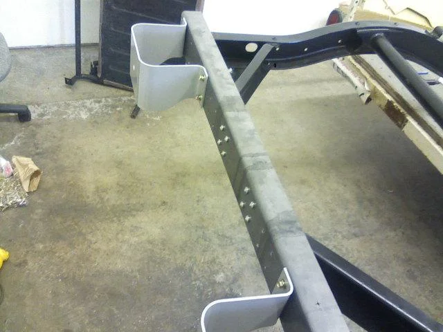

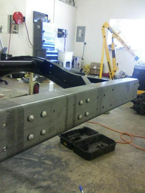

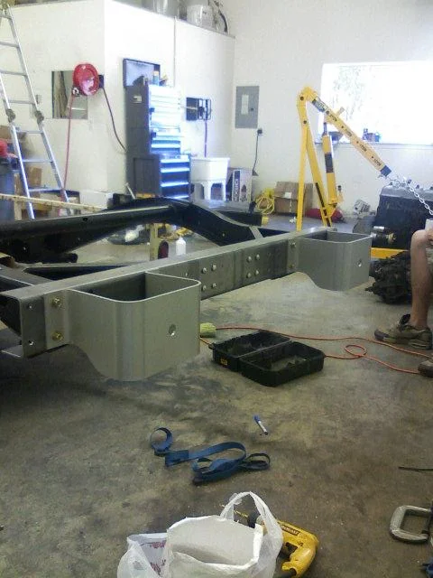

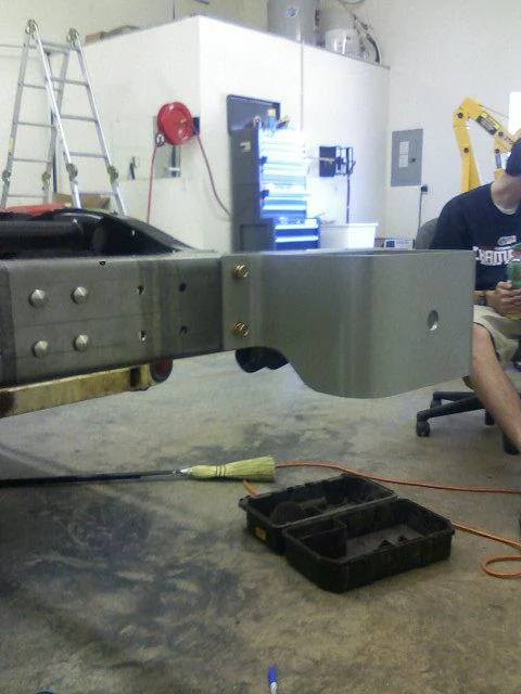

Ok it has been a little while since I have posted an update. I have had a bit of a snag. After the frame was powdercoated i realized how much damage there was everywhere. Hard to see it all when it was covered in mud rust and grime. Two of the shackle hangers were so crooked, the many rewelds had to be cut off and rewelded in the proper alignment. Many cracks were found and repaired. the bigest issue was the rear channel bumper. It was not possible for me to find one for my year. I coundnt even find one from another year. Spector had one but it was tweeked as well. The problem with my existing one was a serious warp(it was arched) from somone welding a large reciever hitch on the underside...too much heat. It had also been beat to heck. I have fabed a new channel and it turned out great!. I also machined down 10mm bolt heads to replicate the factory rivots. Here are some pictures of the first try on this afternoon. I had to throw on the bumperettes just to see how pretty it was all together.

The bummer will be forking out the cash for the whole frame to go through sandblasting and powdercoating again.
