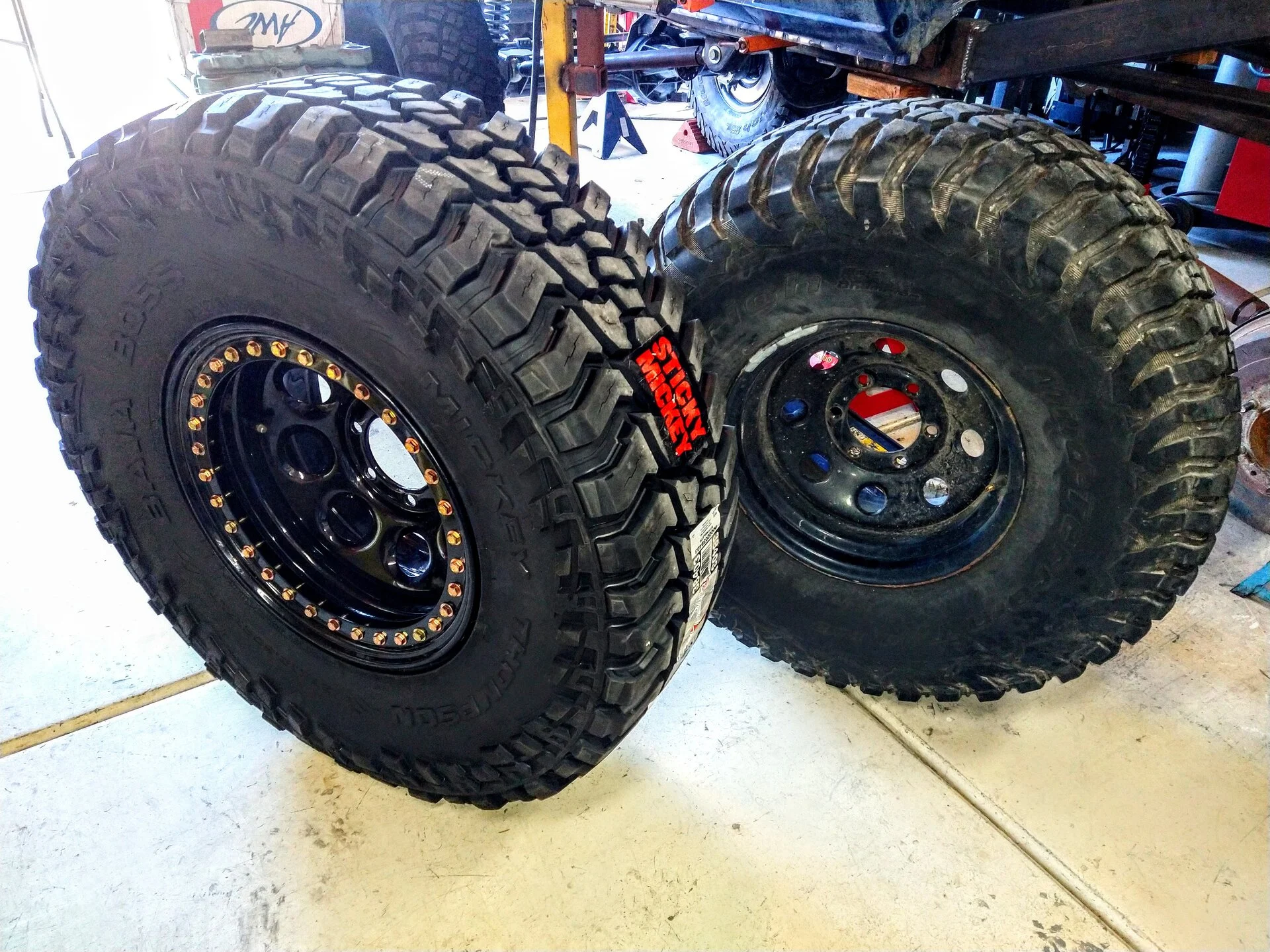

I bought just one of these so far as I need it for mockup on my build. I just want to let others know that the bead on these are super thick. I had to run two sets of 1/8" spacers on my Raceline RT81 steel beadlocks. That's 1/4" total. I spoke to tech at Raceline and they said there are a few brands out there that require this.
UPDATE: These tires have outer bead that is .850" thick and I had to use 3/8" of spacers.

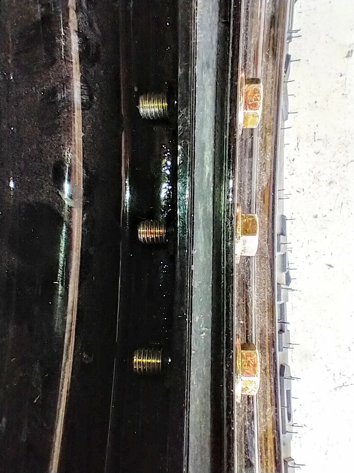

I got a couple more tires so I measured the bead thickness before I mounted them.

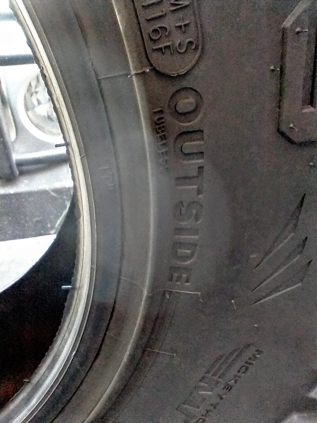

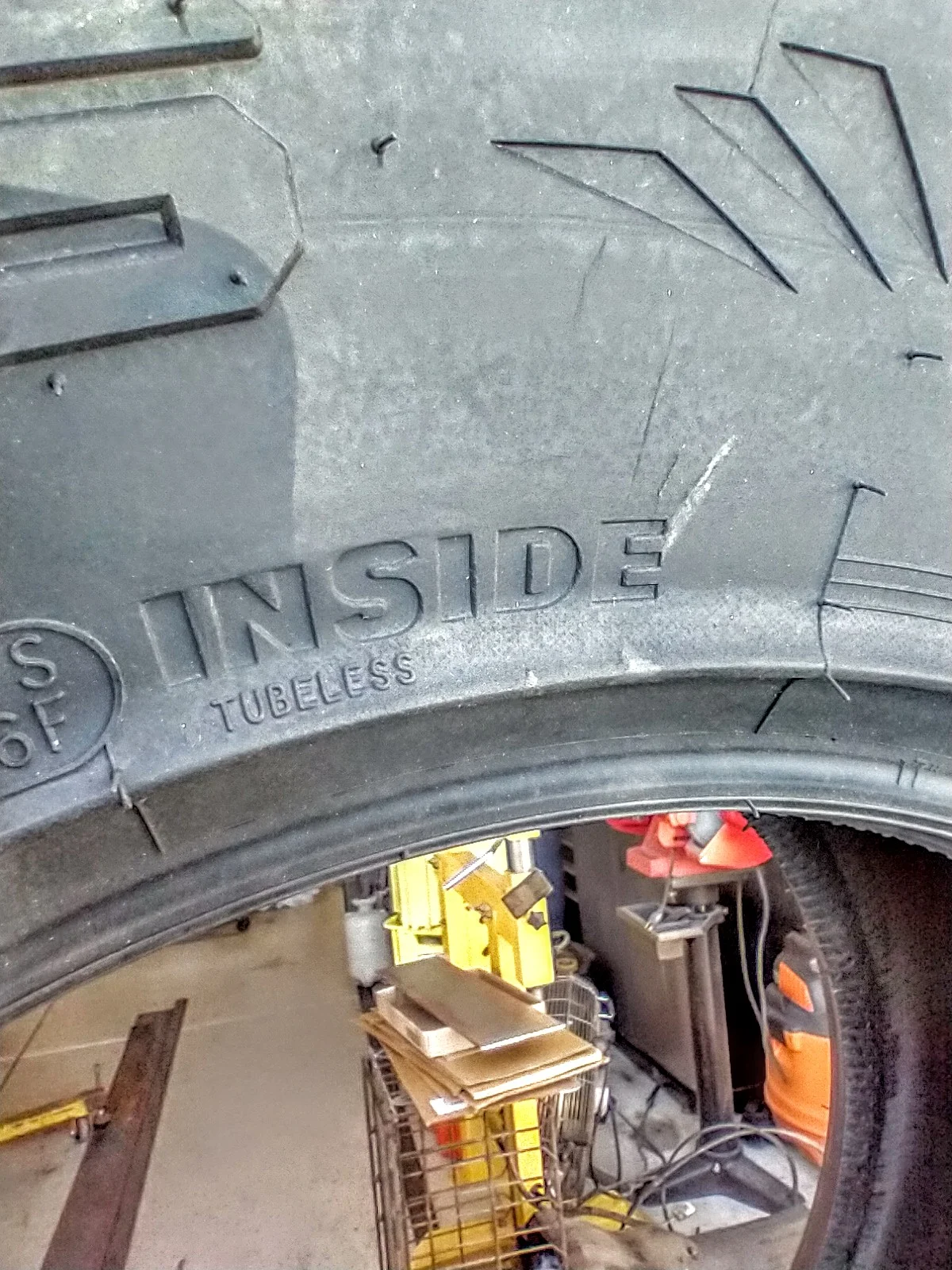

They are not directional but they do have the sidewalls marked inside and outside.

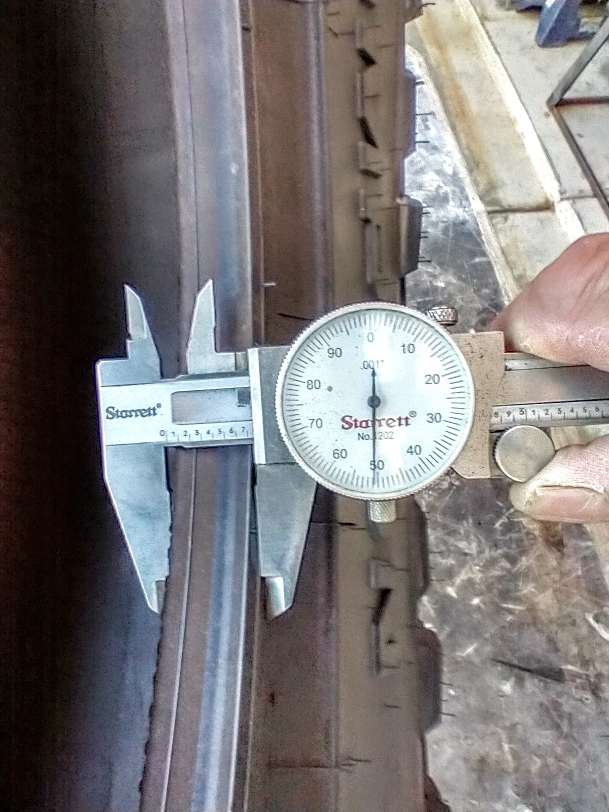

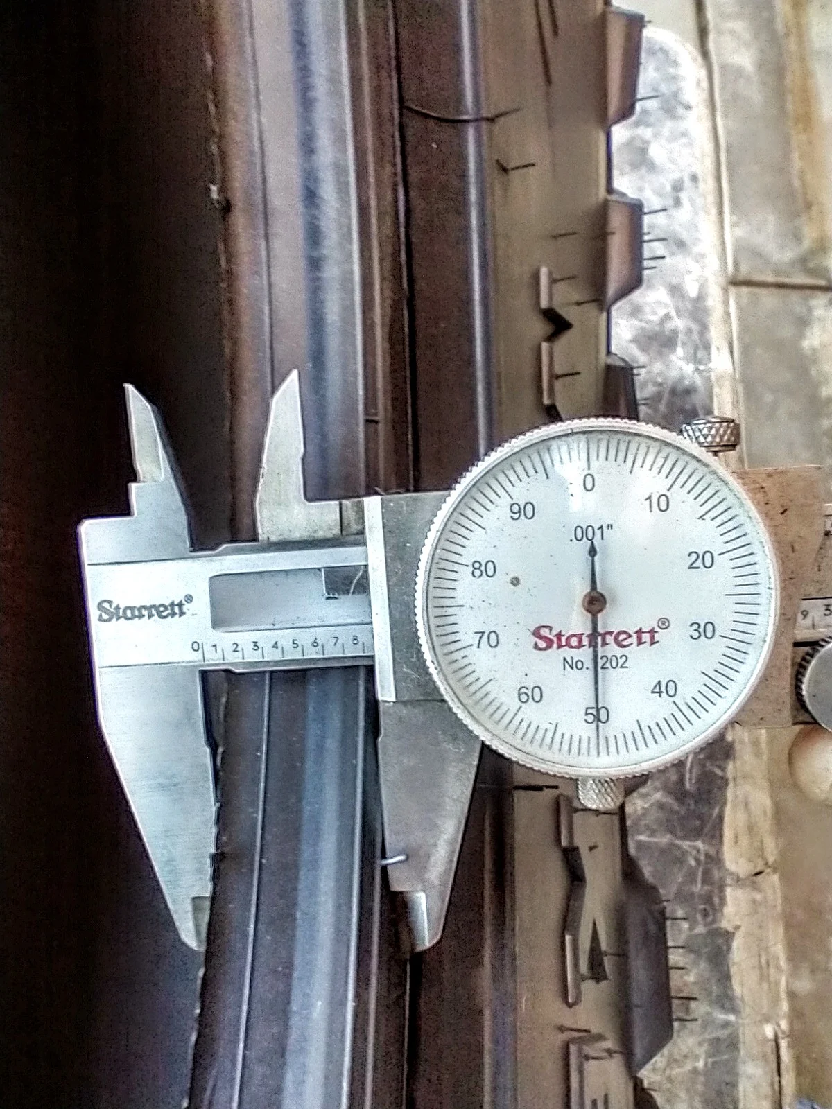

The inside bead measures at .750"
The outside bead measures at .850"

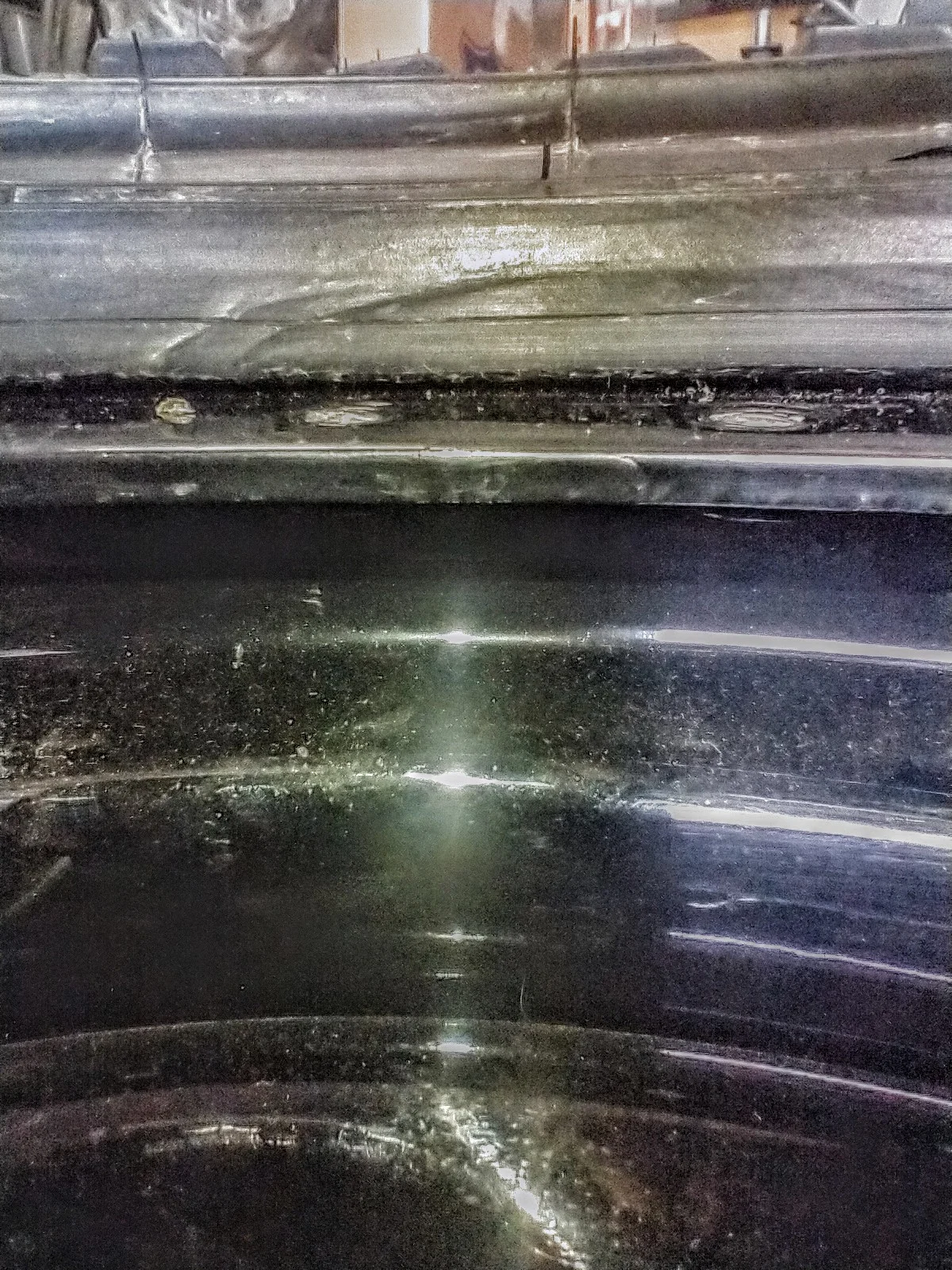

I had to run 3/8" of spacers on my Raceline RT81 beadlocks to keep the rings from coning in.
At this time Raceline only sells 1/8" spacers. I bought some ABS plastic and made my own.
I used the 1/4" thick spacers I made and the original 1/8" ones I bought with the wheels.
Raceline said to make sure the bolts are long enough and you can see they are.
When I measured the gap after torquing the bolts it was .343 so the ring is coning in.032". Not enough room for another spacer.
