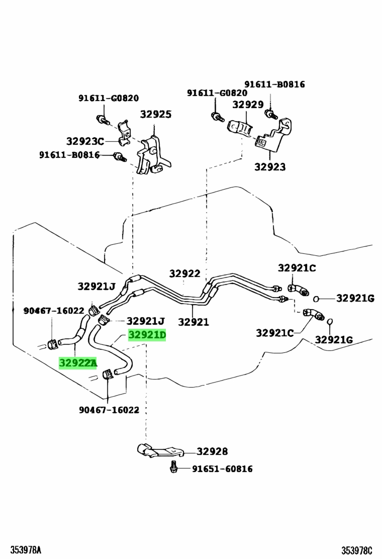

I'm in one of those 'while you're in there' situations... I've got the truck apart for a 180k extended timing belt job. Was going to replace the trans cooler hoses as a PM, but one of them is discontinued. It's the 32941-60190 hose (the 32921D in the image below). In reality, this isn't a pre-bent hose but a long flexible section that could be replaced by just a cut length of hose.
From what I've read this hose has a metric ID. Has anyone sourced a hose that is transmission fluid compatible that is of high (OEM-like) quality?

If that doesnt work look for Cohline bulk hose. Belmetric carries it. I use it on my old german cars.

Any luck finding a suitable replacement for this hose? I thought I had found it but apparently I ordered the hardline that connect this hose to the transmission.
Try 32941-60280.
