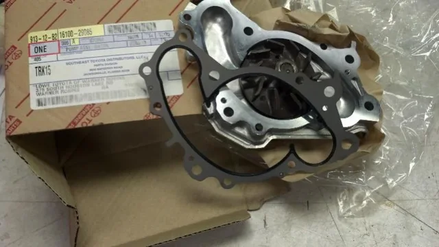

I don't know how much this will help, but the water pump that I'm installing this weekend in the 3MZ in my car also came with a metal gasket:
The FSM doesn't say anything about sealants or FIPG, and the torque spec is 71 INCH-lbs (not FT-lbs).
