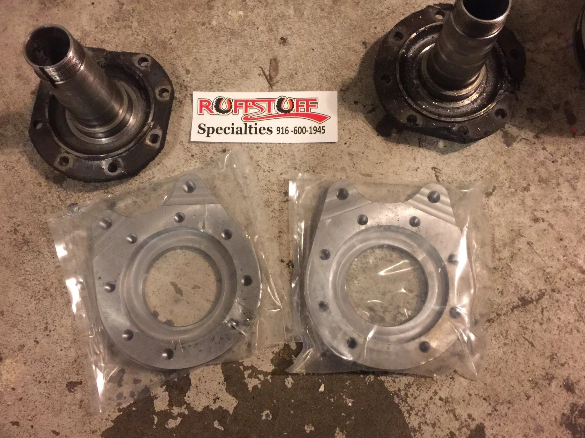

My Christmas present came today!
Guess what I’m up to!

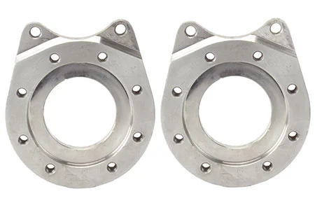

Building a FF rear axle....Stump did one in the hardcore section, one of our members who now lives on the other coastish...how much extra width to you gain from those adapters?
To use them you cut off the semi float flange and weld them to the housing. Then you are able to use front replaceable spindles on the rear. These use landcruiser front calipers. It looks like I could gain about two to three inches without adding any tube. But I plan to keep it stock width by cutting the axle tube down to use stock full float axles. I prefer to have less custom parts.

Yeah there’s are a couple different options out there these Axle Flanges, Rear, Toyota, Full Float are for Toyota calipers but other company’s make some for gm calipers so you get a parking brake.

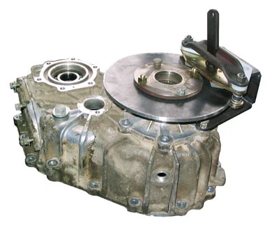

I have a disc drive shaft brake for my parking brake. Works dam good unless you bend it on a rock, but It dosent hang below my skid plate so I haven’t yet...

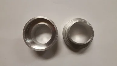

Axle seals need a insert I haven’t tried these out but they mount in the spindle in place of the bronze bushing. Full Float Seal Holder

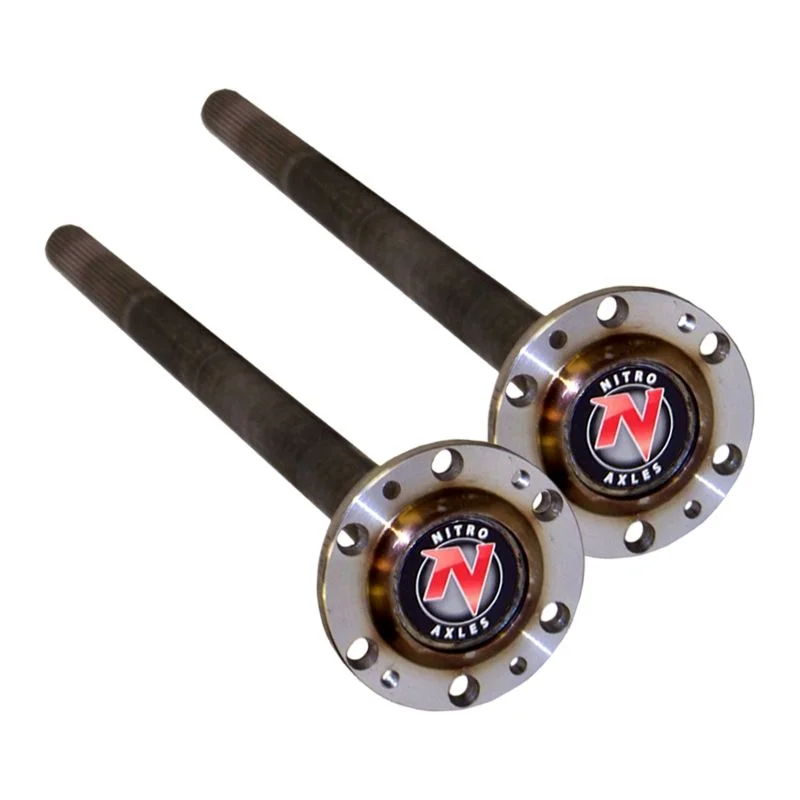

I got my full float axle shafts from here Toyota Land Cruiser Chromoly 30 Spline Axle Shafts, 40, 55, 70 Series Full Float, Pair (AX TFF-FJ40) they are made by nitro gear and custom lengths are available. And are cut with longer splines for fit stock Toyota lockers.
