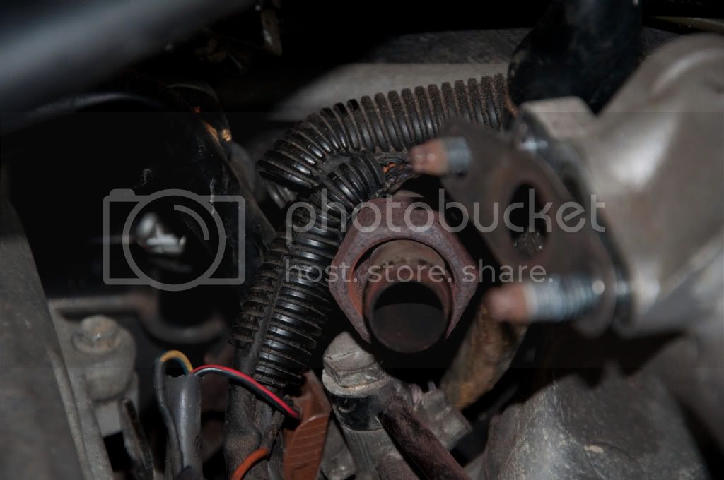

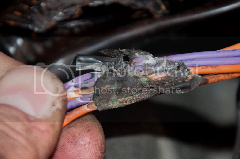

I had a similar issue a while back. A few of my injector wires were meltes together and the copper strands were exposed. Turned out that when the copper strands vibrated against the EGR pipe they would short circuit to ground which would make the affected injectors open which in turn flooded the cylinder with fuel and hence the misfiring at low revs. This was confirmed when I pulled the spark plug on cylinder no.3 and it was covered in soot.
This is what my harness looked like:
I ended up cutting out the damages setions and soldering in new peices of wire, put heatshrink around it and then wrapped the harness in heat resistant tape. No more issues to date so I say just cut out any damaged sections. It was a pretty straight forward fix once I figure out what the issue was.
I can't tell where are those toasted wires in your picture. I hope mine is not like that.:hhmm:

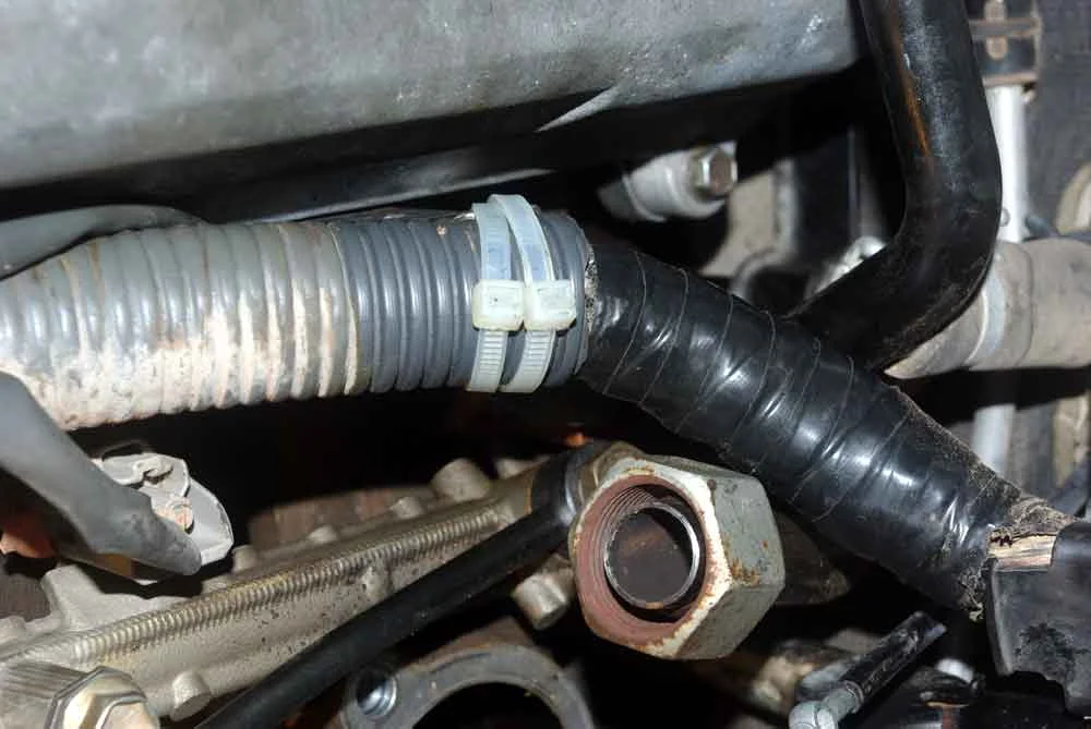

Does anyone have a diy or step by step instructions with pics to ensure the harness doesn’t melt against the Egr? Many thanks.
There’s not much to it. Buy heat wrap, wrap harness as shown in pics, zip tie said harness so it’s not touching the egr pipe. Is there something in particular you’re unclear on?
I understand there’s a method to tie it to the original plastic bracket? I want someone who likes things neat and tidy to show me their work. Pics would be nice.
Here's a link to the stuff that I used: Cool Tape
Costs about $15-$20 at the local O'Reilly's or Autozone. The worst part is going to be getting the EGR off but not as hard as getting it back on! I would inspect the wires and do any necessary repairs as indicated. Wrap the bundle with two full wraps or more. Mine threw a 306 but all my wires were in tact and no problems since first wrap and second wrap while doing my HG. Technically - if you remove the TB to do this - you'll need that gasket too per FSM. $5-$8 (your mileage may vary).
