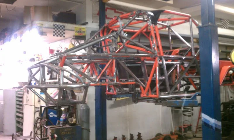

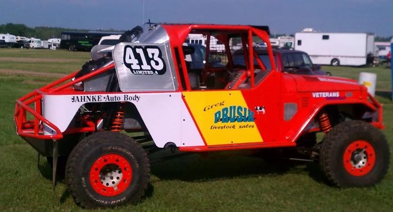

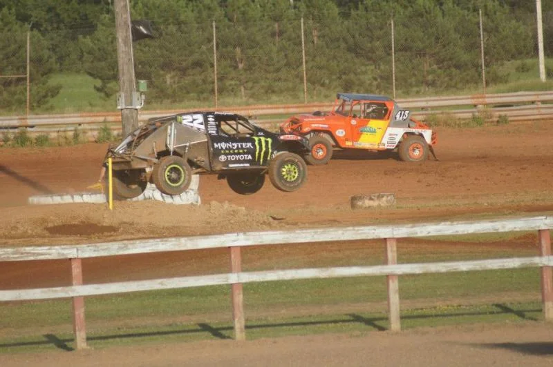

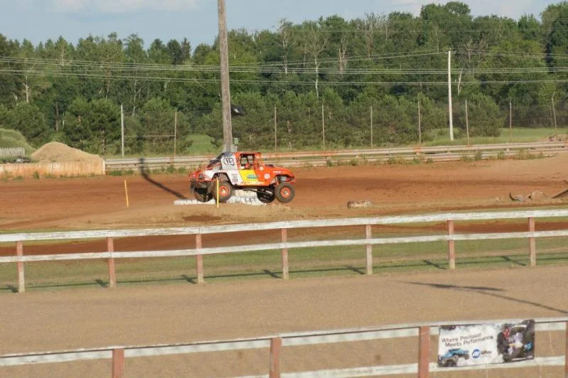

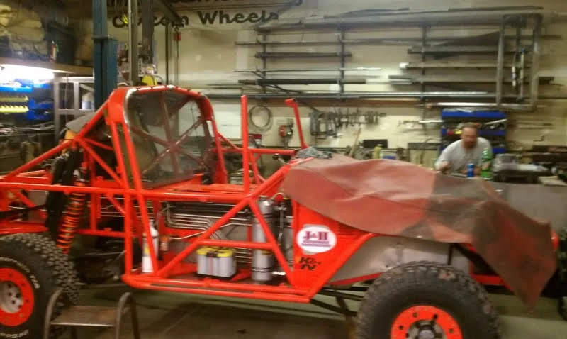

This has been a blast to build. Jimmy Ridderbush is the fabricator, the rest of the team each has a job. We just returned from our second race weekend and are going through typical new truck gremlins. Anybody want to follow the evolution? In the next three weekends the team will remove the w/s bars, roof and part of the rear cage to change/update the look and repair a little three flip oops done in Antigo, WI.

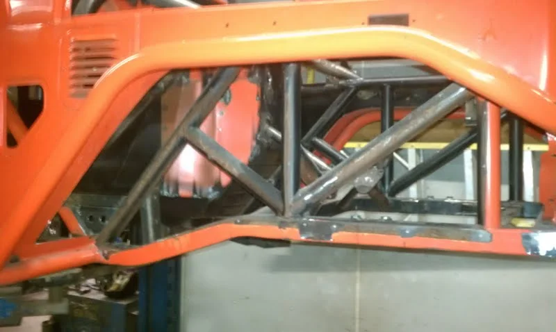

Some build up pics

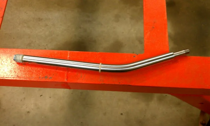

Work is in progress. First pic is a King Kong shaft from a front control shock. I can't find my pictures of the broken SAW coil carrier shafts. Coil carriers are back together and will be fine. One control is good to go, other needs shaft yet, waiting on parts. Jim has two jobs in the shop this week also. Cage will only take one long day to put back together.
