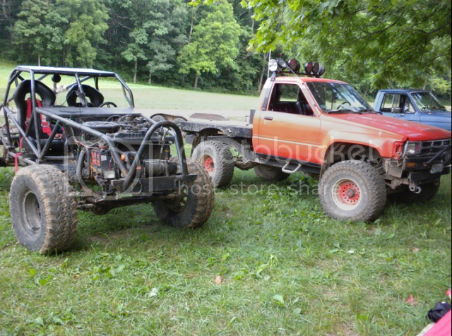

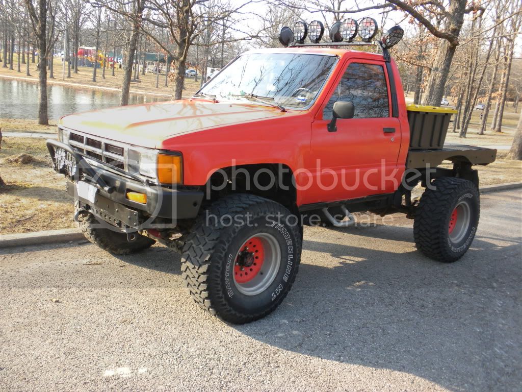

This is my project, Orange Crush, a 1986 22R Pickup that is slowly being transformed into a Truggy on a very, very slim budget (so be nice.) I'll start from the beginning and eventually catch up to my current status on the project....

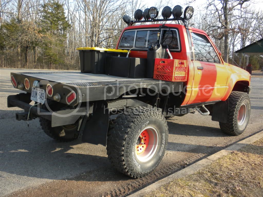

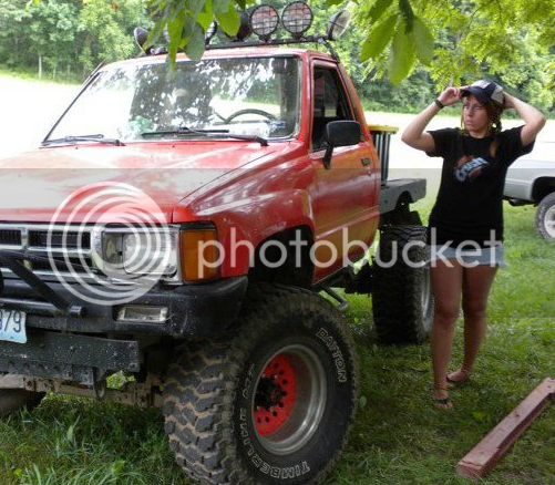

I drove the truck around for a while like that, but a full summers worth of trips to the local offroad park and I was hooked. All of that wheeling in stock form took its toll though and a nasty little secret was revealed... rust, rust, rust. So build-time began...

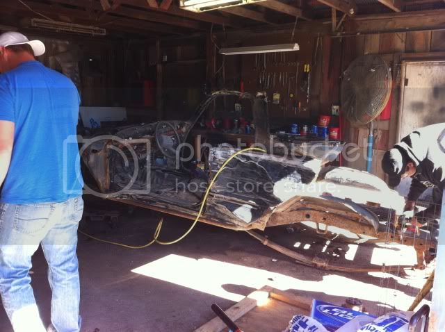

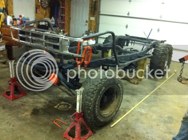

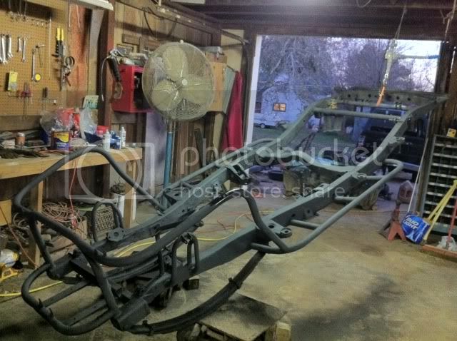

I sourced a good frame from a retired buggy that was sitting dead in a field, grabbed some buddies and got to work...
So here is what I had to work with before and after... Two days worth of cutting grinding and sanding. (10 points if you can tell what that thing used to be!)
Aaaaand after....
I HATED the huge body lift my truck had, HATED the IFS, HATED that at any moment it could rust in half and of course HATED how little money I had to spend. However seeing as the donor rig was SAS'd, had DOM rocksliders and front fender hoops, was set up for 63" Chevy's (which are a dime a dozen where I live) AND had a winch mount, I felt like I had come out pretty far ahead...

Ahh 10 Points for 2ndGen! If that thing was a Trekker I would have just cried given the point-of-no-return condition the body was in. The donor was a 1988 4Runner formerly known as "The Raisin" from Flatnasty ORP.

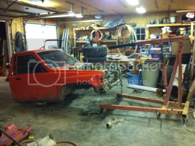

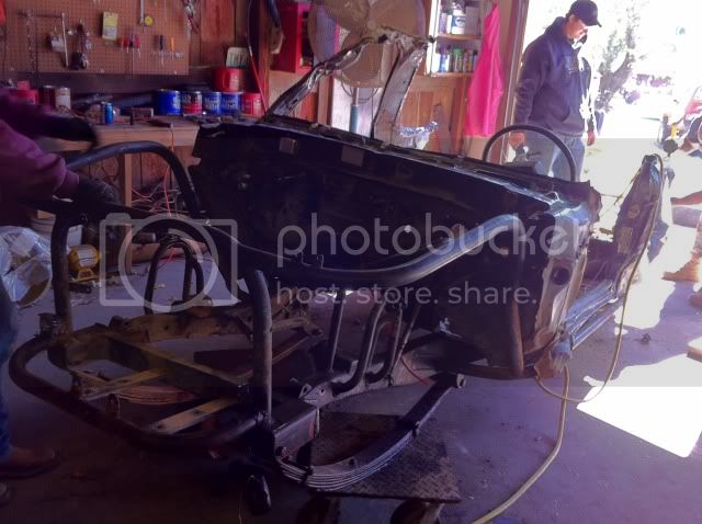

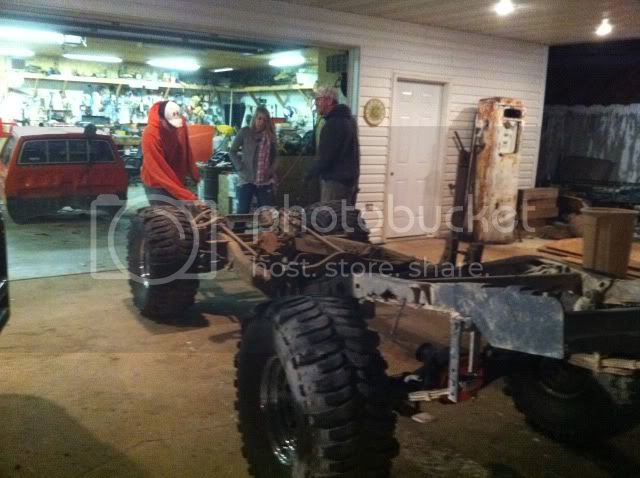

With the motor pulled I enlisted the help of my girlfriend and a buddy and we peeled the cab off of the IFS truck with a cherry picker and a lot of hopes, dreams and busted knuckles.
Check out how broken and tweaked that rusted out IFS frame was by the end... You may also notice that I traded my 31x10.50 Timberline MT's for a set of 35x14.5" TSL Swampers. (Low tread, no side bite, yadda yadda... remember my budget)

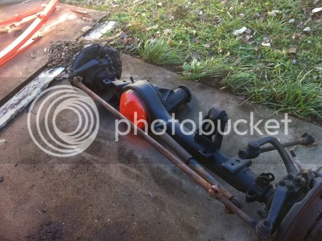

After scouring the countryside, I finally found someone who was willing to part with a late model solid front axle in decent condition... that was also in my meager price range. My first outright purchase for the truck. Here they are mocked up to get some measurements...

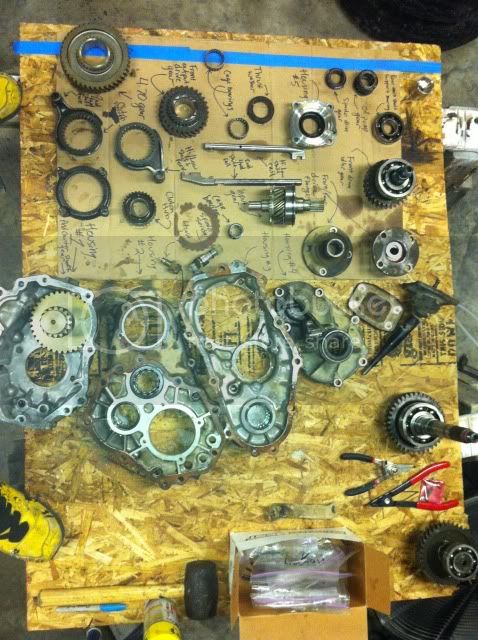

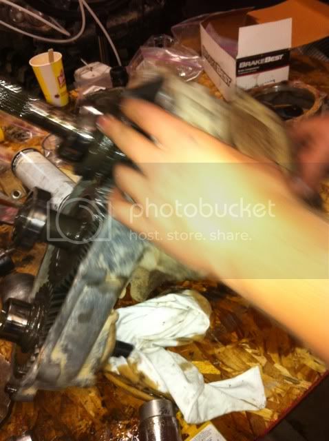

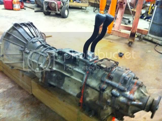

So at the time TG 4.7's were on sale so I bought a set, along with a spool for my rear end. My girlfriend threw down on a ratchet locker (I know... they suck too) and twin sticks and I started researching how to do the transfer case gear install.
I got to work as soon as the gears arrived...
I had no experience so I went super-slow and took no chances. I was pretty pleased with the final product...

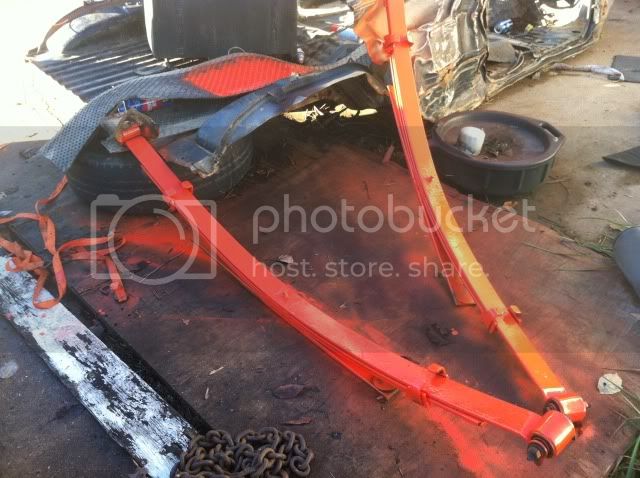

I found yet another field truck... this time a 93 2wd Chevy Silverado with 3-leaf, 63" Chevy's... $20 if I wrenched them off. Bingo
(The only thing that the PO wanted off of that buggy frame was his Chevy's)
I also found someone willing to part with a very crusty late model solid front axle as I mentioned earlier. Cleaned it up and it turned out pretty decent. Very little play in the axle, complete from hub-to-hub.
