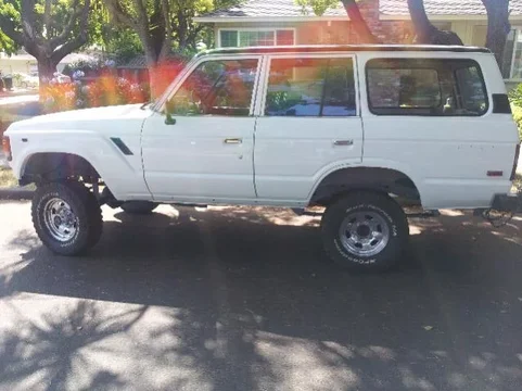

So thank you to those that have kept tabs on my slow build.

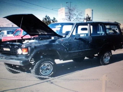

When I first bought her:
At the body shop
after paint and when she first arrived at my house yesterday:
After proper tires and wheels were installed:
My daughter named her Ella. Still have lots of work to do, but the paint and body work are glass smooth and amazing! Plenty still to come so I guess this is the start of my first official build thread. Hope you guys enjoy!

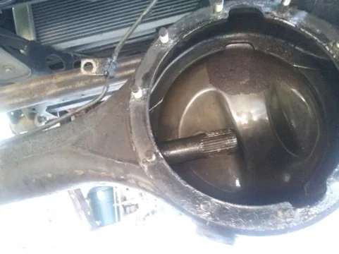

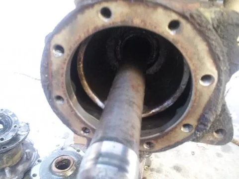

Been doing a little work on Ella. Took the front apart to put in a new third member with a 4.10 ratio. Also rebuilding the knuckles and putting new seals in. so much water in the axle! Looked like chocolate milk. Ring gear still turns but is rusted from sitting in the water.

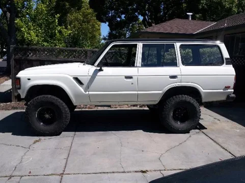

Thanks Danny! Yea the black roof was a last minute adjustment since we didn't have enough paint. I decided to paint the top and the front A pillar black, but painted the rain gutters white. I think it came out really well. The tires are Cooper STT 35x12r15 on black 15x8 steelies. I Def like the way she sits. Not to tall and everything seems proportional.

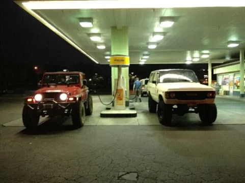

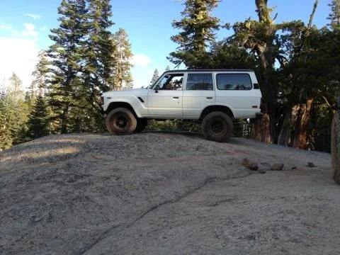

Finally got Ella out on the trail. Took my club out to *undisclosed secret trail* in northern cali. Man we had such a good time! The weather was perfect and the campgrounds were pretty much empty. We had most of the trail to ourselves.
Heading out
Scenery was fantastic

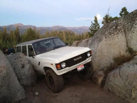

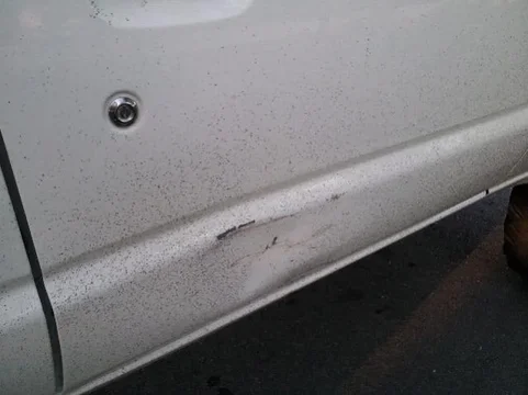

This ended in....
This! So much for new paint!
