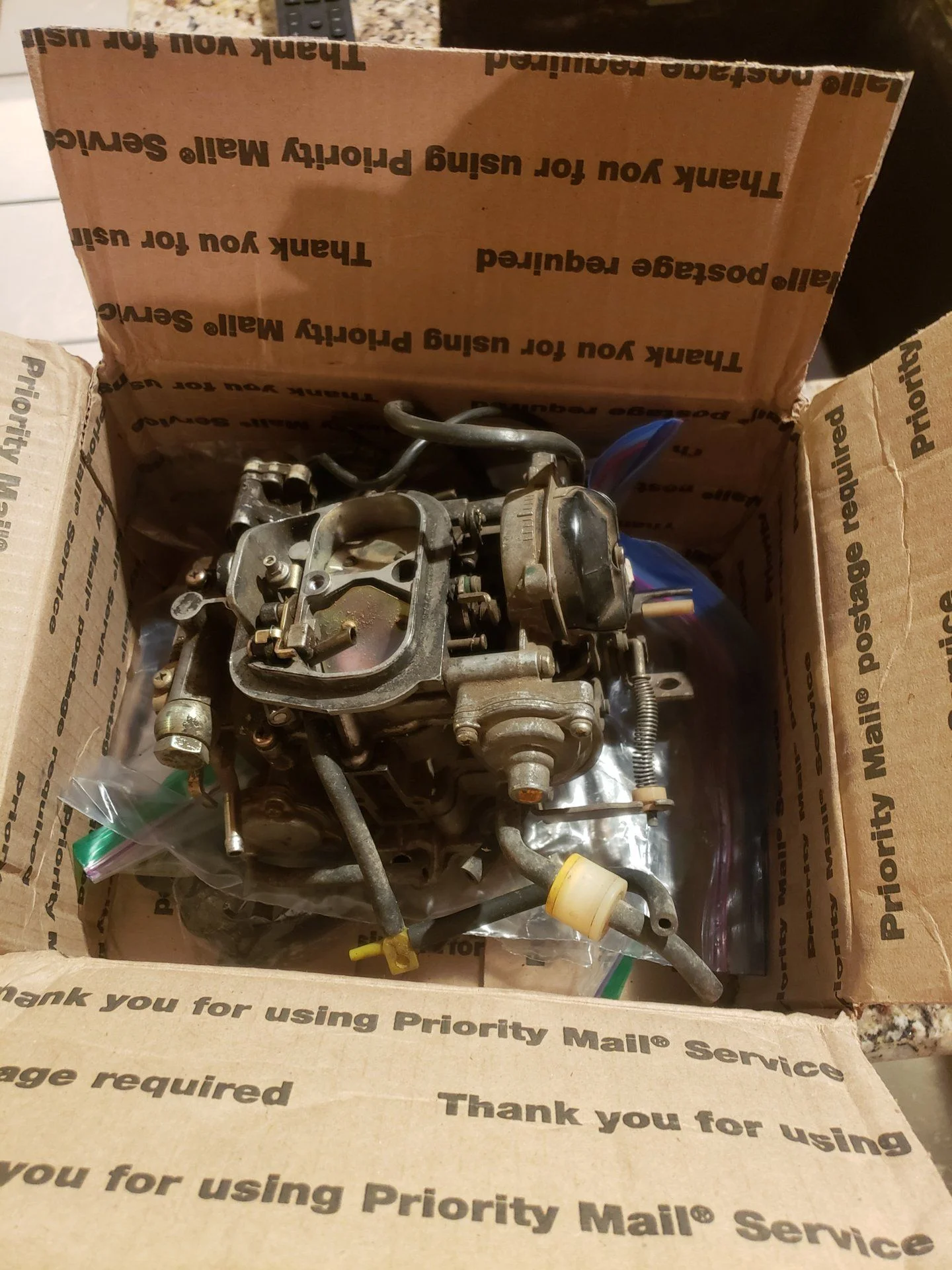

A guy from the Seattle club had a leftover OEM carb from an old truck of his he sent me recently. Thanks @Bullzi

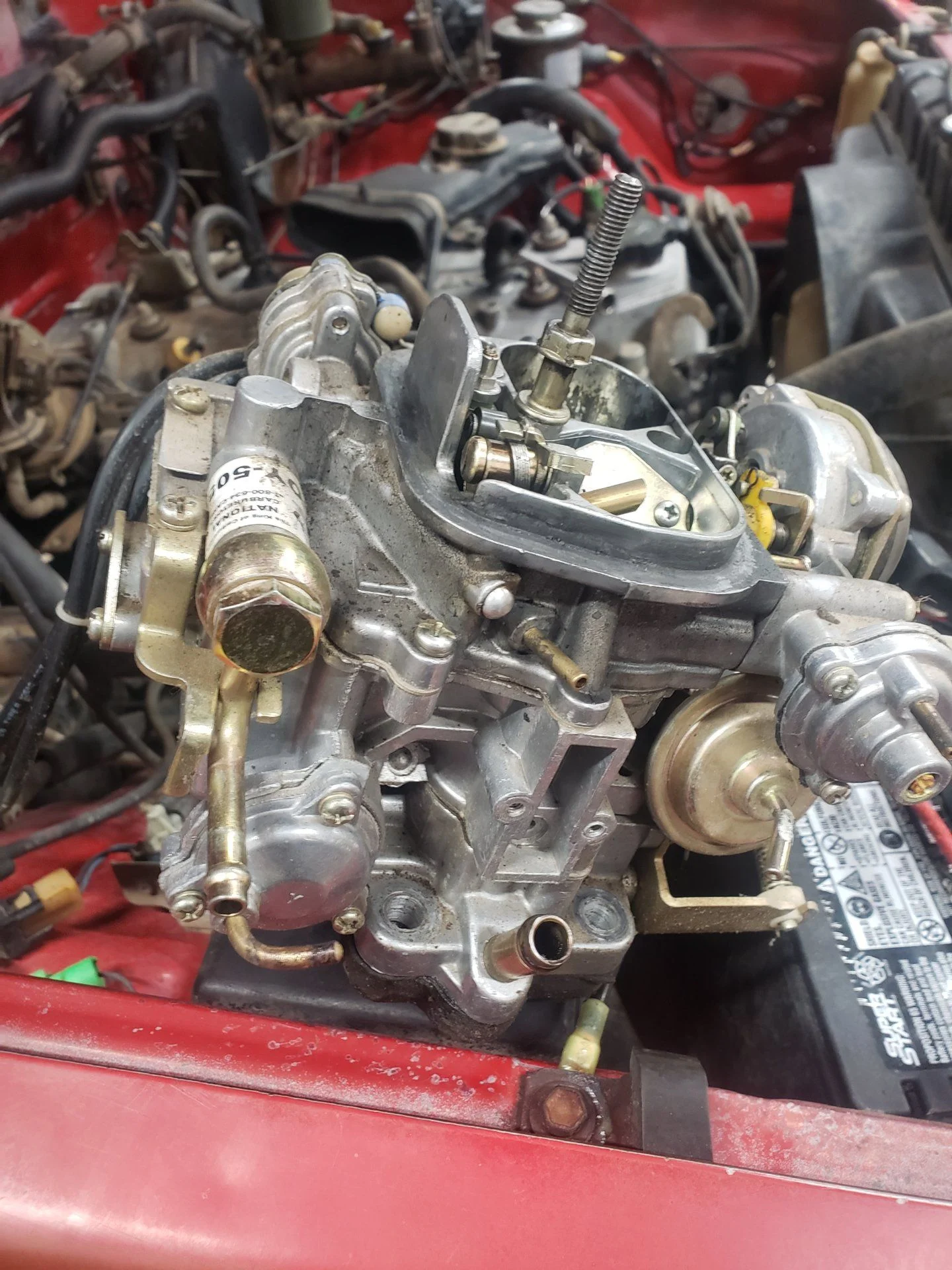

I slapped it on tonight. Way smoother and not missing all over! Haven't driven it yet but we are making progress.
The "old" one was a shiny new Chinese copy. One of the $69 eBay specials no doubt. The old OEM carb that's been sitting since 2003? runs better. Par for the course.
