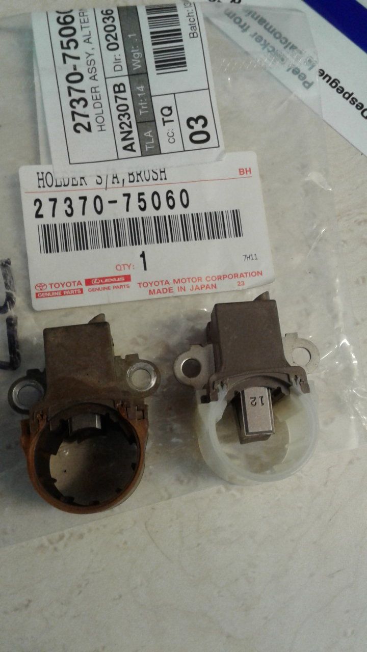

You could first try replacing the brushes for $15 and see if it fixes your issue.

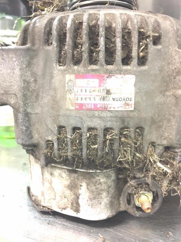

Yes, never really understood the reasoning behind the placement of the alternator. It is mounted extremely low on the engine making it susceptible to water, trail debris, dirt, dust, oil soak from engine leaks, etc....
And then put the damn starter under the intake manifold.
^ That looks exactly how one of my alternators looked 🙄. I'm on my 4th alternator...Pez Dispenser. Anyone under about 55 YO won't get that one...🤔😁

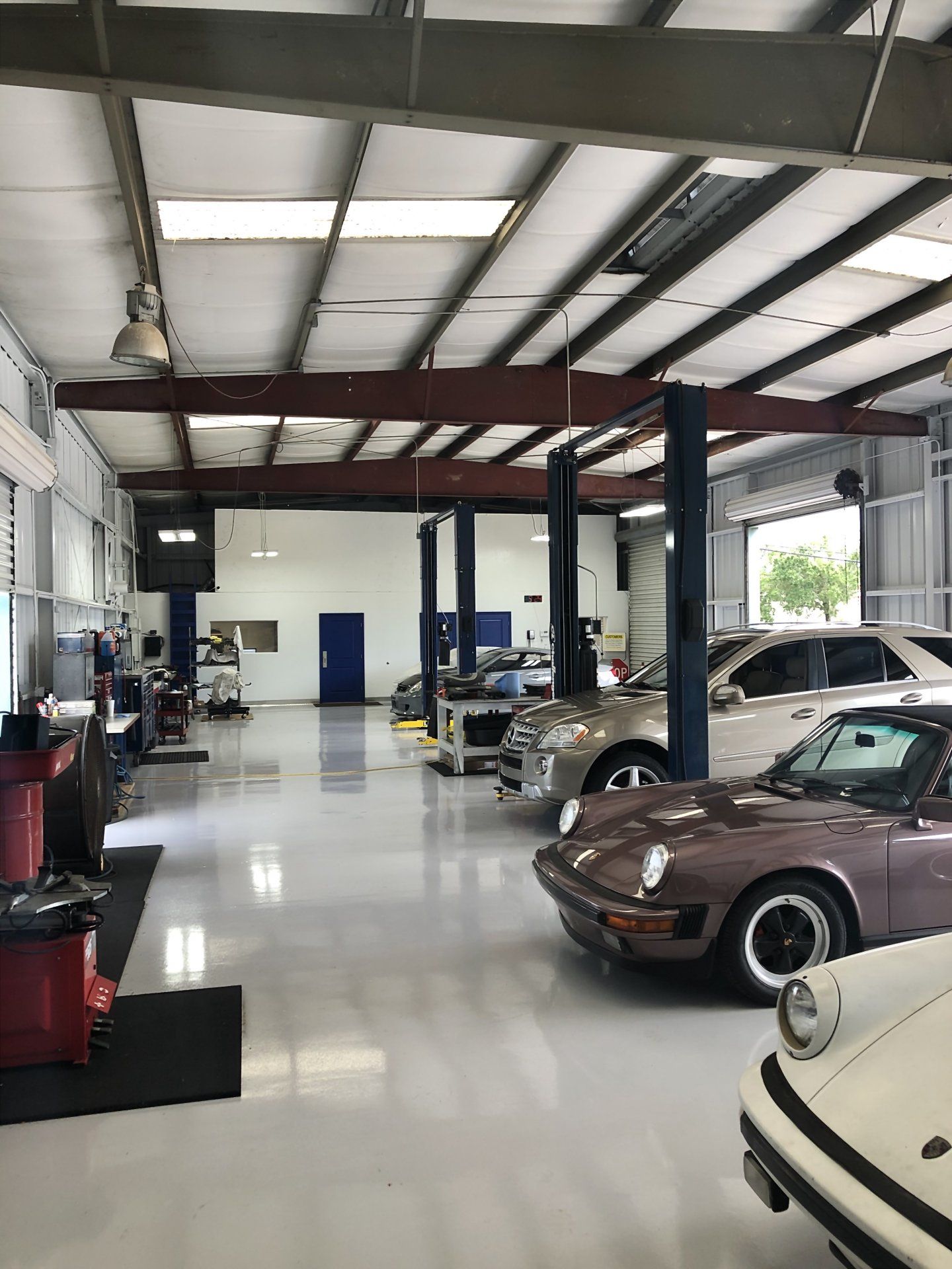

here’s my work space
