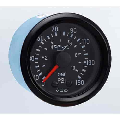

In the Vdo cockpit international series og gauges I can get a mechanical gauge that reads up to 150 psi or an electric gage (and sender) that reads up to 80.
Anyone ever had a mechanical gauge's plumbing blow out?
I really like the look of the VDO gauges. Just not sure which one to get.
I use Autometer gauges but we are talking apples and apples, I use electric gauges. Even the speedo is electric. I would not be comfortable with a live oil line in the cockpit at this point, had them when younger.
I run mechanical oil and temp autometers in both trucks and never had a blowout but I've had a leaking oil tube that the olive didn't seal properly, another one I damaged and broke a oil tube in the engine bay and I've broken a temp gauge capillary tube

For my other gauges (oil pressure, water temperature, boost) I just used ~$20 Bosch gauges from Amazon. I went with a mechanical oil pressure gauge, which works fine, but I would probably go with an electric one next time so as not to have an oil line in the dash where it could get pinched, punctured, or worn.
I am probably going to go with the mechanical gauge. I'll use braided steel line or steel brake line for the plumbing connection.
