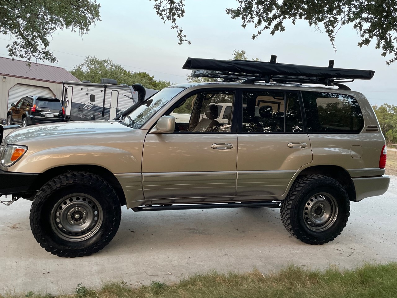

Here is my 99 with an IronMan FCP lift kit, Tundra Steelies, Toyo MT 295/70/18 tires, and Bora 1.25 inch spacers.

I could never go back to a smaller tire if that's what you're asking. I would like to get some lighter weight wheels though. The steelies are about 30 lbs a piece or so and with MT's the total weight is around 100 at each wheel. I have no issues with this size and yes, a lift does make it possible to run taller tires. Without it, there is no way these would fit without busting out the sawzall.

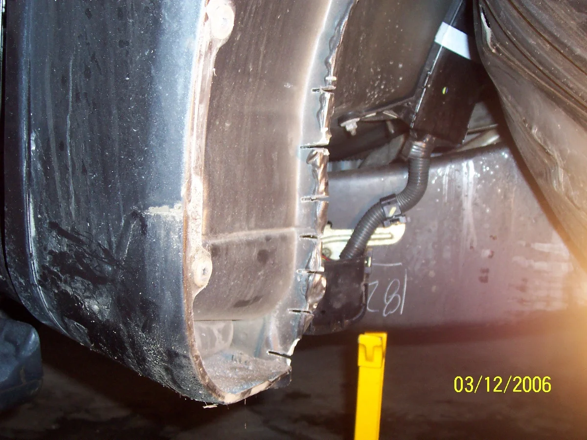

One last question, did you have to beat your pinch welds and such?
I cut horizontal slits in the pinch weld with a pneumatic cut-off wheel about every 1/2 inch or so and then folded them over with a hammer. Not my pic but an example of what I did.
