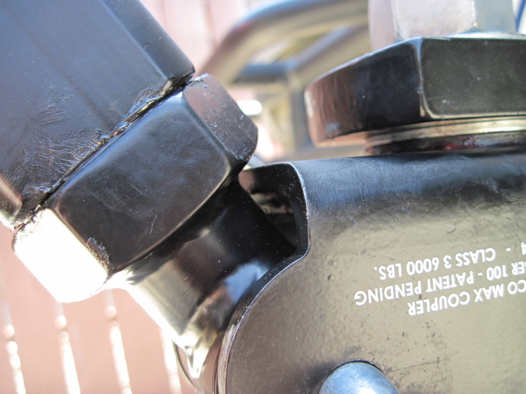

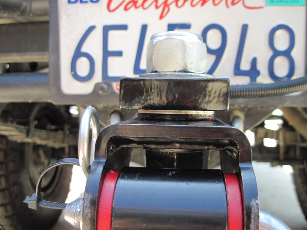

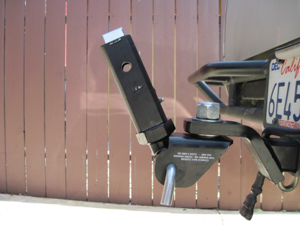

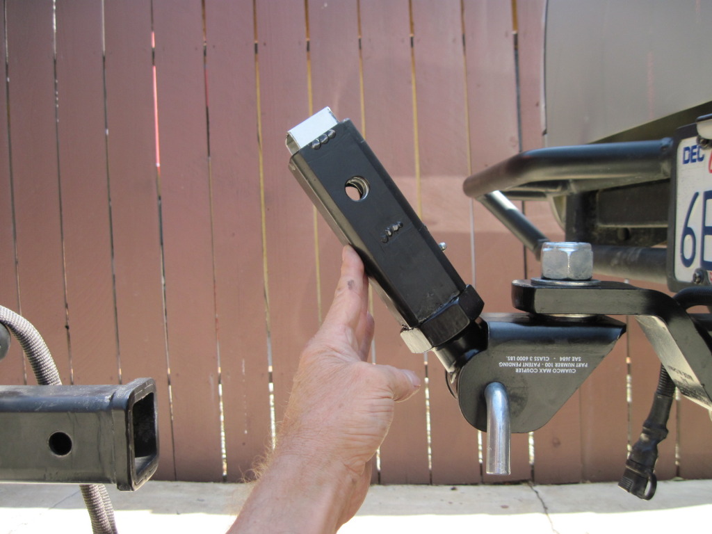

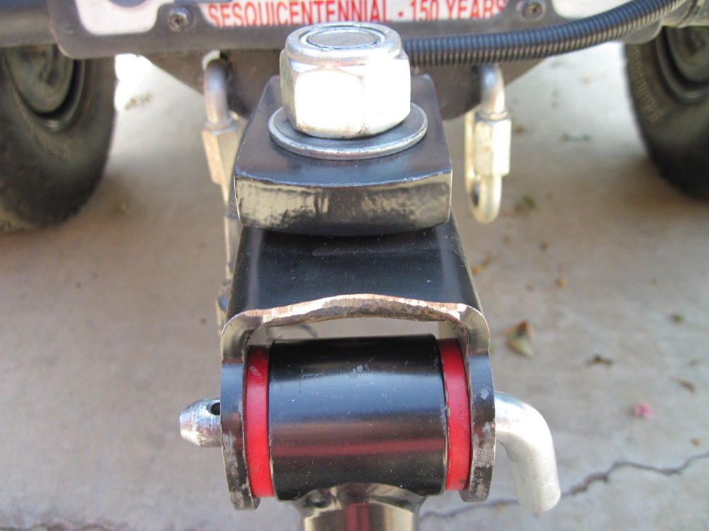

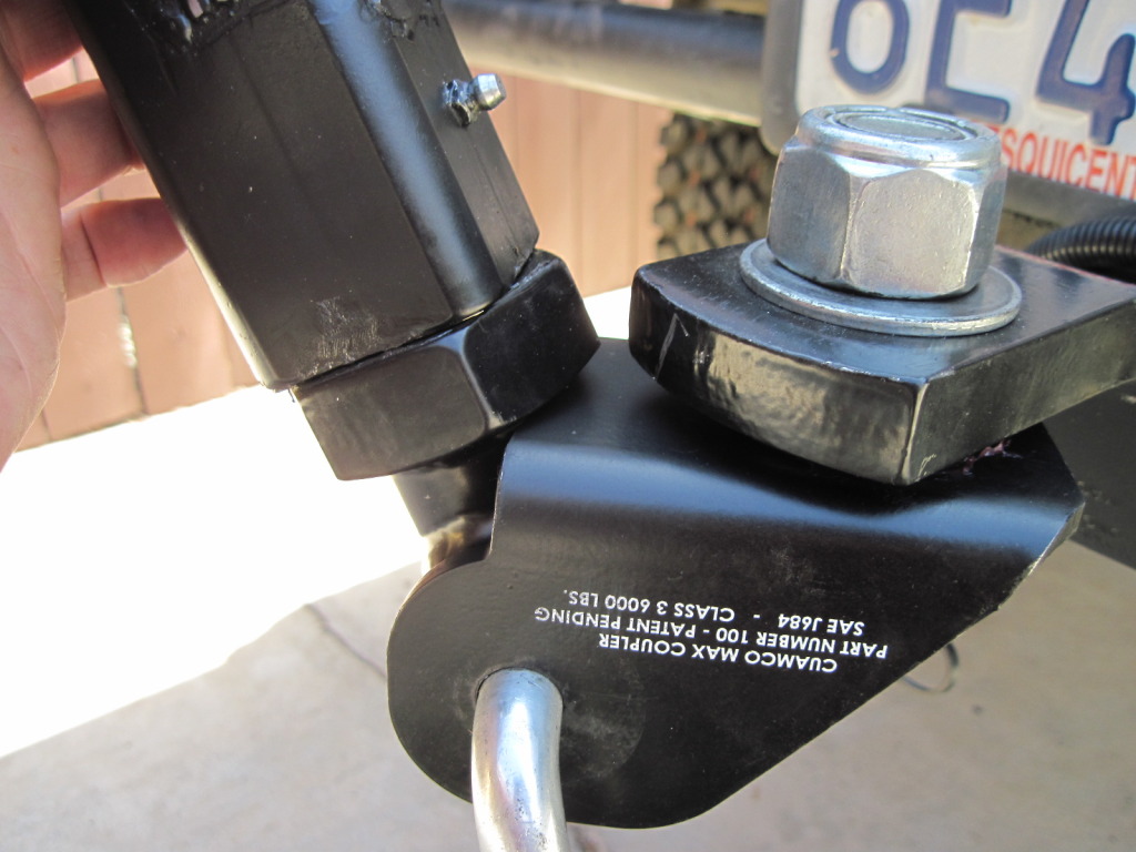

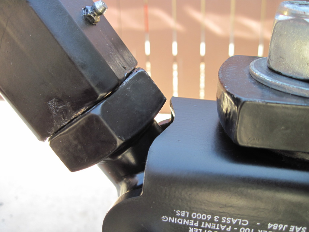

Why don't you build/buy a receiver at the height you want and run the coupler in the standard upright position?
Are you referring to a double lock nut ? W locktite ?Lock tight they make it in different strengths some industry use only this no lock washer or lock nut ie. Airplanes. Decide how easy you want to be able to remove it later and use the appropriate lock tite with a lock nut a top lock nut will give you a couple more threads than a nylock if you want to keep your bolt you have now.
I've considered that...Why don't you build/buy a receiver at the height you want and run the coupler in the standard upright position?
But I will have to modify my bumper to do that.
and I've already modified/reinforced the bumper to be strong enough to tow.
Cutting all the bumper's reinforcement stuff off...
will be a pita for sure... and buying a new bumper for a fresh start is somewhat costly.
But running the receiver thru the license plate area...
may be what I need do for a better solution and still maintain use of the coupler in the upright position.
But I wanted to try an alternative before I have to tackle things in that way.
I often kick myself in the butt... for moving up to larger diameter tires on the hauler.
All was good... before I did that
appreciate your input
Dell said:Are you referring to a double lock nut ? W locktite ?
I meant the ball mount part only. Not the actual bumper/receiver. I cut and welded a new Pintle mount after lift/tires to keep my m101a level. Should not be hard with your combo to make the max coupler level too in its upright position.
You can buy almost anything here : Fixed Ball Mount Ball Mounts | etrailer.com
I only have one pair of slidersFunny how you just seem to end up with a selection of sliders, isn't it? Started out and didn't have any, now I have too many, and I didn't buy any of them except for the first one.
I just got done driving down the hwy and rolling thru a trail...With the full height Nylock why not buy another Nylock (they're only good for about 5 assembly/disassemblies before the nylon has taken a set that doesn't do much locking) and re-assemble it upside down with some Loctite (strength of your choice as any of them will be fine)? Call that good and go camping!

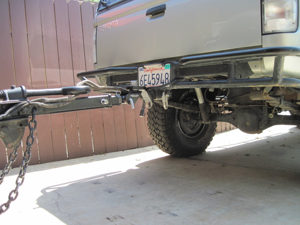

no... there is no lower mounting location for a lunetteDell - would you mind posting some additional photos of the extended tongue you have installed on your trailer? I am looking to do something different to accommodate a Max Coupler without hacking up my M416 trailer.
From what I can tell, it looks like you have installed the second tongue in the unused mounting position for the lower lunette. How was this configured? Off the shelf of fabricated?
Thanks.
