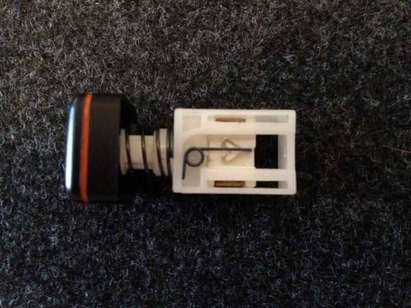

window lock out spring
window lock out spring...where does that little sucker go? I had my master switch apart and was putting it back together and accidentialy touched that window lock out button and of course it came apart. I just cant figure out how it goes.
Can anyone shed some light on this?
Took my master switch apart to clean contacts and inspect. The rear lockout button flew apart. Gave up on the spring too after working with it for 45 min.

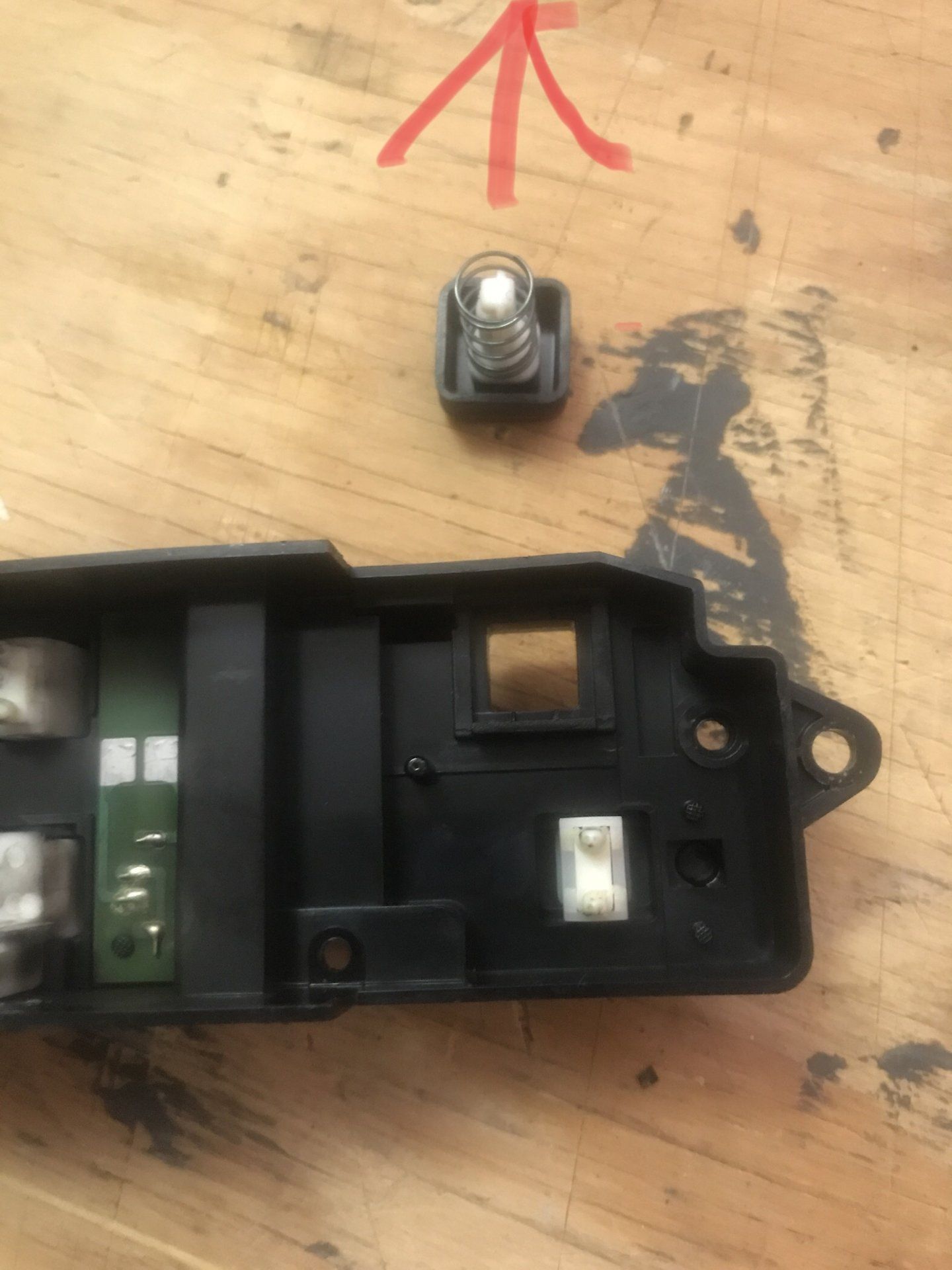

Thanks for the picture of the darn spring as well @rolliges - On another note, an issue I am having is that the auto up/down seems to jam up...it's hard to tell exactly, but it feels like it will have a little less play. I have to wiggle it a few times and it will eventually start working. I bought a master switch from a used LC and it did the same thing after a week or two.

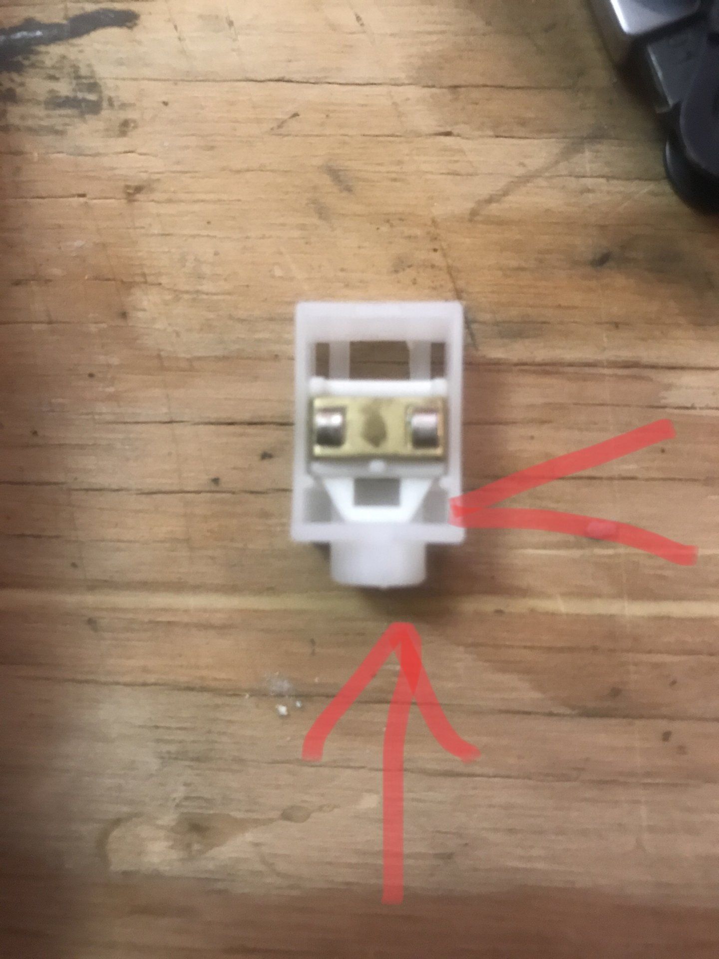

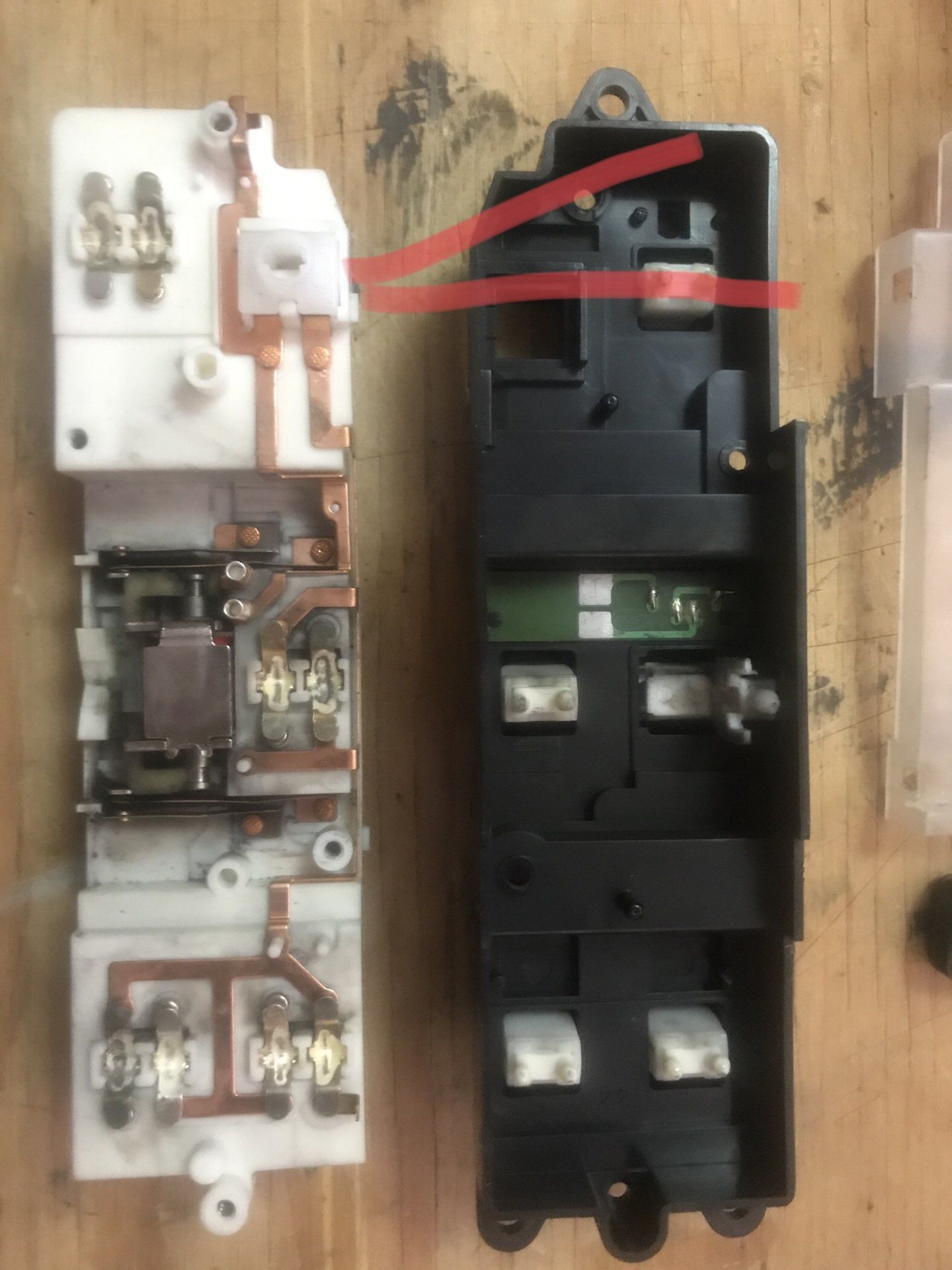

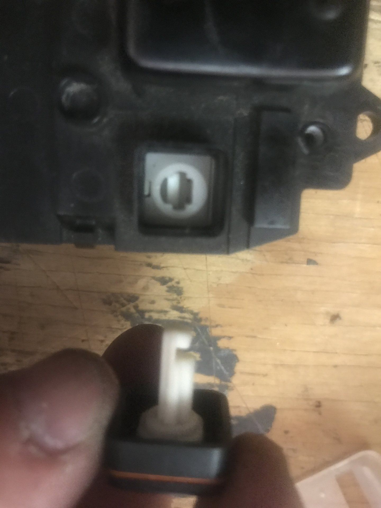

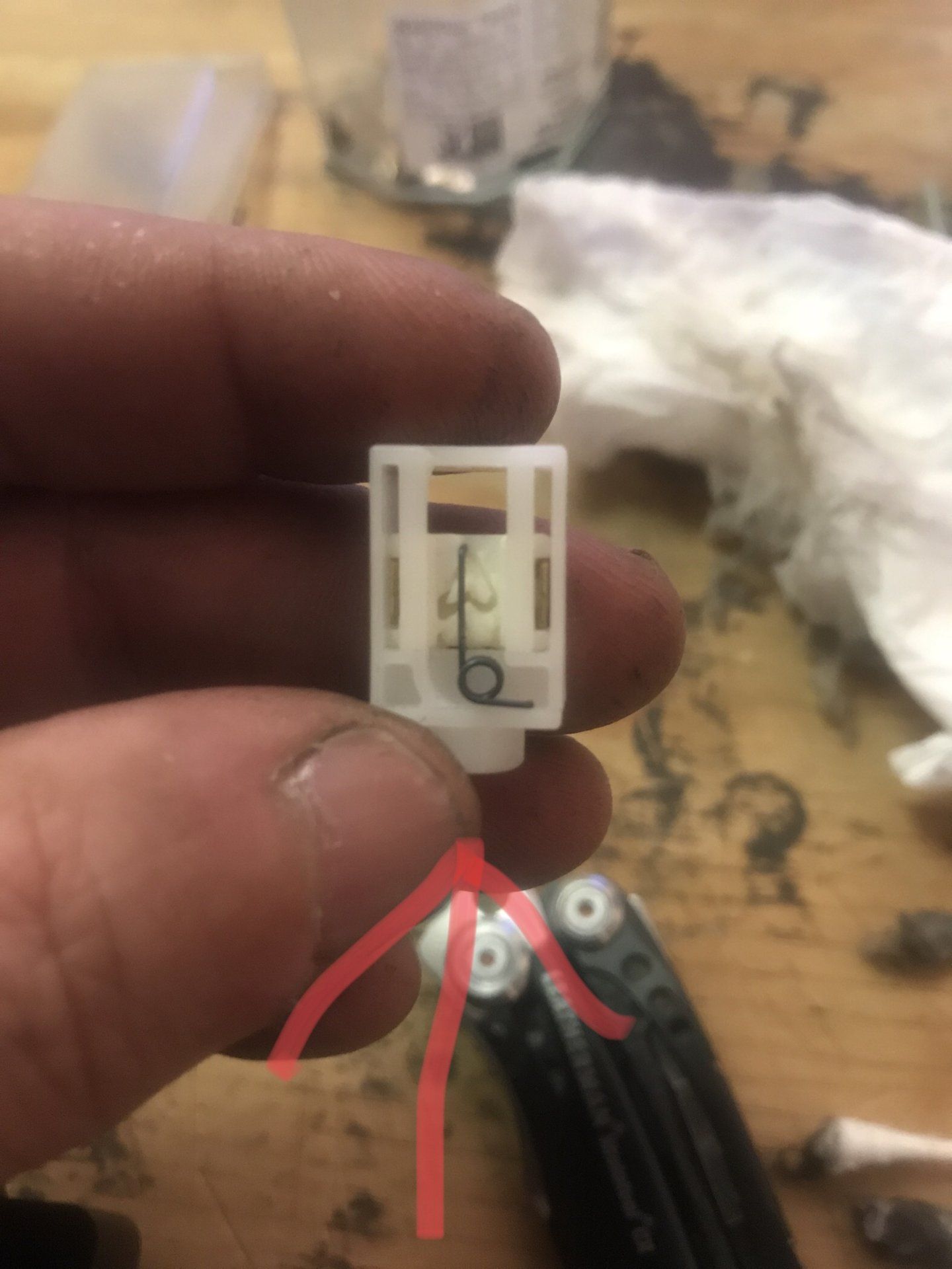

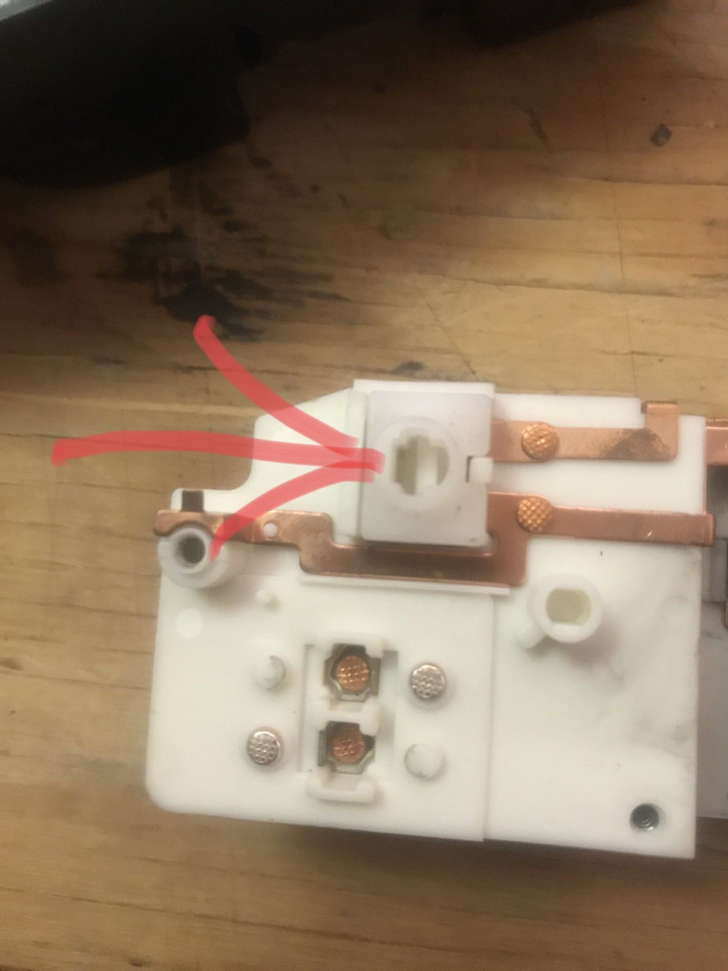

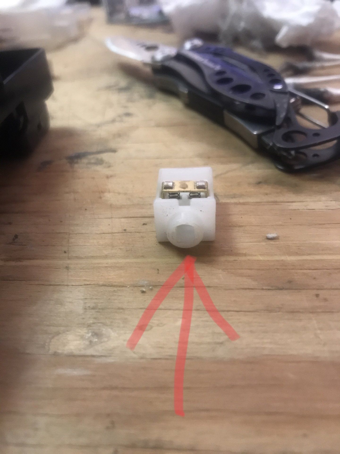

gents
does the “plunger” with the cap on it go over the spring and into the “sled” with the contacts on it AFTER the whole assembly is together?
i see a little slot at the bottom of the plunger and i can see how it seems like it should get slotted into the sled somehow but right now my top will sproing off since nothing is holding it down.
the plunger can only go on in one direction so it seems like this should be easy.
